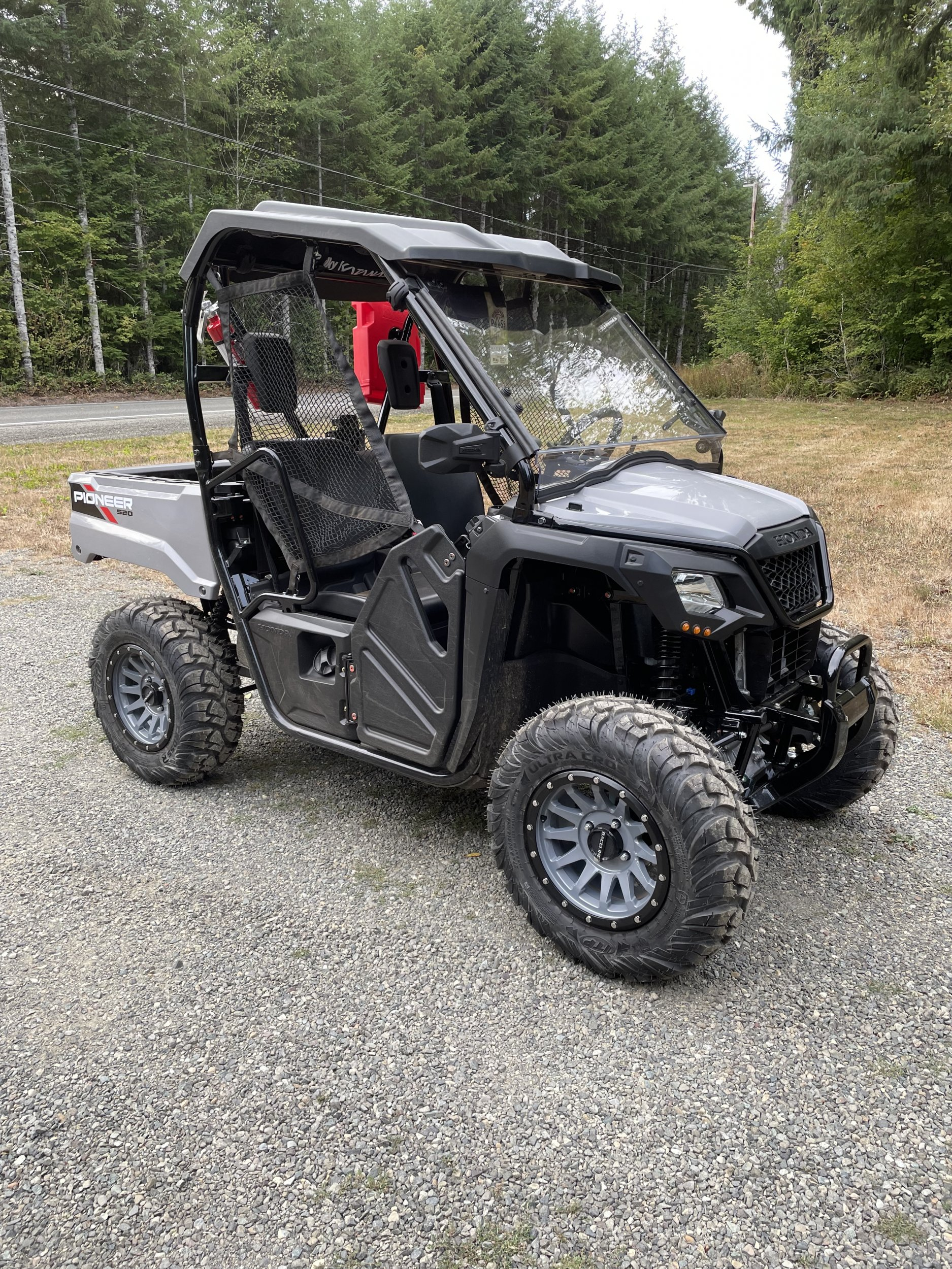

I have a Pioneer 520. It’s fantastic. I bought it for recreation purposes but, I use it way more on my property than I anticipated. It’s a great machine, I highly recommend it.
It fits through all the tight spaces in my heavily forested and hilly property. Stock ground clearance is good and if you wish more, larger tires and/or wheels are readily available. The traction is really good but the turning radius isn’t great though. The transmission shifts hard and aggressively but begins to smooth out after the first service. The ride can be a little rough with the small tires and factory shocks. However, if not not traveling quickly, you’ll hardly notice. The gearing is real low so the transmission is always busy at low speeds and the top speed is low too but, that doesn’t seem like it’ll matter to you. The low gearing and 4WD will definitely help with the snow plow attachment (I plan on getting one sometime in the future…it’ll sure beat the tractor in ability and comfort).
Since the 520 already has the tilt bed, I’d just recommend a roof (maybe a windshield) depending on you climate. However, regarding customization, the sky is the limit. Here’s mine in its current state;
Right now, I’m just waiting for my new shock absorbers.

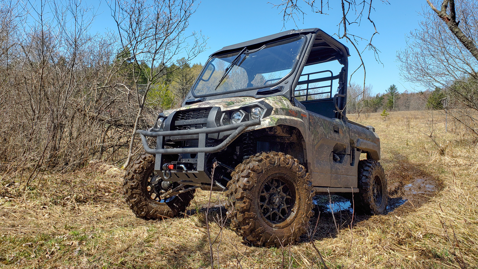

I have a Mule SX. Only Kawasaki has a three year warranty
I added a roof and windshield
If you intend to plow, adding a large deep cycle battery is a something to think about. I did that on a Ranger 850 I used for a while. SxS plows are iffy for serious snow. For tight spots I use an Ariens walk behind blower. And for light snows, a backpack blower.
Great work unit. Get the model with larger tires for added ground clearance. They are a bit loud. I will likely add an aftermarket silencer this year when the warranty expires.
