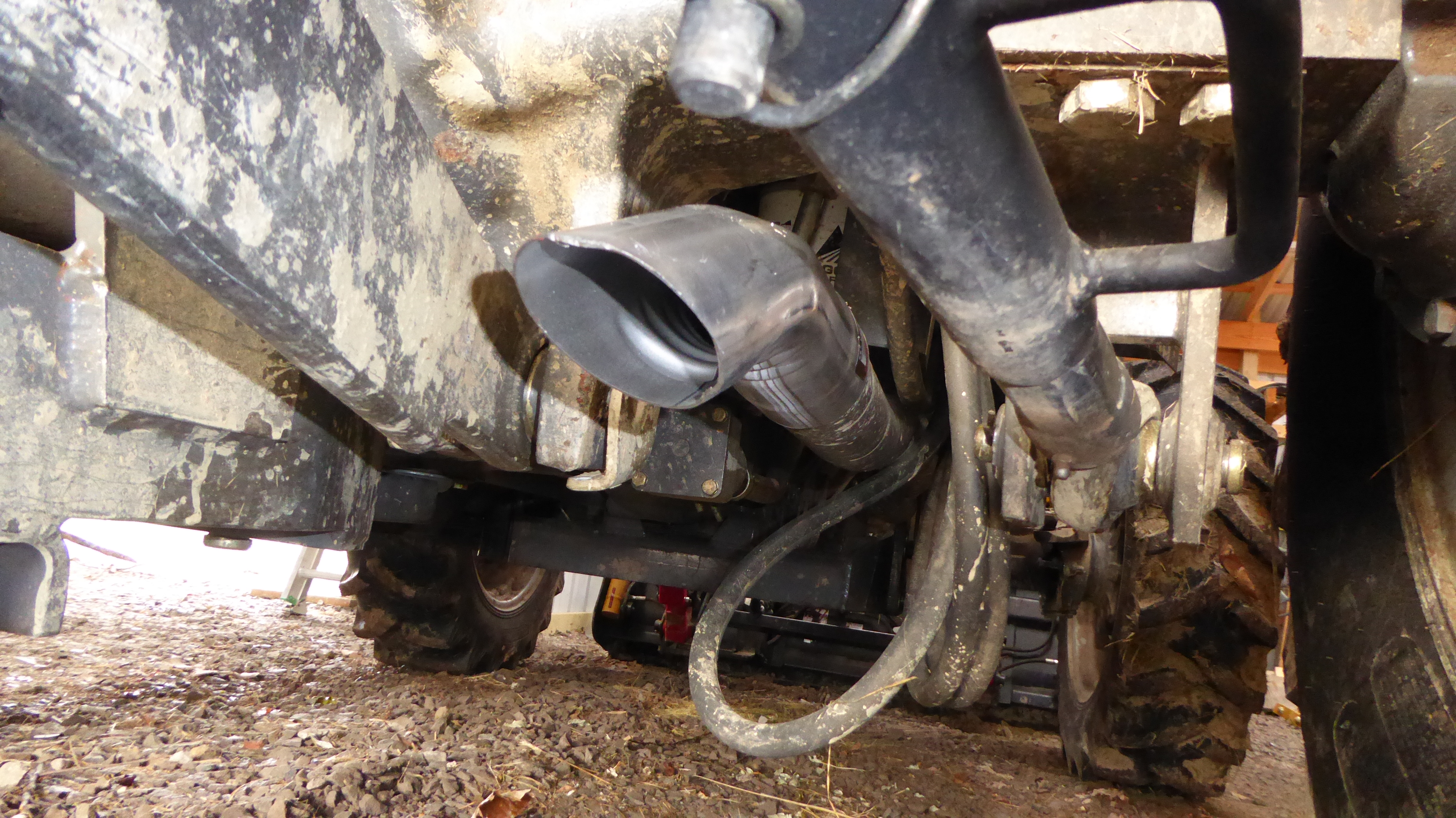

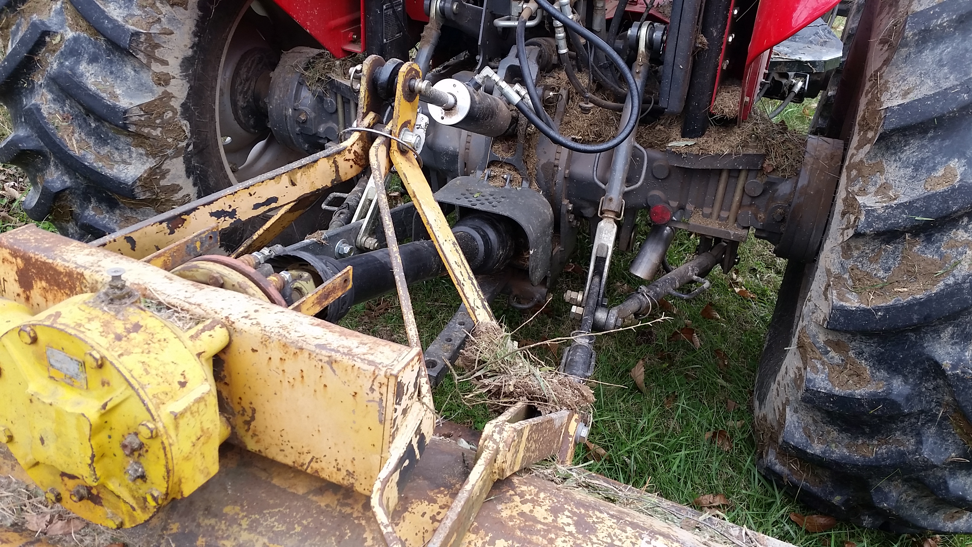

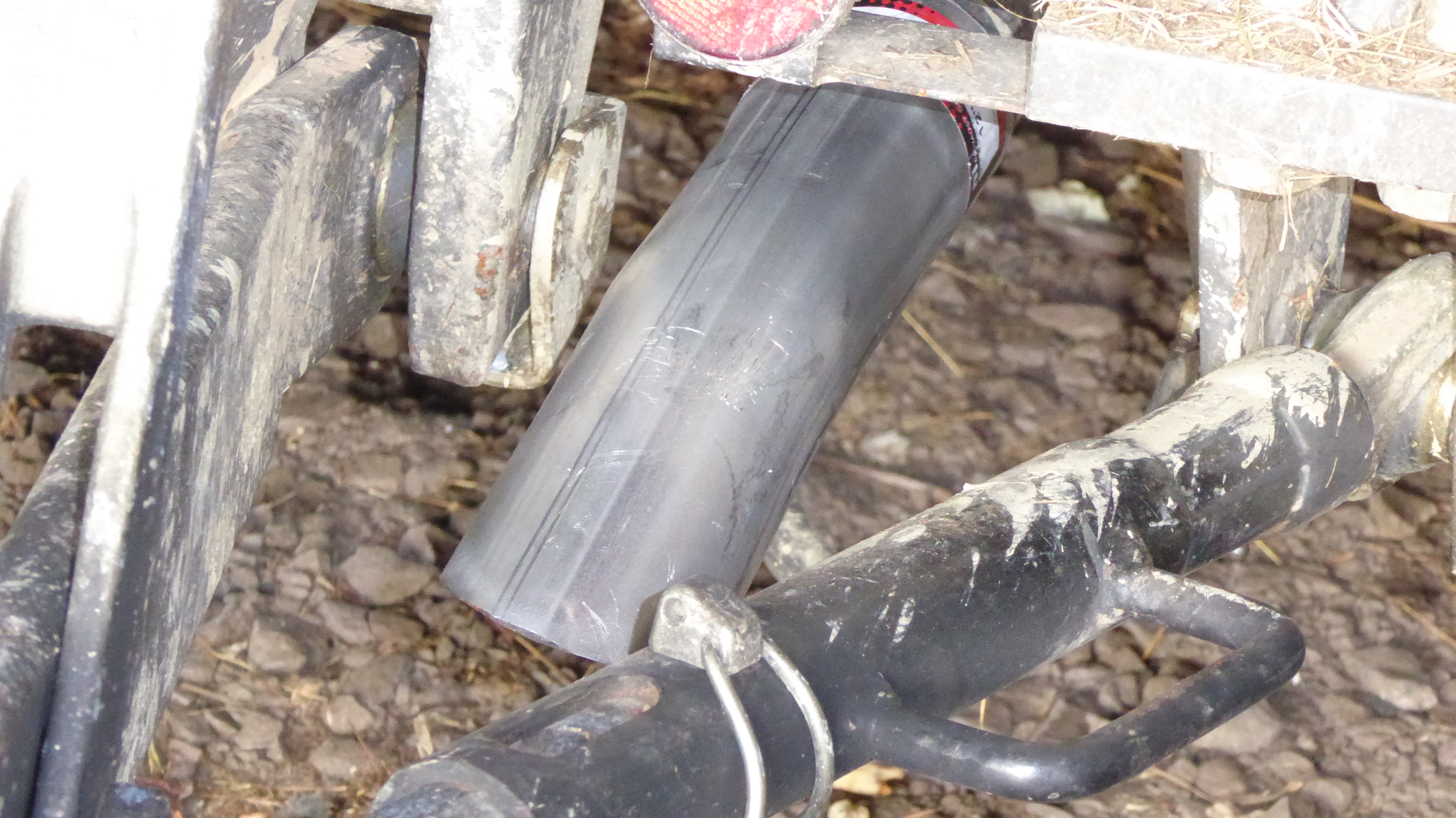

I'm not certain how applicable this may be but... 1) isn't there a low-profile version of the 4707/8/9 tractors? If so they usually have a horizontal exhaust out the rear similar to the old Fords and Fergusons from the 1950's. 2) My own MF2660 low profile has that horizontal rear outlet exhaust and I am very happy with it. So much better than the obstructions of a vertical exhaust getting bunged up by trees and brush, etc. I like it. I did put on an automotive type exhaust tip that curves down ward and directs the exhaust away from the 3pt hitch lift arm, etc. That gets too hot to touch without the bent exhaust tip. Mine is open station too. A cab would get beat to death with the work I do with mine.
3) Please excuse the dirty condition, the hydraulic hose that is hanging and since been secured, etc. but here are some photos. The last one with the yellow flail mower in back lets you see where that exhaust tip is relative to other things in the rear. As I recall the dealer had to bend the low profile exhaust a bit when he installed my loader frame.

Thanks JWR! The MF47xx tractors have a forward facing exhaust similar to my L4600 Kubota. Your comments really support my general thoughts and is helpful.
