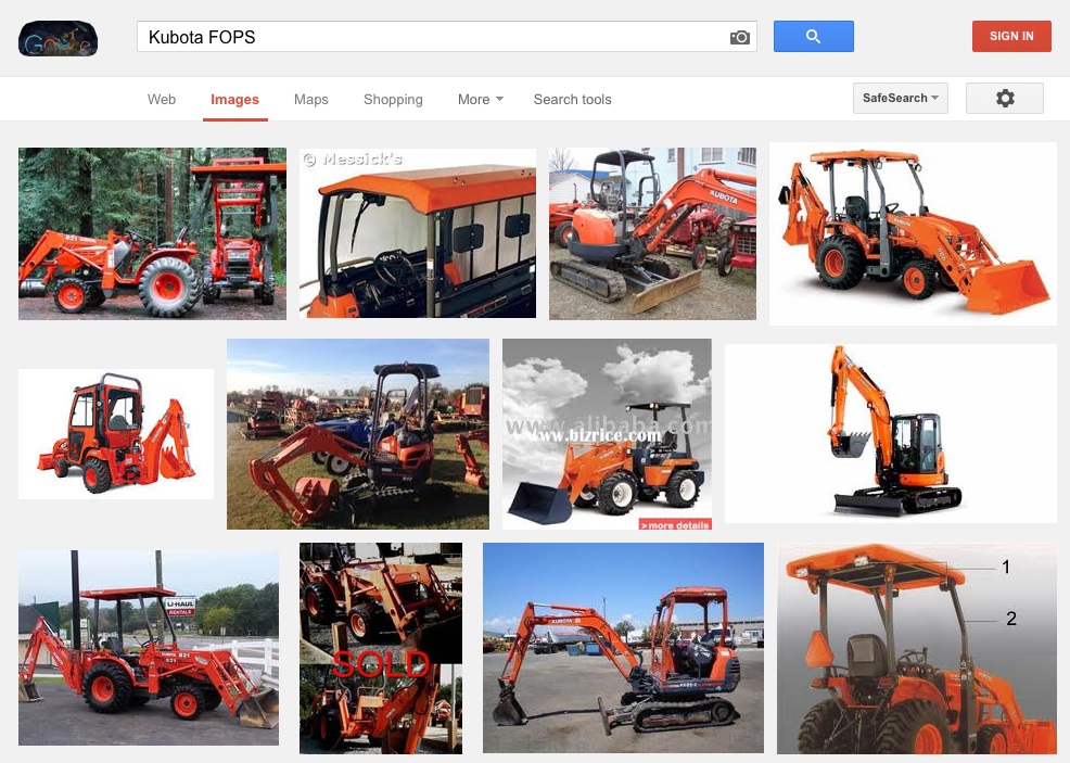

There may be a factory FOPS(Falling Object Protection System) for your tractor. Add some screen on the back, and it should meet your needs.
I see more on Kubotas than most other brands:
   / Protecting the operator area.. to build or buy?
Exactly what I had in mind. The photo in the right lower corner is spot on!:thumbsup:
