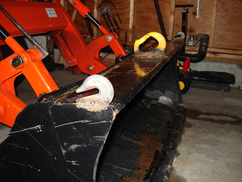

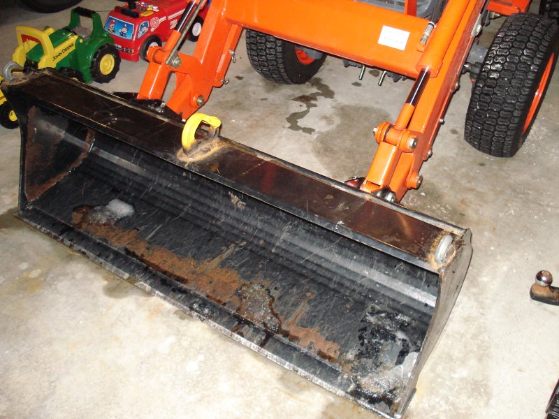

I had my brother weld 3 x bucket hooks on my KL-120 loader. The welds have rusted as I haven't had a chance to paint them.
My plan is to wire-brush the rust as best I can off everything and paint.
Questions for you guys:
1. Is there anything you recommend to brush on or spray on (brush preferred to coat liberally) to halt any remaining rust in a chemical way which can then dry and be painted over? I thought there used to be some product napa auto parts sold for just this purpose. Ideas?
2. What paint color exactly matchs original Kioti bucket black? I'm interested in getting the color very close, but also the finish. It looks somewhat matte, but somewhat glossy and I can't really tell what matches.
Any other tips on making the welds last a long time?
Maybe I'll go snap a picture as I know you guys like to see stuff like this.
I'll be back w/ some photos.

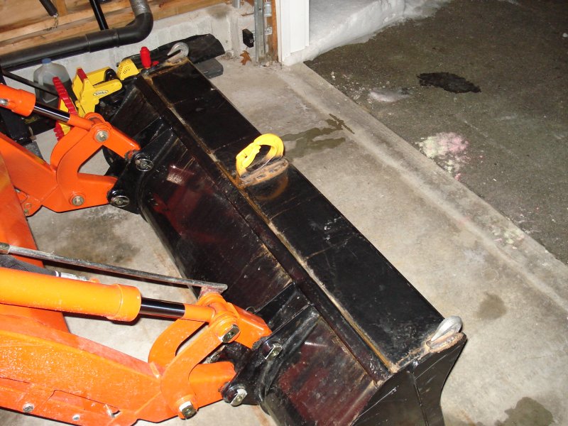

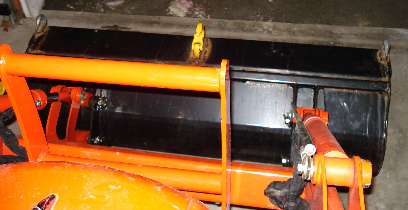

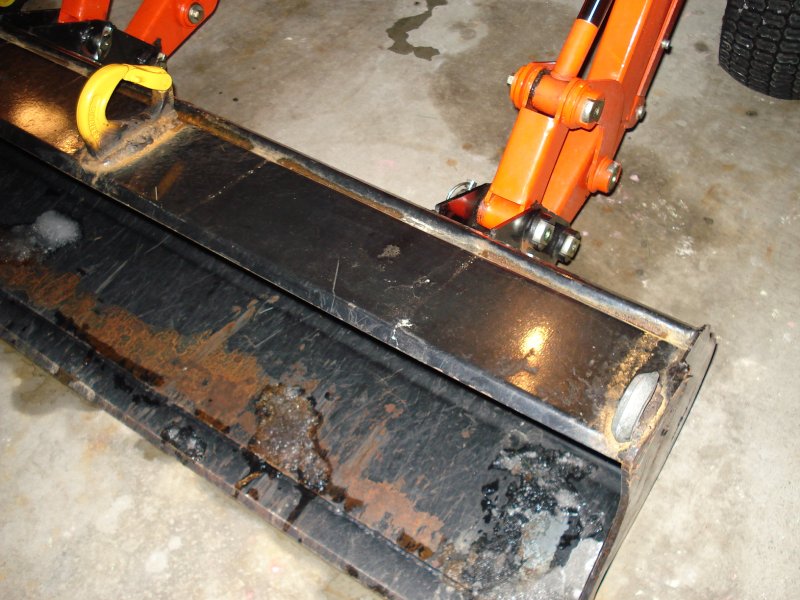

Here's the pictures.

Just hit them with a wire brush and a can of shiny black spray paint. That is what I did and the blend in with the bucket just fine.

IF you are a true rustophobic, here's the best IMHO:
Eastwood Company: Auto Tools, Body Repair, Classic Car Restoration, House of Kolor Paint, Powder Coating
If that's too long go to Eastwood Company: Auto Tools, Body Repair, Classic Car Restoration, House of Kolor Paint, Powder Coating and search for rust encapsulator.
Used on oil rigs in the ocean and by me for 20 yrs restoring old cars. Used to be called "corrolus."
The spray cans are convenient but clog up after a while, and it is distressing to have a $25 spray can defective! I would get the normal can.

Just ordered a pint of the Eastwood rust encapsulator.
I have a paint sprayer and compressor -- would you recommend cutting it w/ a reducer, cutter, or thinner and spraying it? Or is it so thick it will ruin the paint gun? I certainly don't mind brushing it to really coat it well in concentrated areas.
I am a bit of a rustaphobic although my bucket pictures don't project that image too well!! The camera flash makes every blemish shine through!
I'll get everything coated and perhaps shoot it w/ some black shiny paint afterwards.

Good choice! I've sprayed it fine, just thin with whatever it says on the can, I forget.
But looks like you could just brush it on those places after wire brushing them a bit.
Note that it works better when there is a little rust on the surface.
It dries nice and hard in a day or two and has a slightly flat black surface which can be coated with most anything.
