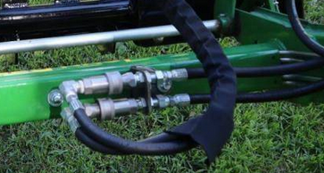

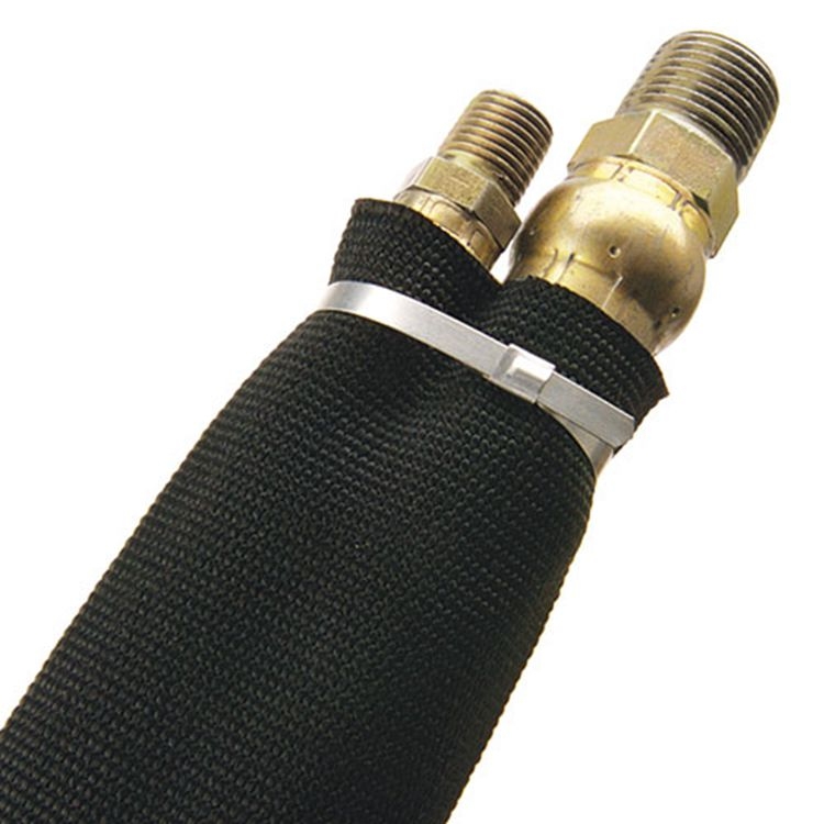

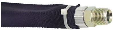

I'm adding hydraulics to the front for a grapple and will be running two 14' x 1/2" hydraulic hoses from the rear remotes. I want to protect them with some sort of sheathing. Either cover them individually with 1.15" sheathing and tie them together with cable ties or run them both in a 2" sheathing. Which do you think would work easier/better. Any advice from your experience would be appreciated. Thanks in advance!
Electriduct 2" Nylon Protective Hose Sleeve - 25 Feet - Black​
Electriduct 1.15" Nylon Protective Hose Sleeve - 50 Feet - Black​

I’d use a separate sheath for each hose, simply in case I have to replace just one hose at some point. Just makes the change a little easier.

That nylon sheath is best for protecting the hoses from the sun. Use single runs. But either will work just fine.

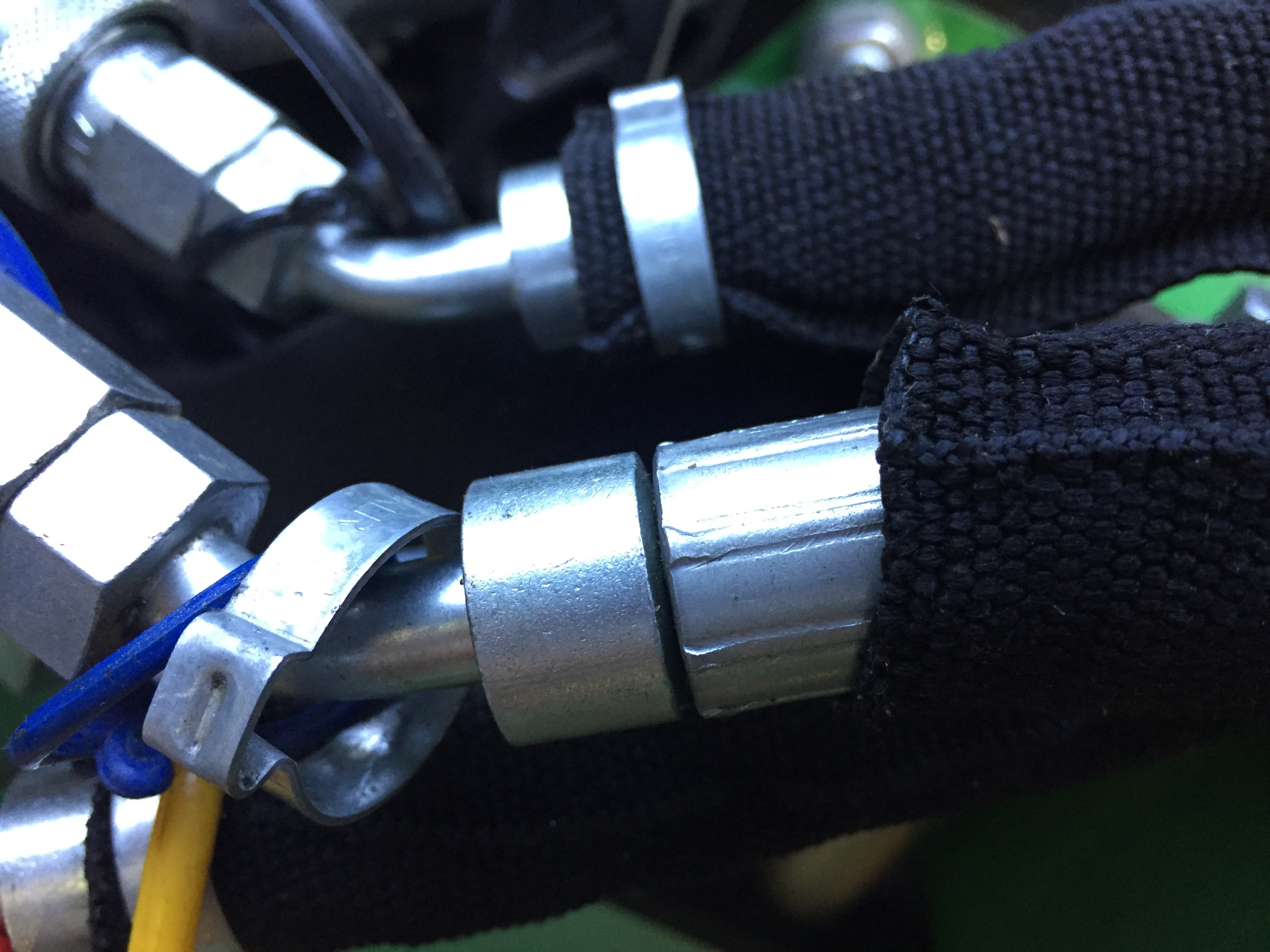

I use the the nylon sleeves on the individual hoses. For two reasons; abrasion and I think it keeps them from dry rotting from the sun as fast. i terminate the end with this style of clamp (Nippers make them good and tight).

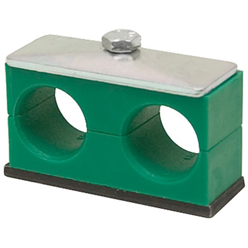

I did similar on my M5030DT to run a grapple using a rear remote. Single sleeve for both 1/2” lines. Used Gates nylon hose protector from hydraulic shop. Welded on three line clamps to help support the lines. Over twenty years without any problem.
