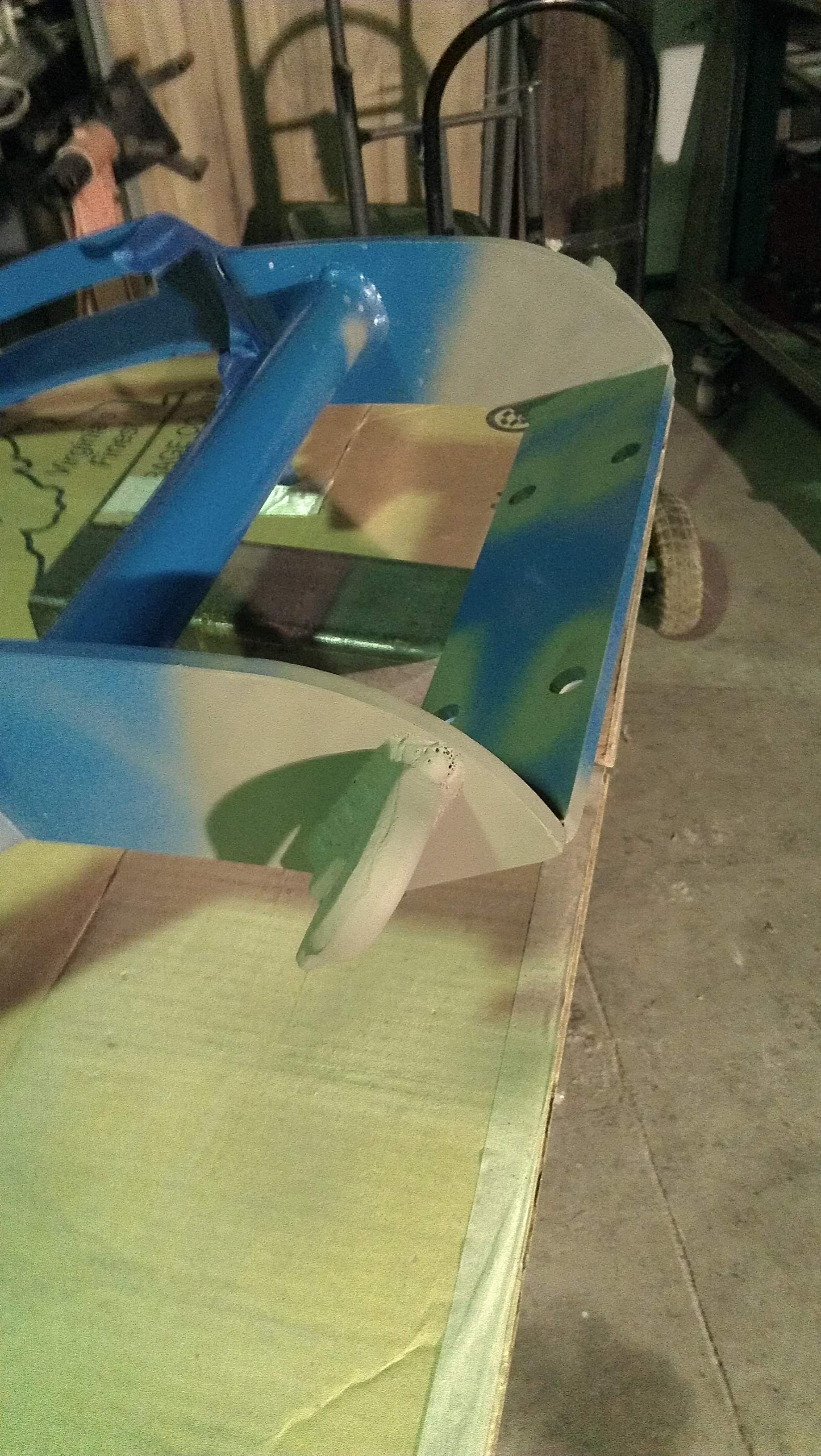

I bought the H-220LR Gannon last week for $475 it needs new hoses other than and paint that is about mint. I think I'll paint it blue to match it new mule.

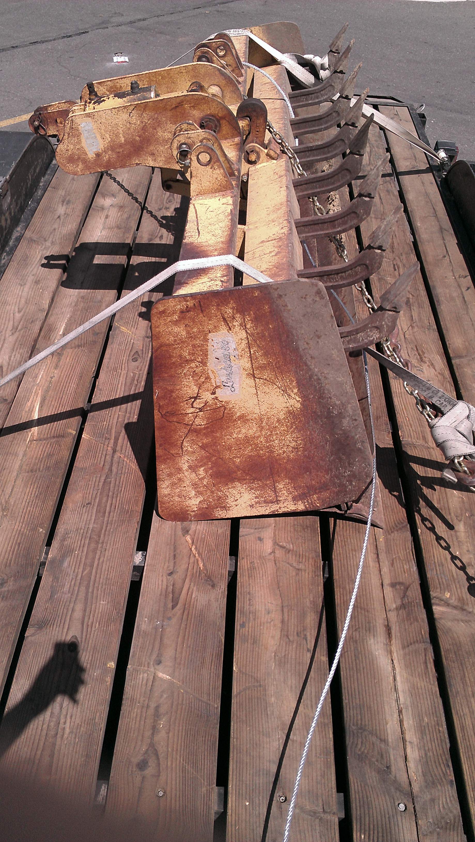

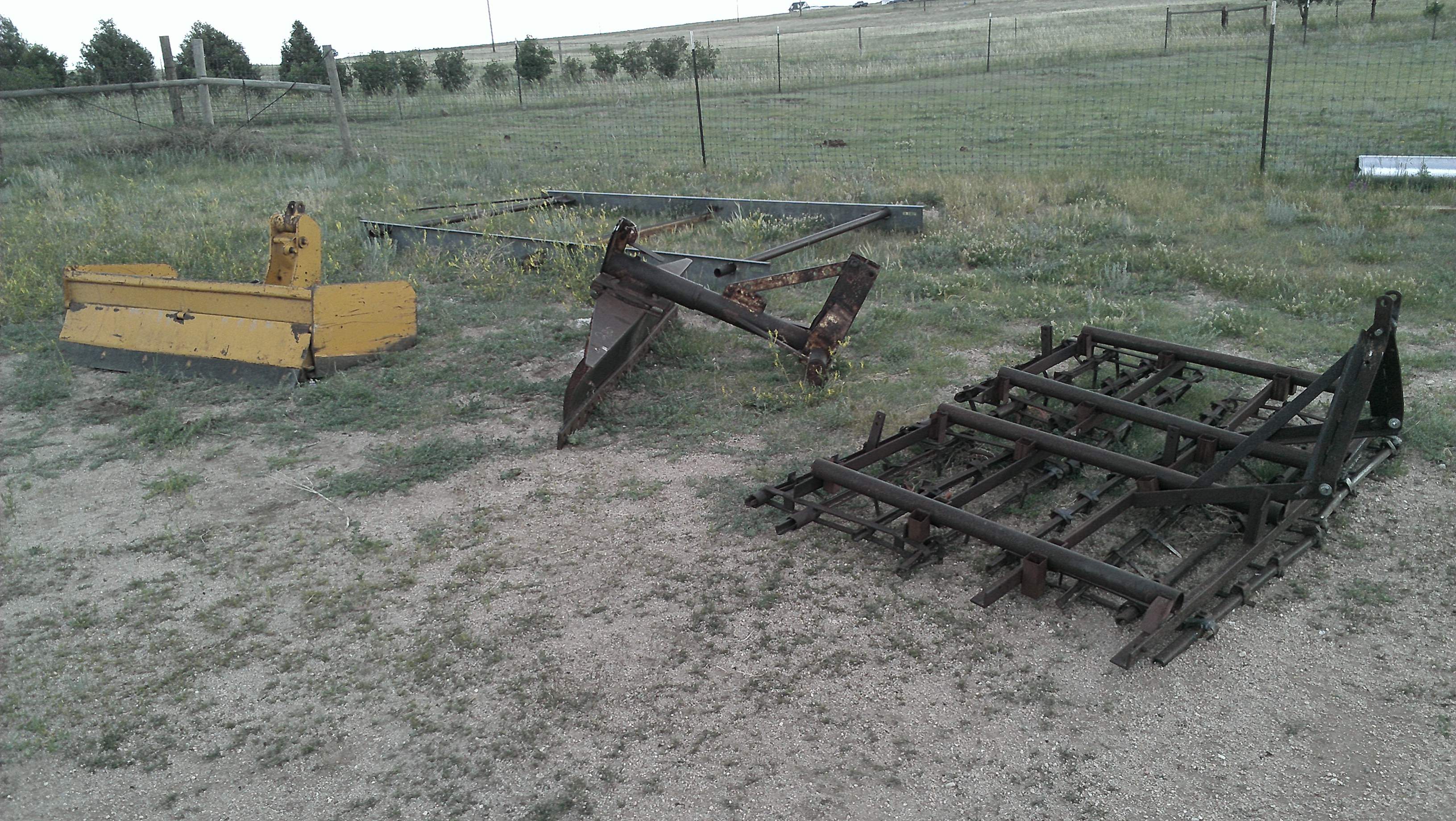

Here are the other attachments I've acquired at auctions prior to the new toy, but I think I'll sell them and upgrade.

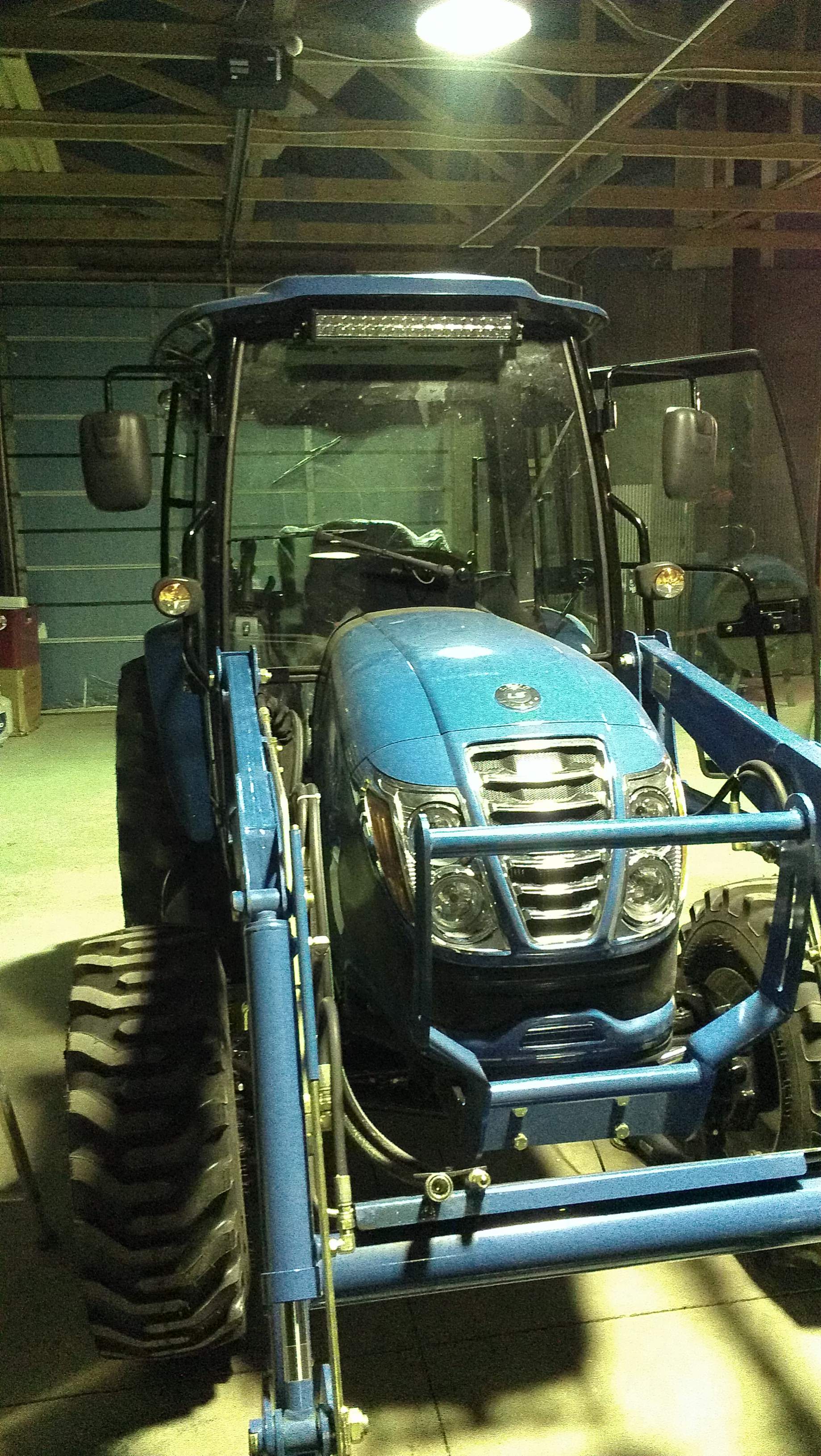

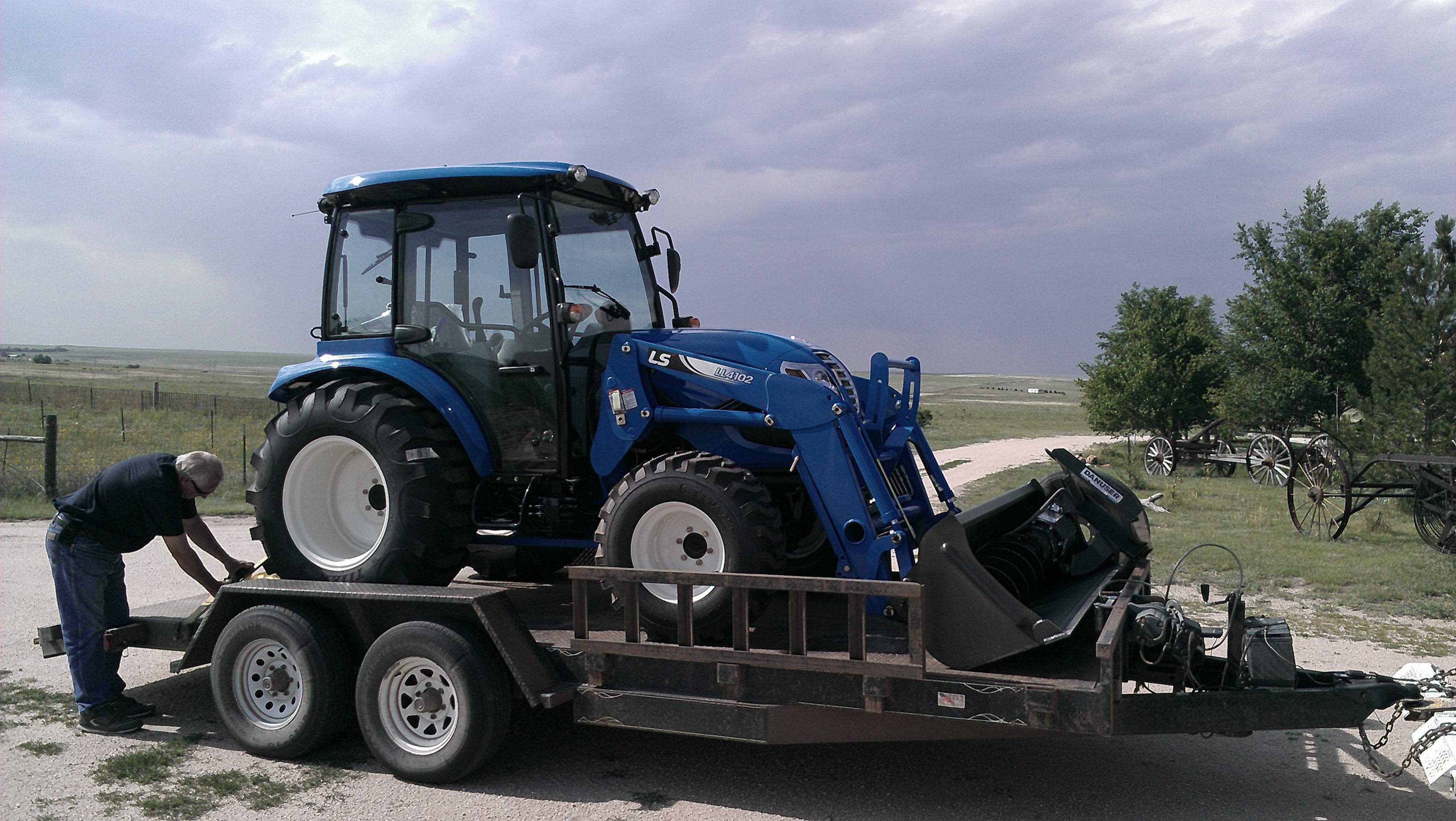

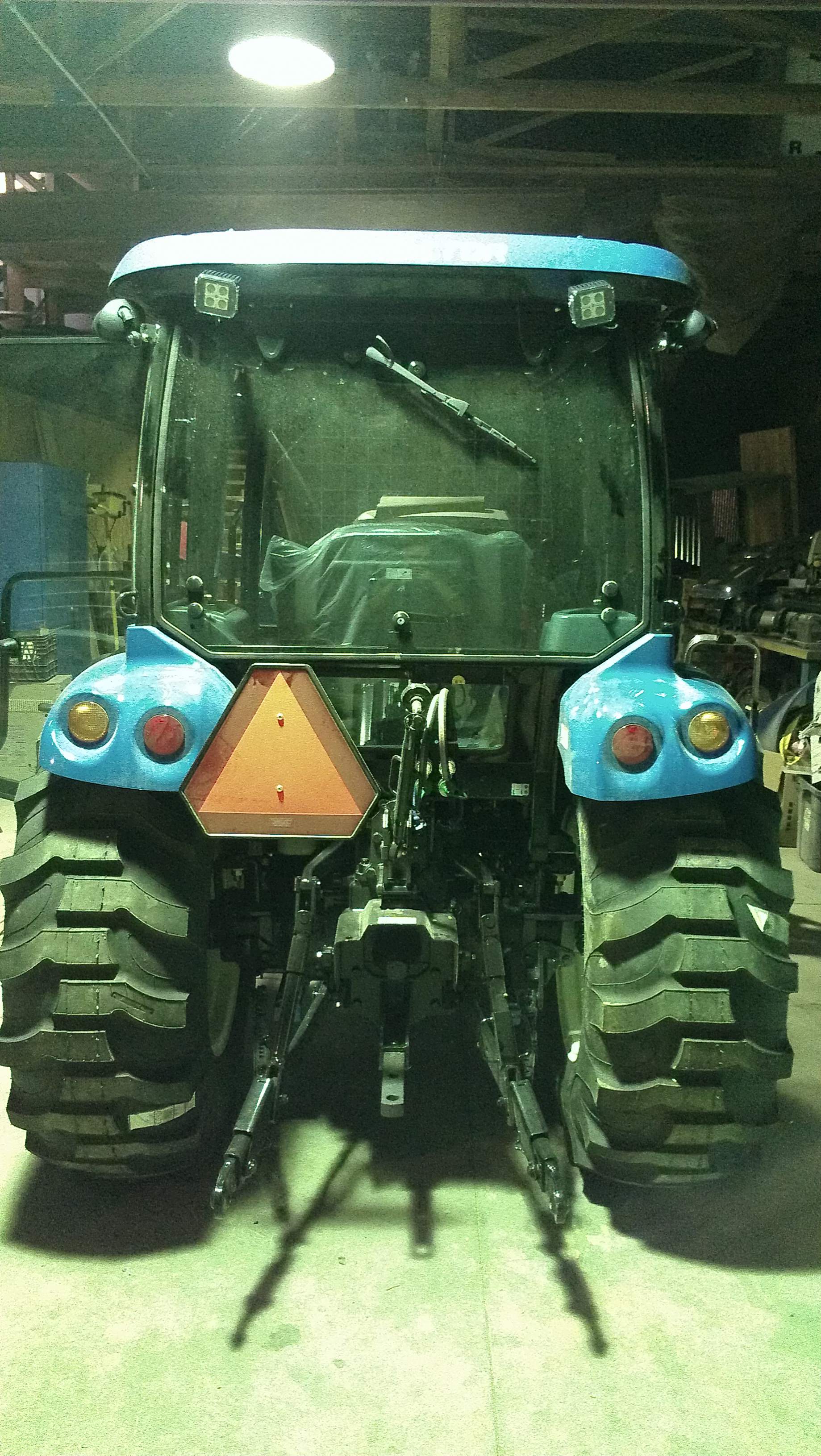

I took delivery today from Penrose Tractor Factory.
Spend about 20 minutes behind the seat and then began modifying..... :thumbsup:
I removed the factory front and rear lights and replaced with LED's two 4x4 floods in the back and one 22" combo flood/spot in the front.
It was actually pretty easy, it would have been easier if I has some bullet/butt connectors instead of crimp splice.
The hardest part was fishing the power up the driver side channel.
I still have to find a 30 amp fuze holder other wise I have some nice blazing bright lights.
If you want some details on how I mounted the 22" LED bar let me know, It was just a little cutting and welding no extra materials needed..
I also removed the factory speakers and will receive the new ones tomorrow.
But since I had a set of Orion 5 1/14" Components sitting in a drawer I wondered it they would fit and they will so I will now be installing those tomorrow vs. the 4" Rockfords I ordered.
I did find one thing I wondered about on each side near the back of the canopy there is an outlet that looks like a miniature cigarette outlet. Does any one know what this is? I did not check to see if it's constant or switched. Is this for beacons/strobes?

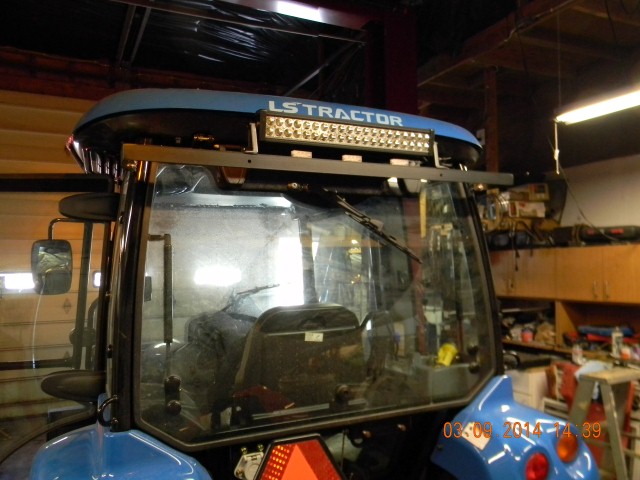

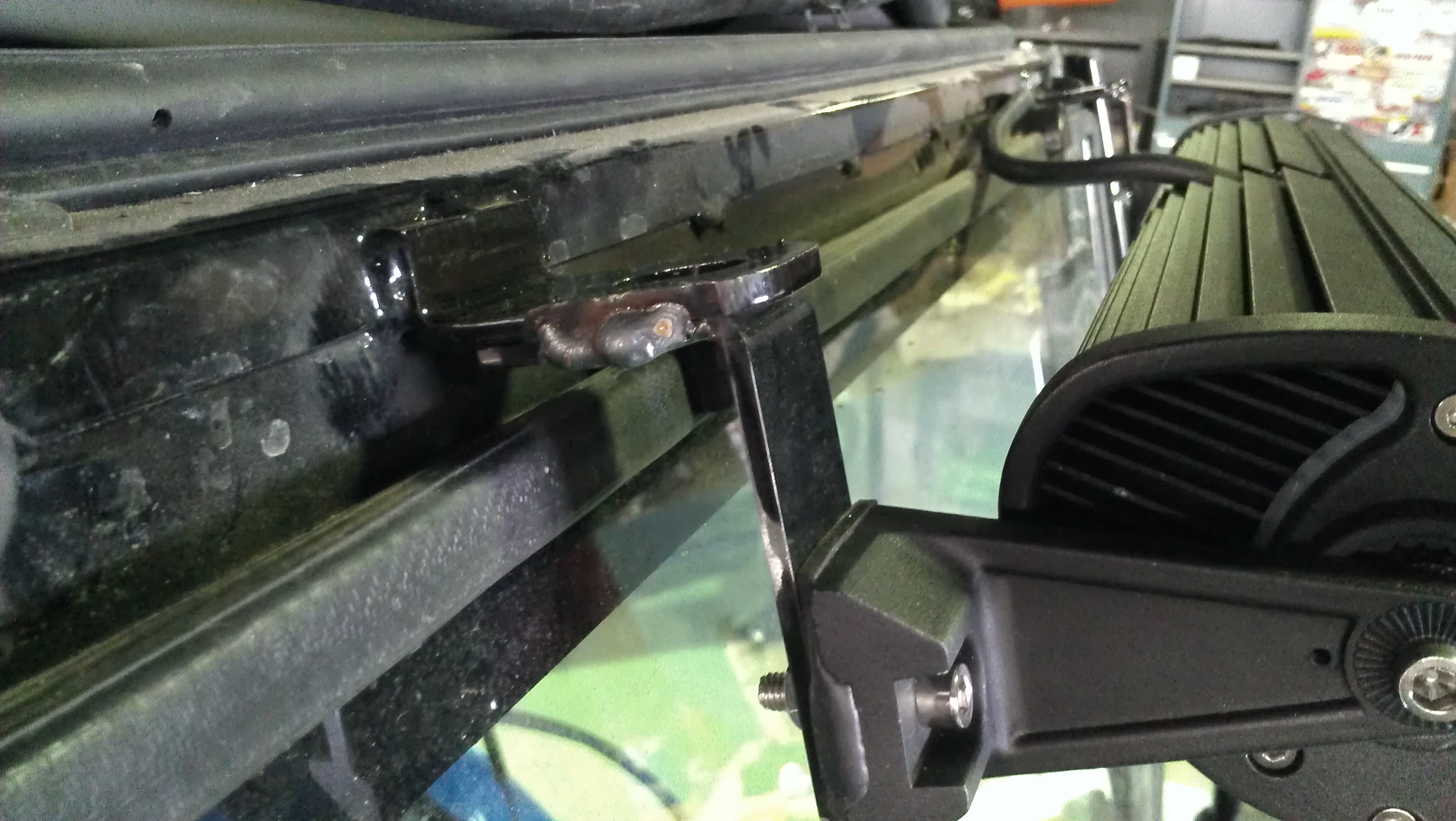

Some additional info on the lights.
I had bought the lights in. A group buy about a year ago. They are the typical eBay Amazon LED. The specs on the front bar is 22" 120W, 9000 lumens flood/spot combo I bought it for $170.
The rear are 3" 12W flood pattern these were $75 for the pair.

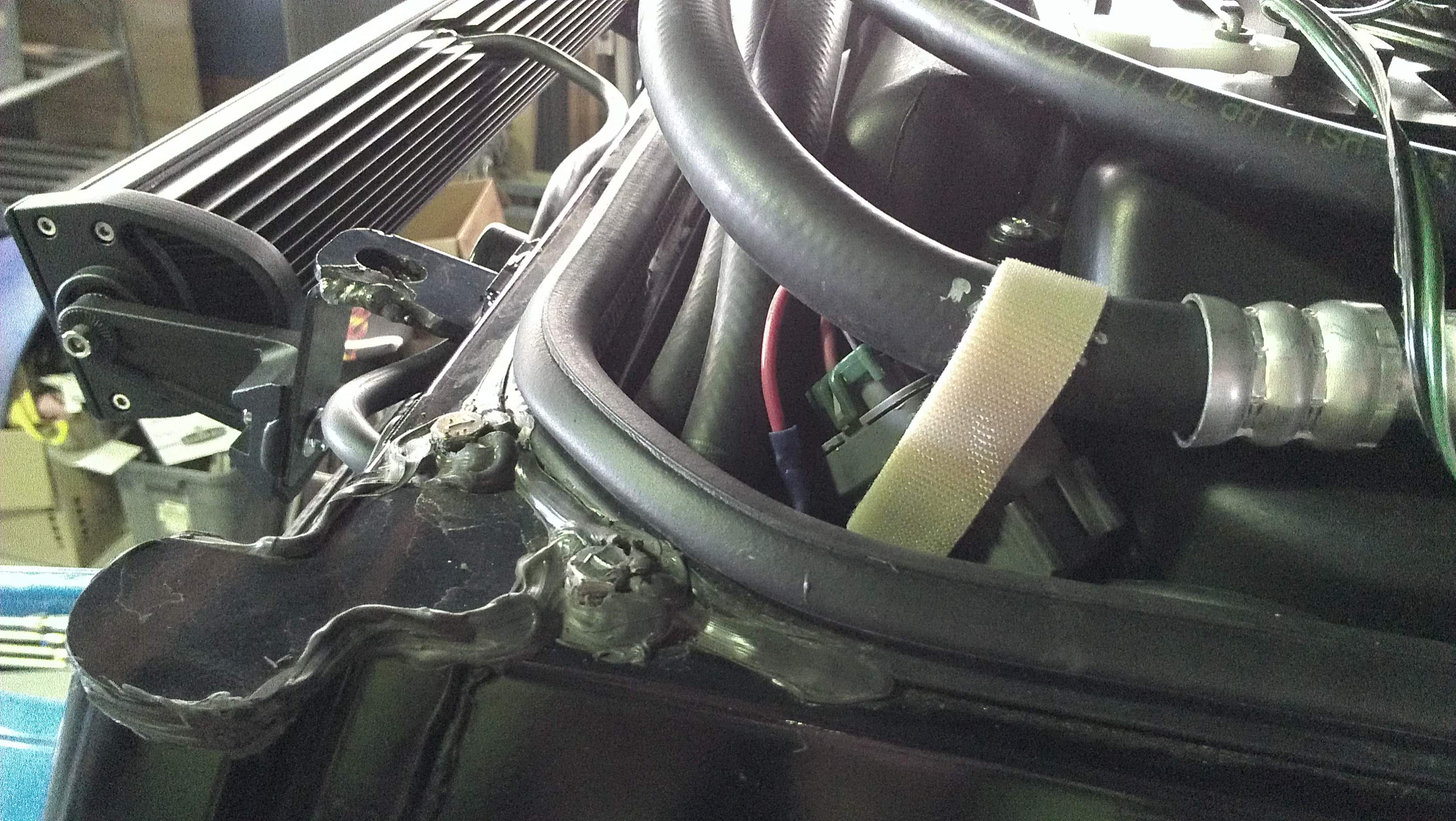

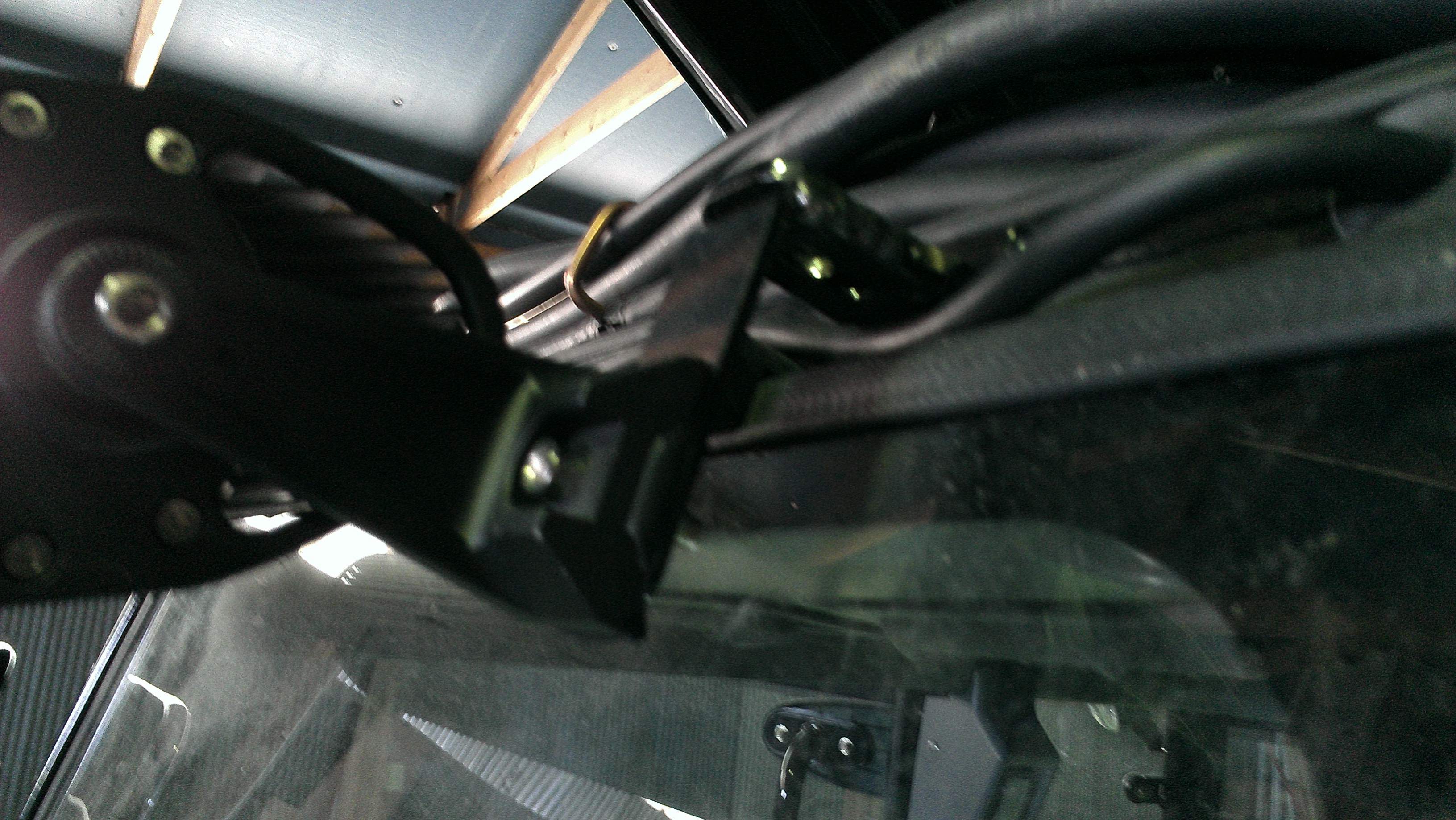

On the front I removed the original brackets that held the factory lights to the canopy, these were reused to mount the light where the 2 bolts are that hold down canopy.
They have a small bend on them that originally kept the factory lights from rotating this was cut off so that I could have a "L" shaped bracket.
The original hole placed the bracket to far out and would cause it to hit the fiberglass so I drilled a new hole closer to the bend to account for the clearance.
Mounting
Now at this point you could go a different route I decided to weld mine on.
The reason for this is I did not want to wrestle with a light that I could have to mount and dismount anytime I wanted to open the roof.
You could epoxy the brackets I suppose as the weight of the light is supported once you bolt the roof back on.
This left me with two brackets that ran parallel to the windshield. The best part was the spacing was exactly the same as the mounting as the new light.
Due to the current draw I decided to use a relay and the factory switch.
The main fuze block is on the drivers side sot made sense to run he 14g wire up that side.
At the top under the canopy is a cover that is silicone sealed it held down with two 10mm bolts. I ran a fish tape through from the top to the bottom.
I reused the factory grommets for all the wires I had to cut one a little larger so that the front wire could make it through as its a heaver gauge.
The rear lights are an easy remove replace with the exception of the terminals.

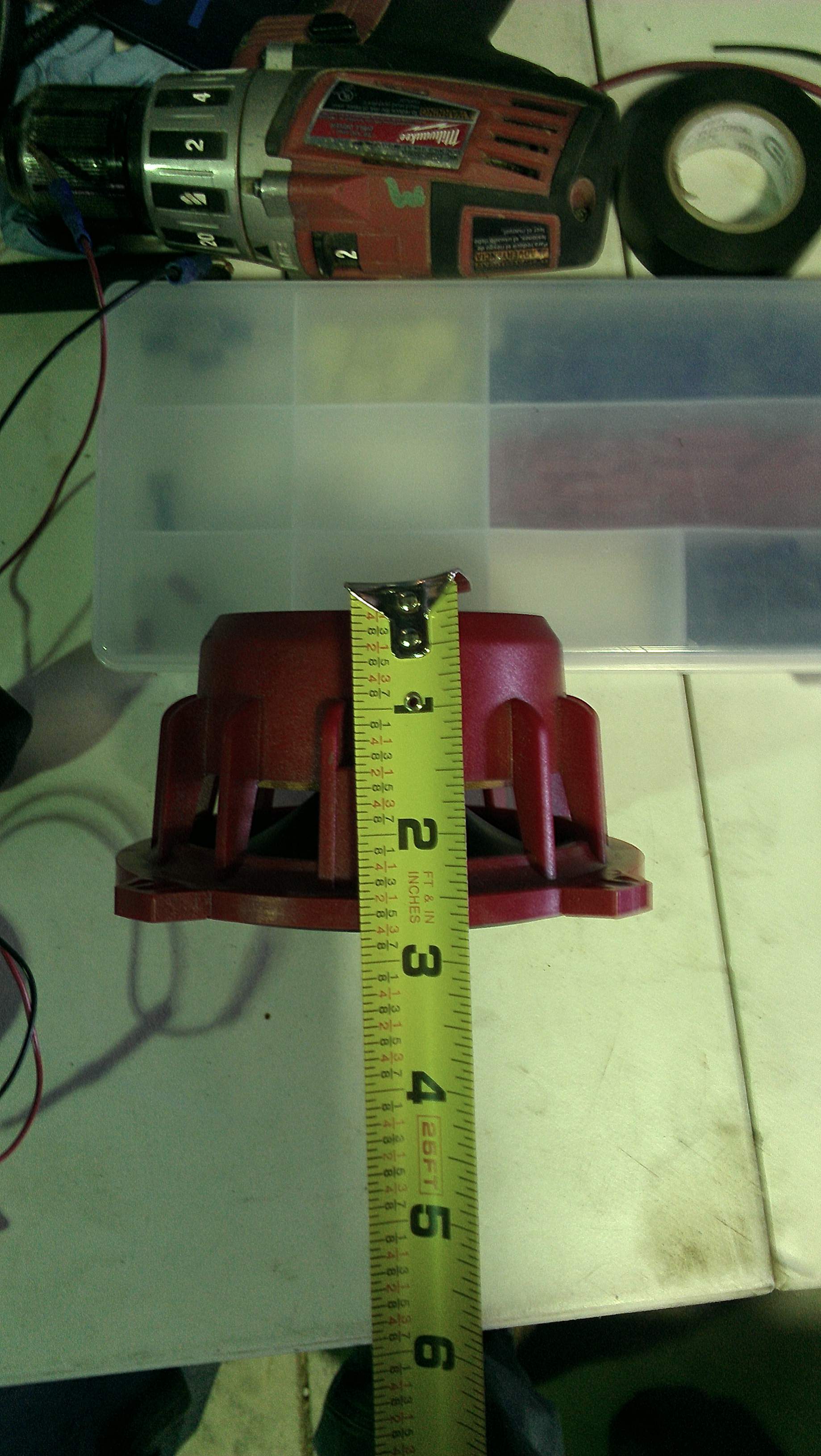

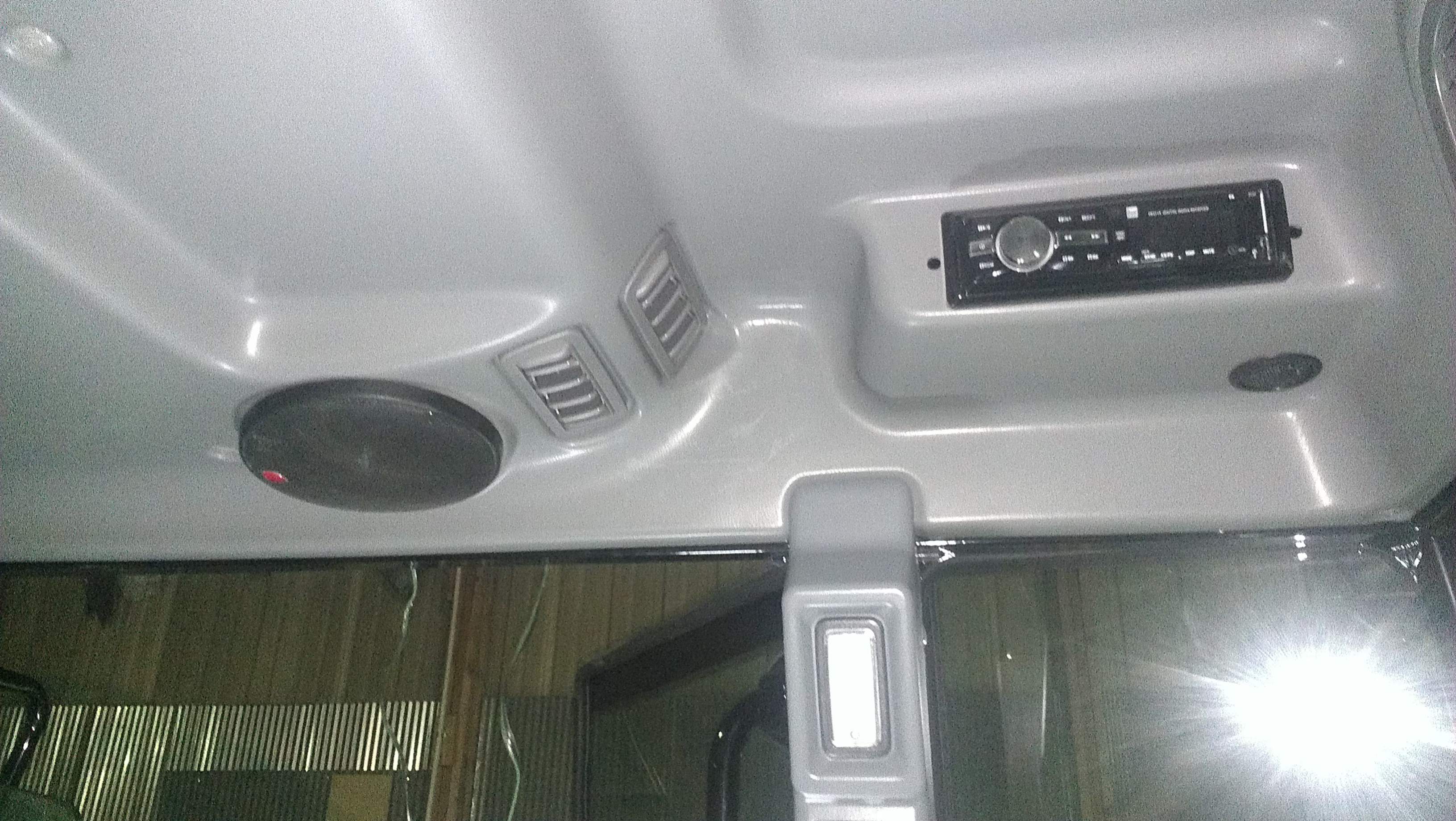

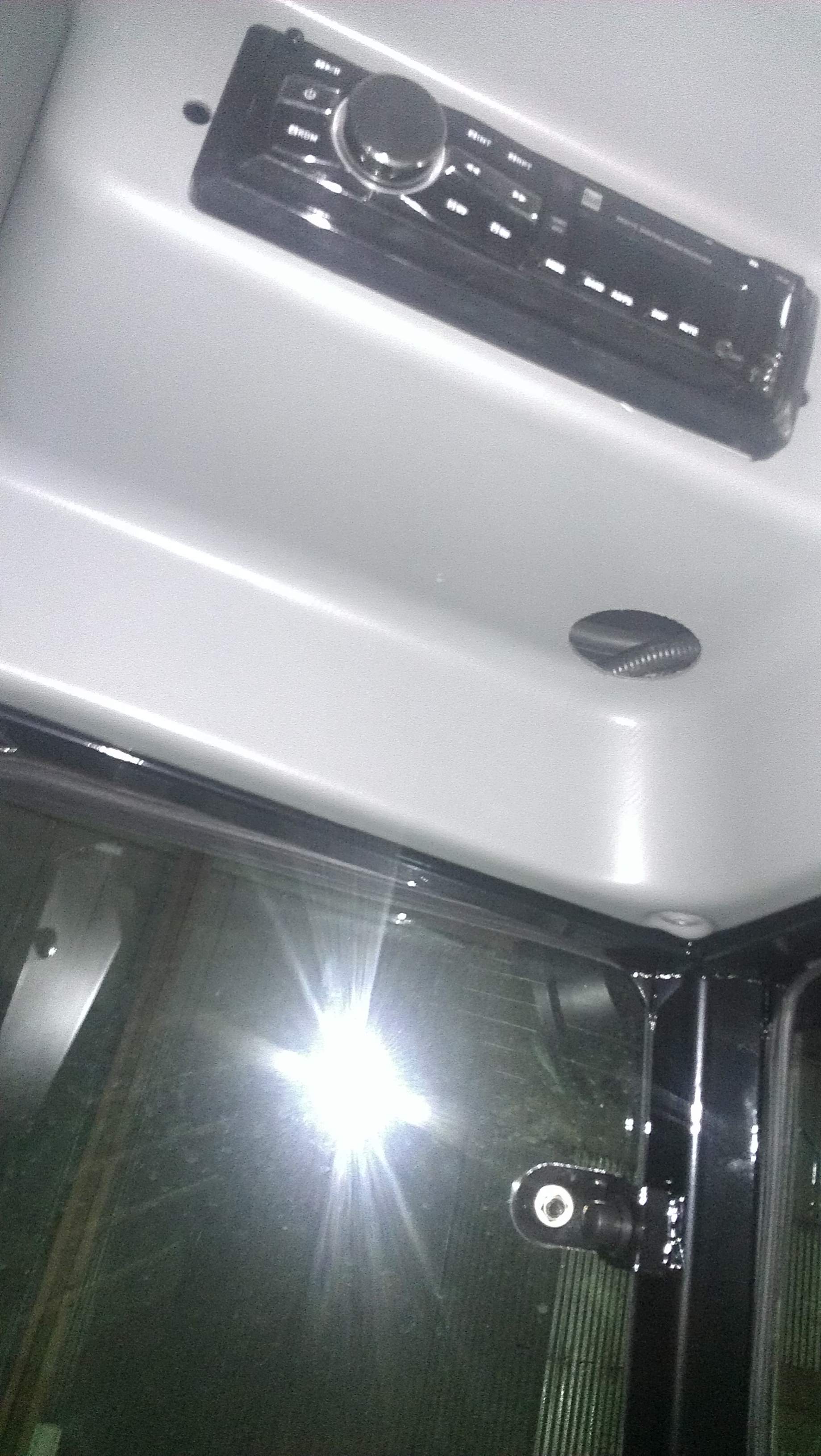

Alright I got the speakers installed so for those of you wanting a large speaker it is possible in the factory location with a little modification to the headliner.
Here are the measurements, they just fit due to the A/C ducting.
Well I had both measurements but the over all dia. was 6"to the outer edges.

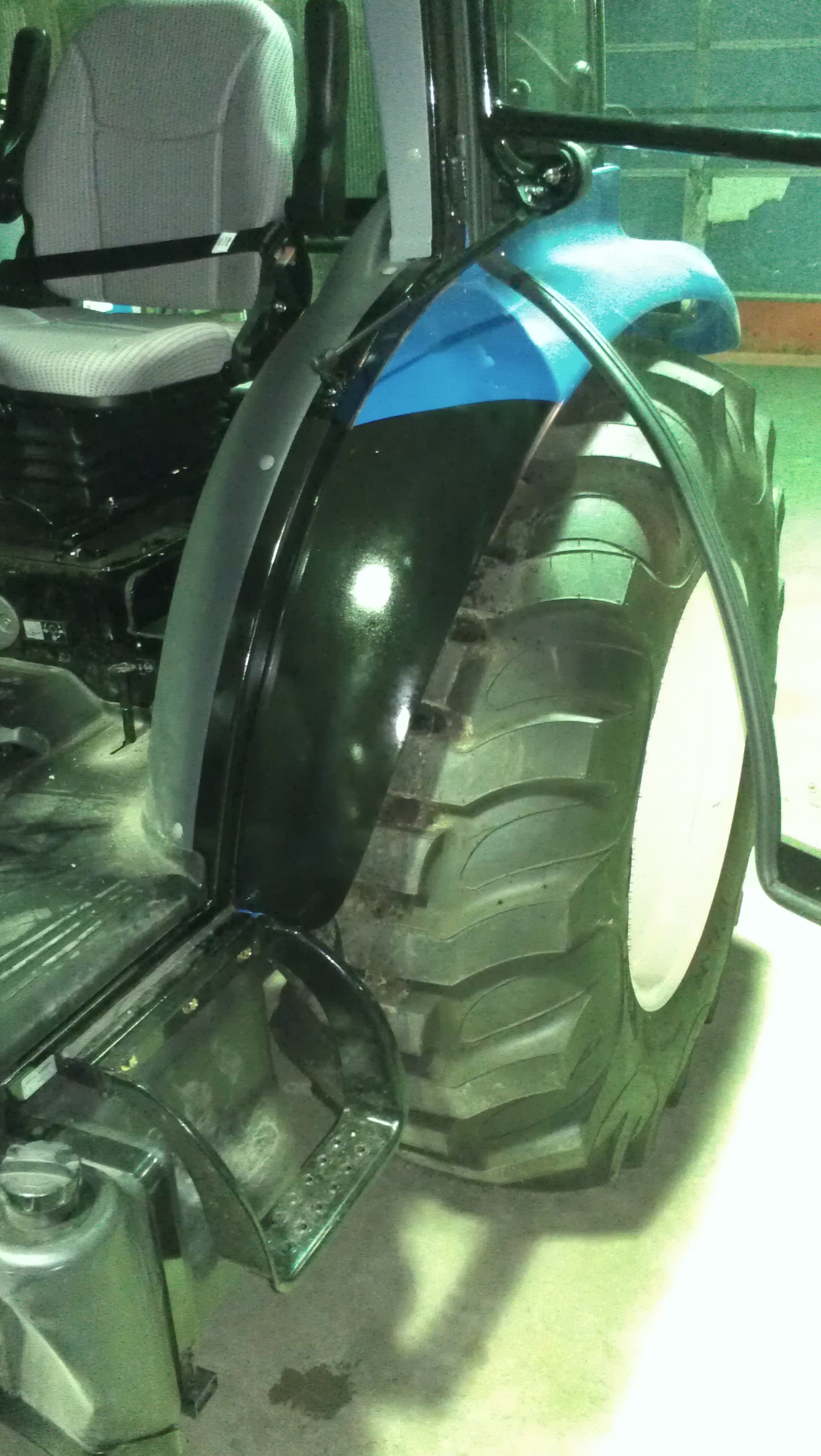

And the last modifications I performed tonight was moving the seat back a bolt hole to gain some room.
And I plastidipped the driver fender as it looks like it will get a lot of rubbing from getting in and out and avoiding the mirror.

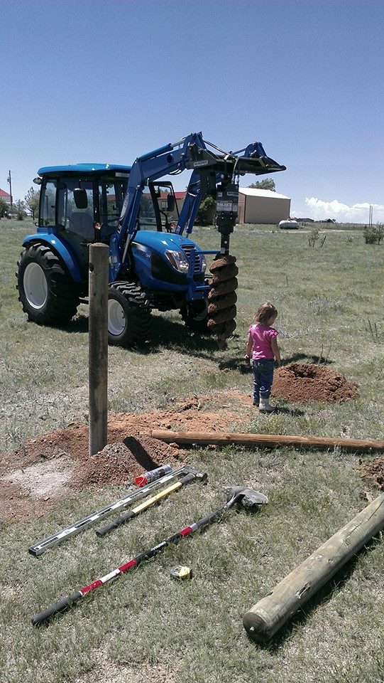

We we logged 4 hours on it delivered with 2.2 and parked at 6.2. The DPF regen cycle came on at 2.4 and I ran it at 1500rpm for 20 and it completed its cycle.
One thing that I have to get use to is the speed of the auger, its nothing like a PTO. It has the power and the ability to have down force is great but I was unable to spin the dirt off like I would with a 3pt mounted post hole digger.
I had to dig turn off and pull the hole clean with the bit. So it was messy compared to 3pt since I now have two piles of dirt.

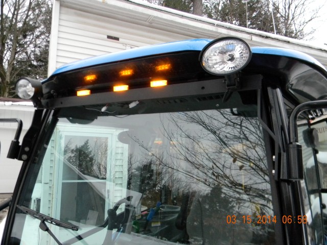

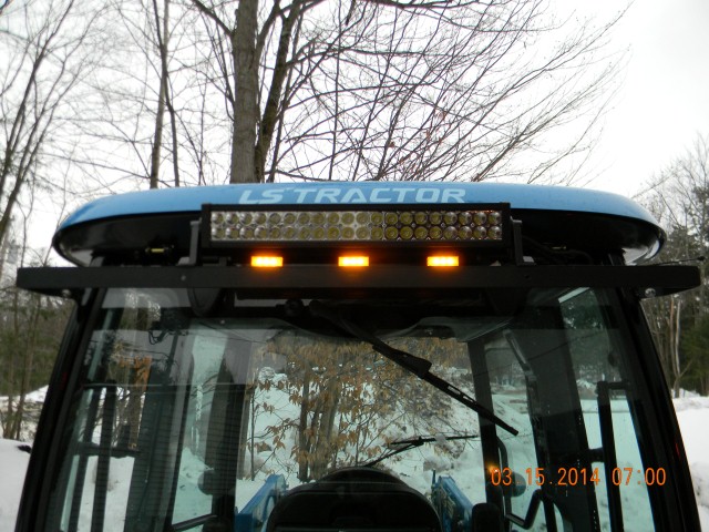

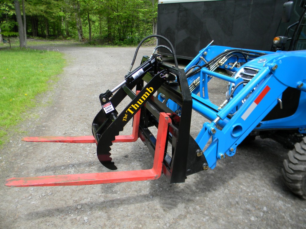

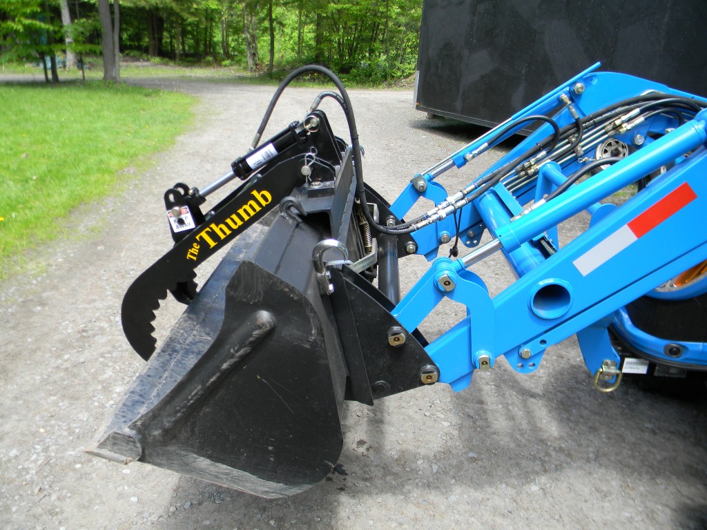

I made light brackets for my XR3037HC. Mounted a 22" 120W LED (<$60.00) on the rear. The front bracket I mounted to the mirror brackets and moved the front cab lights down to it. Now I don't have to unplug them to pop the top. Also put 3 amber flashing strobes on the front bar and rear bar. I installed my own AM/FM/CD stereo but don't listen to the radio that much so the factory speakers are good enough for me.
I also ran hoses from the rear remotes to the front for my hydraulic thumb. I can switch the thumb from the forks to the bucket.
I also ordered a 7" monitor and cameras to mount front and back. I installed the monitor yesterday but the cameras haven't arrived yet. I will start a new post in the LS section once I get them installed.

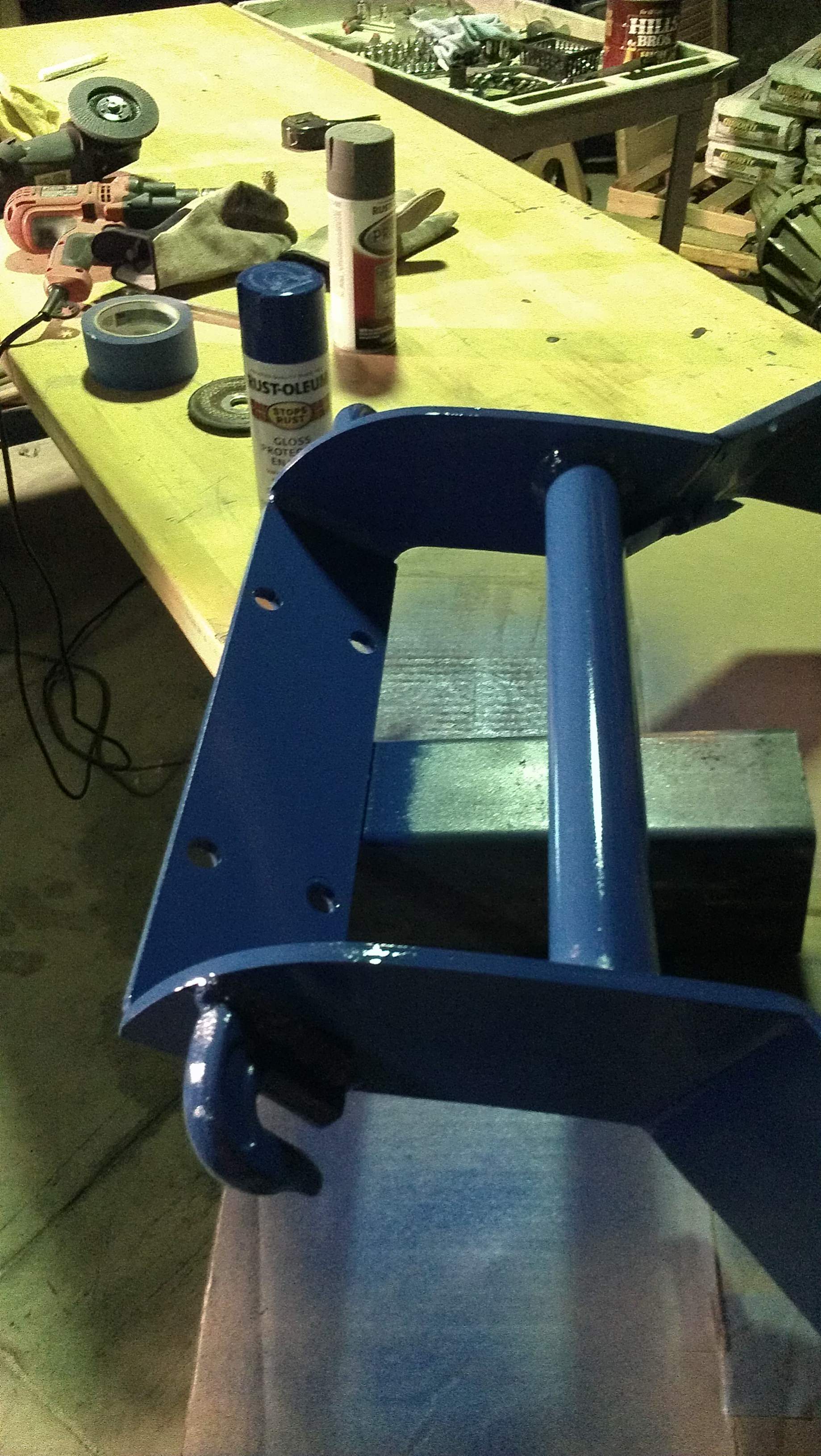

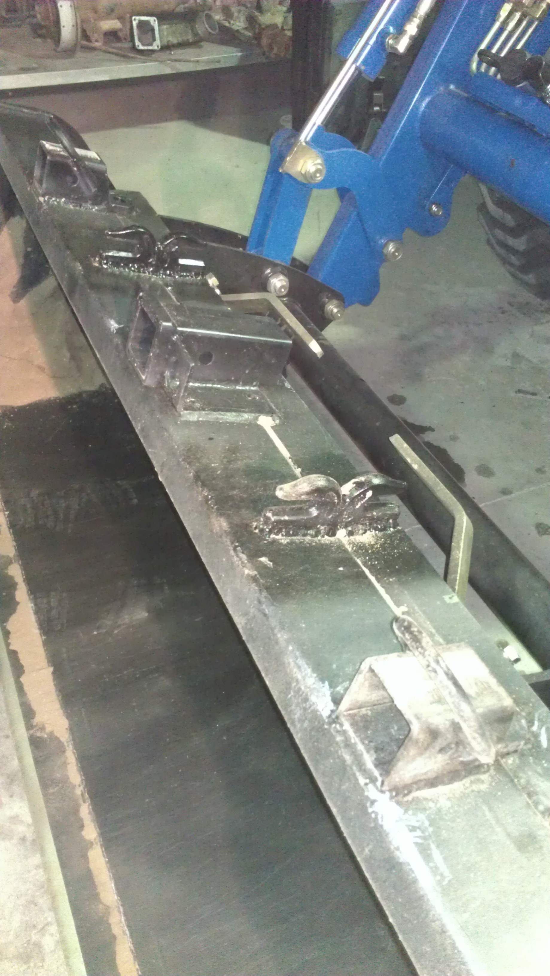

Over 14h now, I finally got to do some welding
I added four 3/8" hooks to the bucket and three 2" hitch receivers. I have the hooks facing forward and back so I can place the chain anyway I please.
The 5/16 chain hooks fit through the receiver openings but the 3/8" chain will not but the give me a good termination point if needed.
I also added two 3/8" hooks to the front brush guard so as I have a sold tie-down point for transport.
