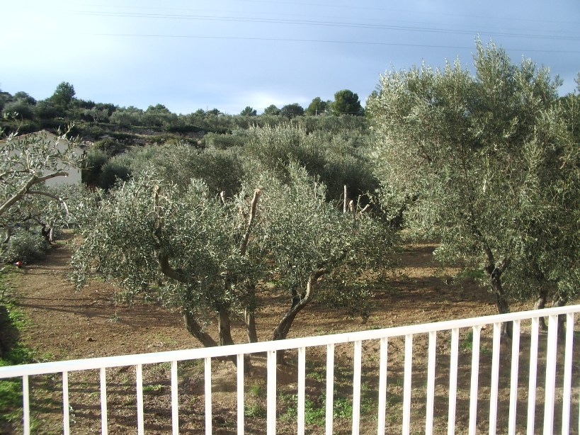

In the first pic i am showing a pruned back tree next to an un pruned one, only the grand pruing has been done, the cut tree still needs the fine pruning done. This will give you an idea of the magnitude of the project.

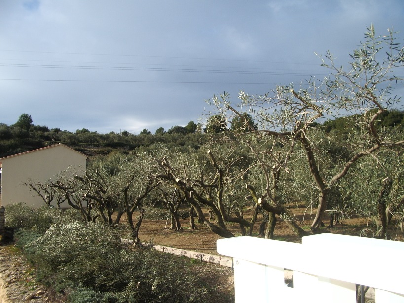

In the second pic I'm showing a row of perfectly pruned trees

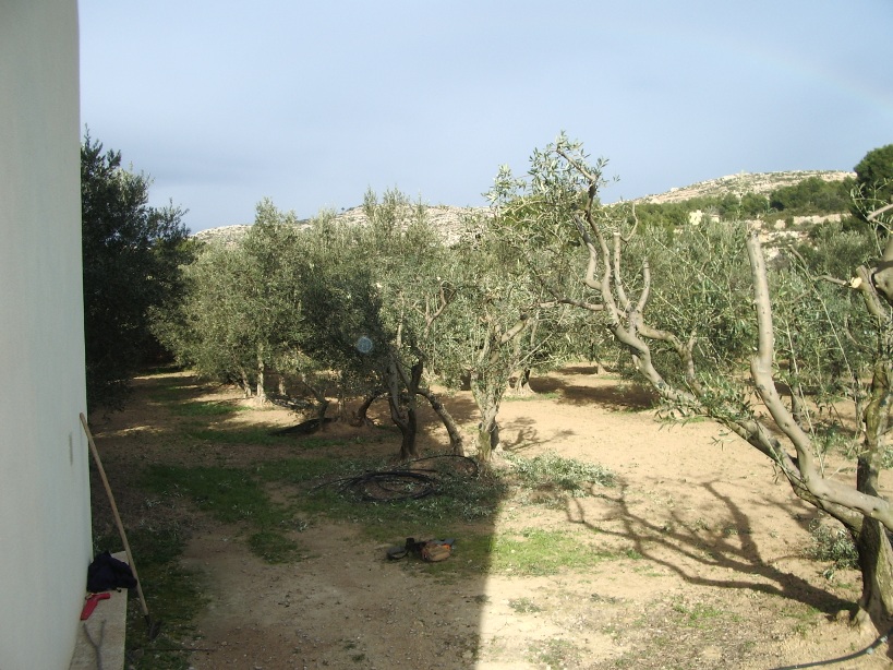

In the third pic I'm showing a close up of a pruned tree. Notice how bad it is is you cut off all the bottom branches and let the trees grow to tall. you ge no bottom growth! Thankfully olive trees are almost impossible to kill and they grow back quickly. Within 2 years the trees will be totally filled out and again need pruing back.

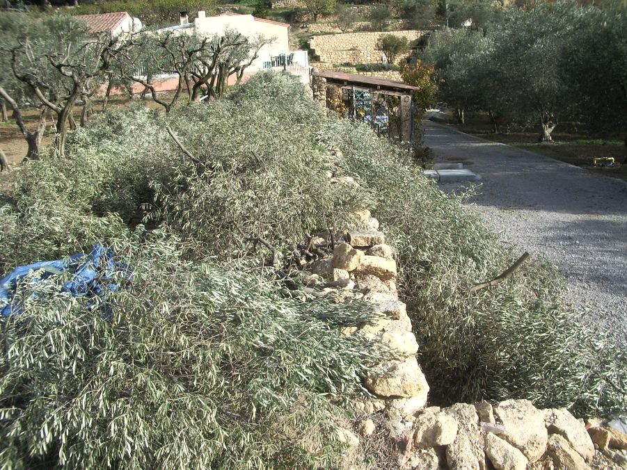

In the Fourth pic is just a small very small part of the brush that we now have to take care of. we lop off the small branches and save branches and limbs for firewood. My husband will burn the branches in the space between the olvie trees. We could never do that before because the trees had grown out to wide and it wasn't safe. now that we cut them back we can burn right in the field, that will be very nice. We have our tractor ready with a spayer filled with water, as our stand by firetruck tanker.

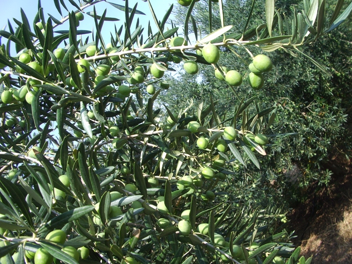

I the fifth pic is an example of what a fantastic crop you can get from a well prunned olvie tree. See how many leaves there are on the branch and how healthy and green it is. If you don't prune, the branches keep growing outwards but towards the center of the tree where the branch starts it is all wood and no leaves. that doens't produce olvies.
