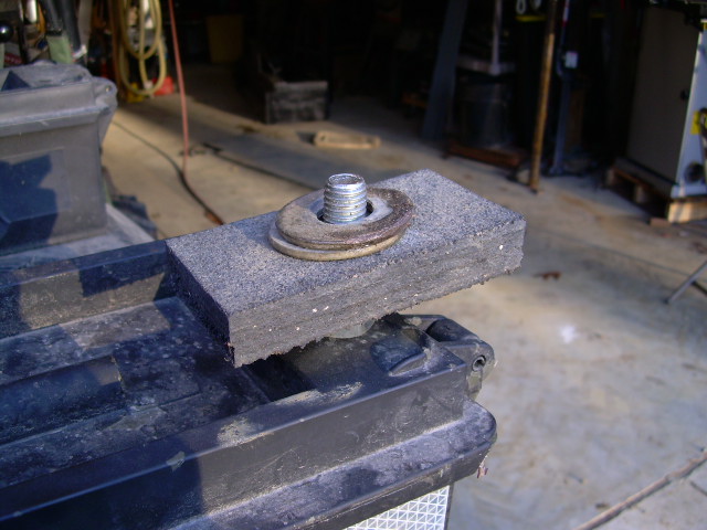

Glad you got the brush hog going, but I got some discouraging news for you.... the grade 8s seem to snap just as easy as the grade 5. I've snapped several. The brush hog has tremendous forces.:eek:

I HAVE BROKEN THOSE BOLTS TOO. I WAS ABLE TO DRILL THEM AND USE AN EASY-OUT TO EXTRACT THEM. IF YOU CHANGE TO A HARDER GRADE BOLT IT MAY MAKE IT HARDER TO DRILL IF THAT IS THE METHOD YOU USE.

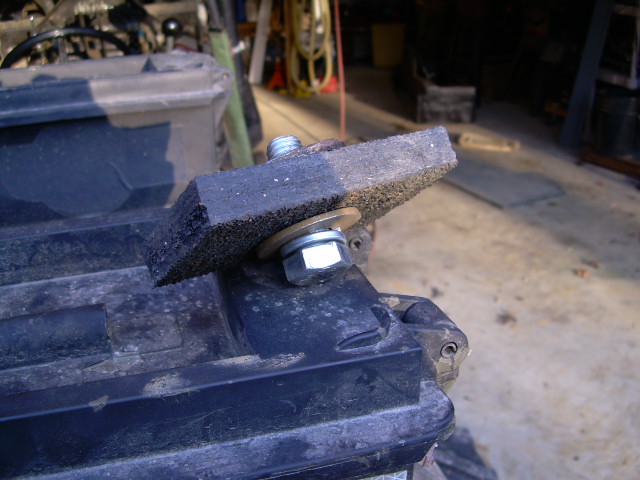

I drilled a 5/8 inch hole in a piece of rubber horse mat approximately 4 x 2.5 inches and 3/4 inches thick. I put the back stop bolts through this with two flat washer against the spindle and one flat and one locking washer against the head of the bolt. If the blade kicks back and slows down over a distance of a couple of inches and not a very small fraction of an inch the stress should be reduced tremendously. Somebody else used tire rubber, but I did not have an old tire sitting around. I just installed this today so I don't know how effective it will be, but it's got to be better. See attached picture.
I put the long side of the rubber towards were the blade will hit.

I think it would have been good to use locktite on the blade and backstop bolts. I seem to find the bolts have loosened a fair amount several times during the summer. I did not do this, but maybe next time I do maintenance.
