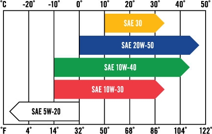

Yes it's the Kohler I just got it yesterday I ran what gas was in it out and put 5 fresh gallons in it after it cools it fires right up and runs maybe the Hydraulic oil is getting hott but I feel like the engine should run at least.. another thing do u know why it has motor oil instead of hydraulic oil just a side thought
