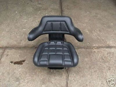

I have read in previous posts that some folks have replaced their seats with ones found at Tractor Supply, etc. I would imagine that an improved seat gives a better "feel" but do they improve the ride?? With the tree roots and generally rough terrain we have I wish the PT had a suspension system!

Tractor Supply does have suspension seats for around $85.00. I have also bought them on Ebay.
   / PT 422 or 425 seat replacement.... #3
</font><font color="blue" class="small">( Tractor Supply does have suspension seats for around $85.00. I have also bought them on Ebay. )</font>
How would you use a suspension seat, when it has to extend out over the hydraulic tank? Wouldn't that raise the seat too high?
Also, the seatbelt attaches to the seat frame on mine, so that could be a challenge also on an aftermarket seat -- unless you got one for a skidsteer which often has seatbelt provisions....
   / PT 422 or 425 seat replacement.... #4
The seat bolts to the same plate as the old seat. This seat comes in non-suspension and full suspension. When I sit on mine, the seat drops about 5 inches and levels off. Don't know about the seat belts, I don't use them for various reasons.

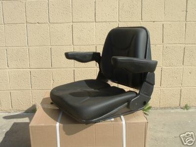

Here is another seat that folds, but more expensive. Around 129.00 with free shipping.

I have that same suspension seat from TSC. I do use the seat belt so I just drilled holes where I needed to in the seat frame and mounted it like it was on the pt seat. I do sit a little higher but thats better for me, better view of attachments and more comfortable to steer. Head is a little close to the canapy though. Flattens my felt hat sometimes when I really get bouncing.
