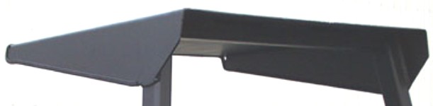

/forums/images/graemlins/grin.gif /forums/images/graemlins/grin.gif I am sooooooo glad that I got the PT-425 with the ROPS Canopy!!!! /forums/images/graemlins/grin.gif /forums/images/graemlins/grin.gif
Yesterday, while doing some trail maintenance, I bumped into a dead tree, which was 8" in diameter and 38' tall with no branches. After a two second delay there was an extremely loud boom directly over my head!! I soon learned that the 2" by 32" top of that tree had snapped off and landed on my PT-425 Canopy!!!!
If I had purchased a PT-180, or PT-422, perhaps today someone else would be writing, and it could very well be my obituary!!!! /forums/images/graemlins/shocked.gif /forums/images/graemlins/shocked.gif
Most folks only think of ROPS for roll over protection! Some folks think: "Flat land, don't need it!". Many CUT just have a simple bar ROPS with, sometimes, a cheap plastic sunshade!! There are other dangers, however, and the solid steel protection of the PT-425 ROPS Canopy may have been literally a life saver for me!!!! /forums/images/graemlins/grin.gif /forums/images/graemlins/grin.gif

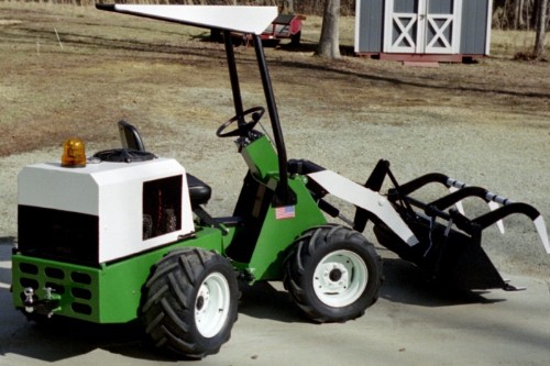

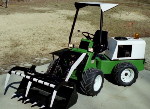

   / PT-425 PROS & cons??
Re: PT-425 PROS & cons??
con: Power Trac Black Canopy
/forums/images/graemlins/mad.gif Problem: The Black Paint on the Canopy of my new PT-425 is extremely poor quality. It is hot to the touch and radiates heat onto the driver. Another color would also be more visible when working in or near a road.
/forums/images/graemlins/cool.gif Solution: I repainted the Canopy with two coats of Valspar Anti-Rust White Satin Enamel, which, after curing, is hard, smooth, tough, and more visible!! I used a 3” wide Roller which is quick and easy while producing a nice hammered like finish without brush marks or overspray. The underside of the Canopy and the ROPS were repainted with two coats of Valspar Anti-Rust Black Satin Enamel.
Attachment: White Canopy.
/forums/images/graemlins/grin.gif /forums/images/graemlins/grin.gif /forums/images/graemlins/grin.gif /forums/images/graemlins/grin.gif

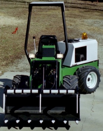

con: Power Trac Headlights
Problem: The PT-425 OEM Headlights are round, old fashion, dim 35W sealed beams, and kind of frog-like!! The lift arms hit these lights when fully raised !
Solution: I replaced the PT-425 headlights with: PM V502HF Flood Beam Utility & Tractor Lights which are 3"x5" rectangular, modern, bright 55W halogen, and kind of cool!! Being slimmer these lights clear the lift arms!
Install new lights in the original mounting holes and wire to the original switch.
Attachment: New Bright Lights.
