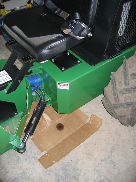

I'll try and post a photo later today. I've put cardboard under the PT just to confirm the source as at first I had theorized it could be a leaking cylinder seal....but it would have been quite a leak to cause fluid to spray onto the underside of the tub! On the flip side, that would have been an easier fix.

My 422 is doing the same thing. I did confirm that it is leaking from a weld on the hydraulic tank. I wiped it dry, layed on the floor and watched. A few minutes later I saw oil seeping from what looked like an imperfection in the weld. /forums/images/graemlins/crazy.gif Called Terry at PT and he said he would fix it if I brought it down to Tazewell. Probably can't do that soon. He recommended taking a center punch to the imperfection then arc welding over it. I don't know too much about welding so maybe one of the experts will chime in. Thanks in advance.
   / PT 425 tub is leaking
I think Terry's method really depends on what your leak point looks like. I think you need to grind down the area first (you'd have to do that anyway in order to weld) and then re-evaluate. Goes without saying that you need to empty the hydraulic tank first (what a drag). The center punch is probably just to make the hole a bit bigger and more uniform so that the weld will stick.
Here is photo 1 of my issue. This one details what I was looking at when I discovered the problem. That cardboard has only been down there for a few hours.

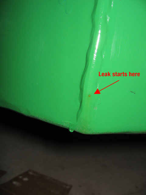

This photo shows the source of the leak. It looks like a little spot of rust but looks can be deceiving. Who knows how well the paint is managing to hold back a bigger problem.

Do you have a friend with a portable A/C wire welder? If so, just drain the oil into a clean, sterile container with lid. Set it aside. Wire wheel off the area about an inch around the leak. Grind the leak just a bit. Have the welder tack the spot. Grind it down a bit and tack it again just to be sure. The reservoir is not pressurized, so you wouldn't have to penetrate very deep at all. Put the oil back in and test. Shot of primer, shot of JD green and you are done.
If you end up draining the reservoir, remember to bleed the tram pump after you re-fill it just in case the feed hose to the pump sucks air when the tank is drained.

Actually, a good welder would not even drain the tank. The heat will not be on there very long. You will probably not get any more heat in that small area than a cooking pan with oil on high heat. Cost should be minimal.

Clean is good if you can do it. With what I see, I think a good welder with a MIG can fix that small spot in about 30 sec.
Prep will take the most time. You might try what Terry suggested, take a center punch and see if it will stop the leak, or ball peen that area. I would only take action while at the welding shop in case it gets worse. Whether it does stop the leak or not, you can still weld it. If you have done any welding before, you will notice that the heat will burn paint and char oil, and just about burn anything in the way. They can weld under water and into crud much worse than this.
