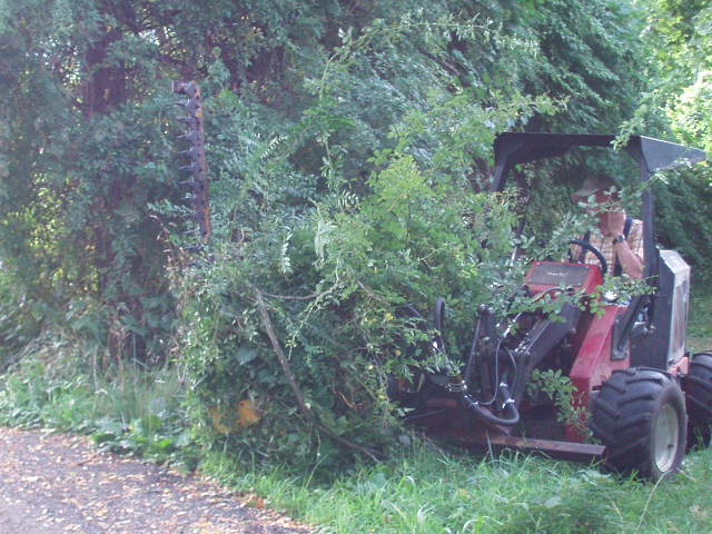

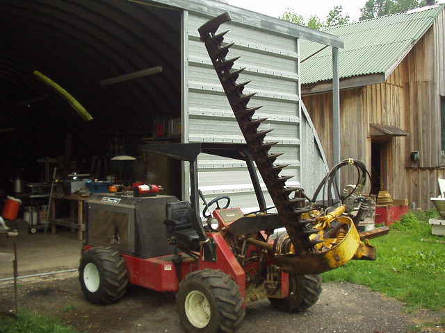

A few years back I started to build a boom mounted string trimmer for horse trail maintenance. I gave up when it became clear it wouldn't do the job. If it stays together, this one will.
But, as the second picture shows, it still may be considered work.:(

Looks awesome. I haven't seen a sickle bar mower in 20 years. Is it driven by a hydraulic motor?
After enlarging the photo, I see the hydraulic hoses. How big is the hyd motor?

The motor is one we had lying around which came off a county brush hog. I don't know exact size, but we put a variable valve in to control its speed. We use it at near dead slow. The sickle bar was originally a John Deere belly mount PTO unit. On the PT it will cut horizontal from ground up to 6', and vertical from ground up to 11'. And, of course, any angle from horizontal to vertical.

Right now, it twists pretty hard to the right. We plan to put about 200 lb. on the left side.
