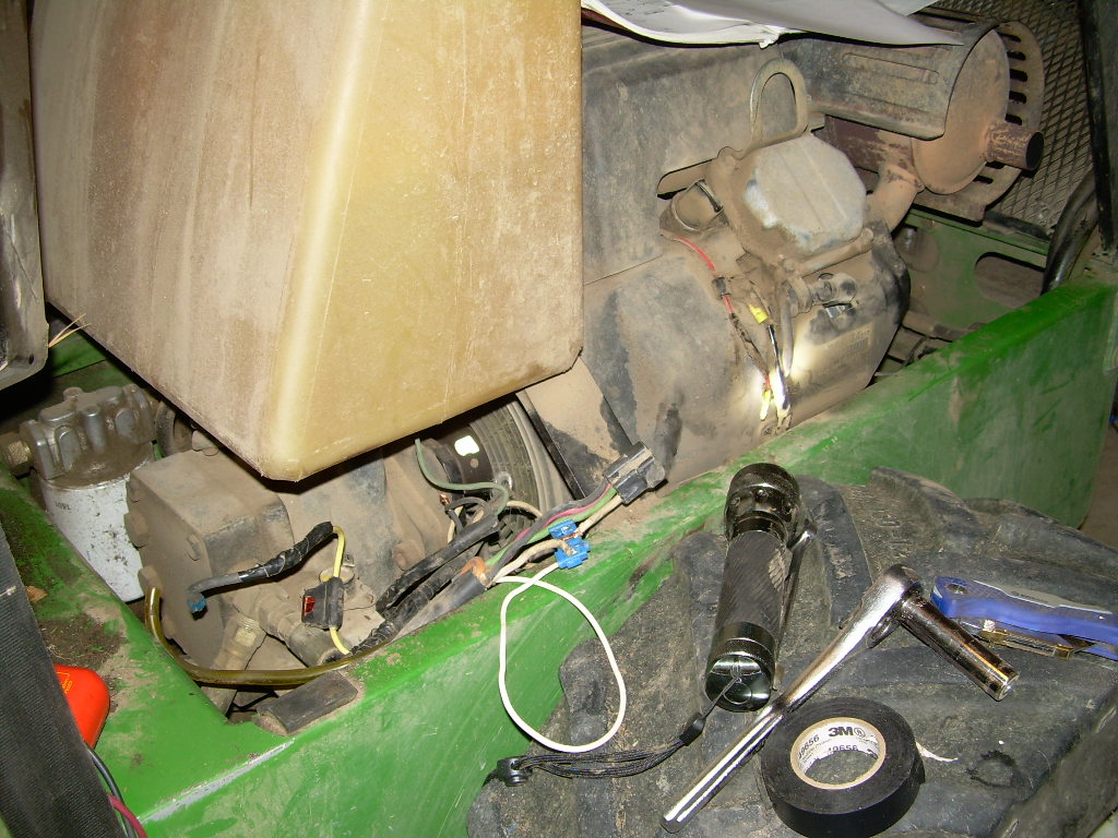

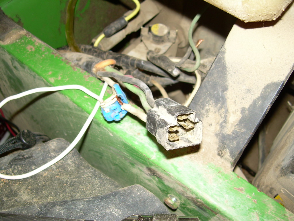

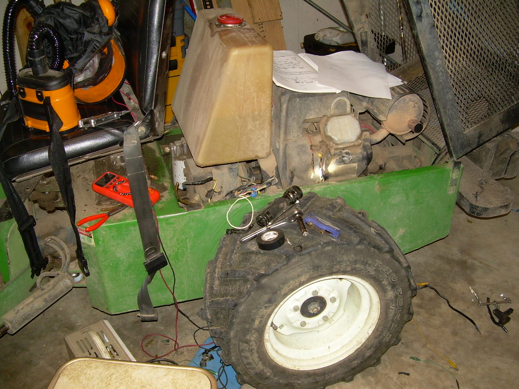

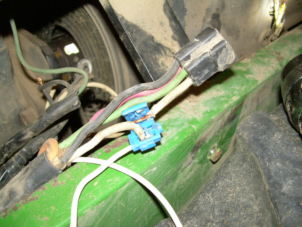

Well today I noticed that the green light on my cooling fan monitor did not come on. I check the fan and it was not running. I checked the hydraulic reservoir and it was very hot. Anyway, after several false starts, I traced it down to an insulation piercing connector (I call them devil clips). It was connecting the wiring harness to the power wire for the fan. This is located on the left side of the PT. I took it apart after cutting through two layers of heat shrink. I removed the devil clip and soldered the wire in place.
These devil clips are about the poorest excuse for a connector I have ever encountered. I have had two fuse holders (which use the same insulation piercing technology) fail, plus this recent failure. I should remove them from my trailer, although none have failed yet. I have seem problems on other trailers and vehicles.
Too get to this wiring harness I had to remove a strap that was bolted to the side of the PT. Then I unplugged the connector from the harness to the engine. I have about 700 hours on the PT.

   / PT422 Cooling Fan Problem #2
Sorry your fan stopped working, but glad your light alarm worked.
I feel fortunate not to have had many problems with the "diablo" clips
Thanks for the pictures and description of your repair.
   / PT422 Cooling Fan Problem #3
My fan stopped working last fall. I did not need it this winter and I haven't mowed the lawn but three times this year. I needed to do some heavy work a few weeks ago and went to track down the fan problem. The fuse was good so I suspected the thermostat. But I found that I was not getting 12V to the thermostat, let alone the fan. So I temped the fan directly to 12V and it works. I traced the wire back to that taped bundle and decided not to proceed at that point. :) It will be arainy day project.
   / PT422 Cooling Fan Problem #4
Please, please, tell me that is not factory.

   / PT422 Cooling Fan Problem #6
unfortunately, it probably is. My wiring harness doesn't have any devil clips in it, but it doesn't really appear that any real planning went into wire routing in the engine compartment, and no wire bundling/protection was installed. There are a couple fuses installed inline in wires; no central fuse block/terminal block was used.

   / PT422 Cooling Fan Problem #9
As the old saying goes (well, not that old) "Been there, done that."
Bob Rip, I had to do the same thing. Only, it probably took me longer than you to find that bugger (oophs! Satan snap). The hardest part is getting your hand in there to get to it.
Also, when I put the connector from harness to engine back together, one prong did not line up correctly...but made just enough connection to make a 'bad connection'.
It would start (the PT) but then 5, 15, maybe even 20 minutes later it would just die. That connector was the problem. Once I straitened the blade back, to fit right I didn't have any problem.
That is...after I took apart quite a few "grounds" to clean and make sure they were tight...because that is what I thought the problem was.
