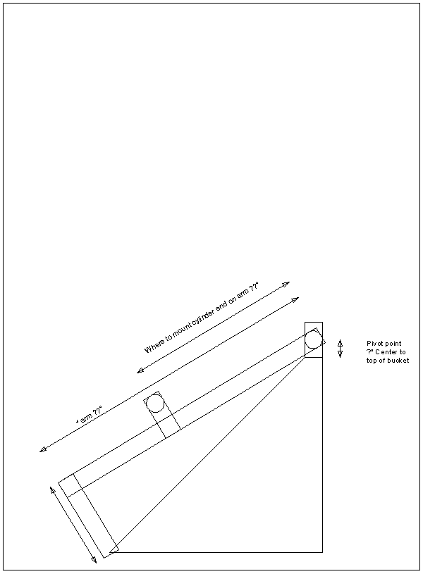

OK. I'm too cheap to buy the PT grapple bucket. However, I'm not too cheap to build my own /w3tcompact/icons/laugh.gif
Here's what I have planned.
I will build the grapple out of 2 inch wide by 1/2 inch thick steel. I'll put two next to each other about 2 inches apart, on edge. Then I'll put one on each side near the width of the small bucket. I'll put one more between the center ones and the outside ones. I'll connect them all by running 1/2 inch threaded rod through holes that I'll drill every so often(haven't decided yet) and bolt them into place. Taht way I can fudge the spacing until it works properly. Probably 3 or four rods. I'll use CAT2 pins to hold it into CAT2 3pt hitch ends welded to the bucket and secure it with lynch pins, which will make it removable.
For the hydraulics, I'll use a cylinder with an 8 inch throw. It should give me about a 90 degree opening to the bucket. I still need to figure out how to attach the cylinder to the bucket and grapple. Might use 3pt ends and pins for that as well.
As for the fingers or teeth, I'll experiment with different lenghts of 1 inch by 1/2 inch steel. I'm still putting it together in my head, but have purchased some parts from TSC today.
Two each of 3pt ends, pins, bushings and lynch pins for $37.00. If I plan it correctly, I'll be able to get away with under $200.00. Also, with a little planning and some extra 3pt ends, I'll be able to use it on either the big or small bucket.
Any pictures or links to any existing grappels on buckets of any brand would be appreciated.
I'll make a drawing later in the week and post it as I go.
So what do you think? Can we do it?

mr. m.r., if you can do it try to make two pistons, and two independent parts, so if on one side the contends (load) is smaller than the other you don't loose the side that you are not able to close completely. that is the only drawback with th pt grappler. another addition we already made to reinforce the teeth and keep some of the looser stuff in the grappler such as leaves and twigs we added flatiron about 13 inches apart. this keeps the loose stuff in very nicely, i used it loading all kinds of manure.
good luck

nothing that small, that is why i suggested to make two separate pistons. after practicing for a while you will be able to pick up individual twigs with the teeth and slide them back into the bucket without disturbing the soil/turf. if you look at your digging bucket the pipe that the grappler teeth are attached to is about two inches higher then the top of the bucket. to me the teeth are a perfect circle from that pipe to the front of the bucket, but don't quite touch the bucket.
there are three teeth. i would add a fourth tooth and make the two sides independent from each other for the reason i mentioned before.
good luck
hrl

Let me get this straight.
You'd make two halves.
Two fingers per half.
One cylinder per half.
Plumb the cylinders in parrallel.
Pick up something eneven, like a fat ended log, and both halves will close down on the object. Sounds cool.
I want to start with a minimum of parts and $$$ The way I'm making it, if I want, I could split it down the middle and add the second cylinder later as well as the two additional pivot points.
By the way, what size cylinder does yours use? Does it look similar to any of the cylinders on the PT425, the quick attach cylinder, or any other PT implement, or is it a completely different size?

Attached is what I've drawn so far. It is a side view of the grapple. The attachment is of an annimated gif file. It is bigger than the screen, but is only 14K in size. Let it load. It changes every 2 seconds, then repeats. I haven't decided on lenghts or where to connect the hydraulic ram, as I've got no experience as to the best mounting points, best leverage, etc..., but its getting there. Now I just have to find some steel /w3tcompact/icons/smile.gif Not this weekend, as we have family stuff going on.
