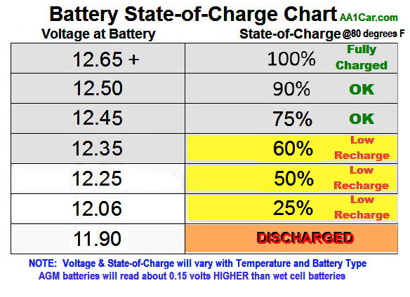

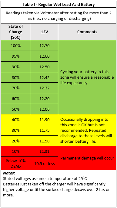

it's my understanding that 12.6v is considered fully charged so we are not that far off at 12.58v
13 is charged, not 12.6. Better recheck your specs. How old is the battery anyway and have you ever cleaned the terminals?
