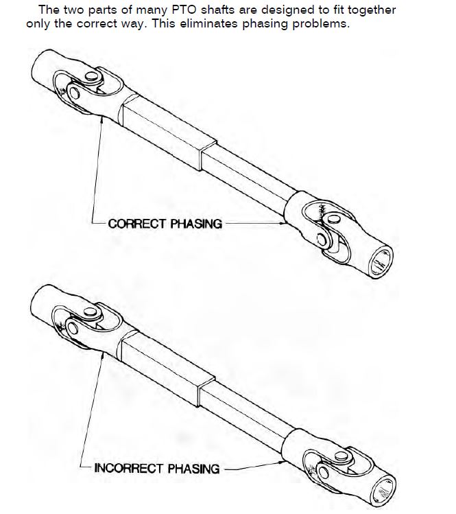

However - split the PTO shaft into two parts and there is only ONE way it goes back together. The actual shaft is square. One side of the square being longer than the other three sides. This forces you to reassemble the two halfs in one specific configuration.
When the PTO shaft splits into two parts (and normally telescopes when assembled) they need to be reassembled in one specific configuration ("in phase") so you don't get uneven speeds and wobble.
I'm not sure if this applies to OP's situation as it seems he's trying to put a PTO shaft on spline.
Picture would help.
I'm not sure if this applies to OP's situation as it seems he trying to put a PTO shaft on spline.
Picture would help.
If phasing is the issue (as indicated by the drawing you posted) I wonder why phasing would be important on a bottom mounted PTO, but not a rear mounted PTO? I've never seen this on a rear PTO.
- djb

...but are there universals joints (u-joints) that need to be connected "in phase"?
That is, are you connecting two sections of one (1) PTO shaft together?
I thought not. I thought you were connecting one yoke end of an assembled PTO shaft (hopefully "in phase" with itself) to tractor's spline?
Phasing is required between opposite ends of the PTO shaft (Shaft is required to be in phase with itself.)
No "phasing" is usually required between the pto shaft and the fixed tractor spline
Phasing is important on any PTO shaft (bottom or top) or drive line that has u-joints at each end.

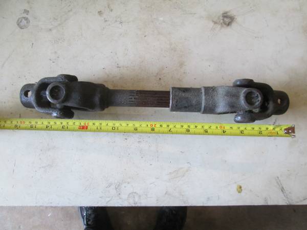

Just noticed the square PTO shaft in the pic. The shaft on this mower deck is, indeed, splined, not square.
Maybe "PTO" is not even the correct terminology.
I'm referring to the shaft that drives the belly mower. It would look like pic below if totally removed, I am just dealing with separating the splined part of the shaft:
Sorry, and thanks for the responses.
- djb

Ah, OK, I see what you're talking about...
What I'm doing is not like connecting an implement to rear PTO. I'm separating the shaft. It may be that the PTO shaft of, for example, my bush hog, does have a specific orientation to slip the thing together. It's been a long time since I've had one apart.
So this means I'm stuck with having to get that :censored: shaft together in a specific orientation.
Thanks again. I think I got my answer. User error. :laughing:
- djb
   / PTO Alignment(?) #10
For others following along:
Yes, the splined male/female parts of the 2 shafts that slide together at the 7" mark have to go together so that the two universal joints at the end are "in phase" with each other (as shown).
The yoked ends of this shaft can then mount to the tractor's or mower deck's pto shaft (spline) in any orientation. Just like with a rear PTO.
Yes, I'd bet the 2 sections of your Bushhog's pto shaft can only be slipped together in one orientation.
Yep, you're stuck cursing for an hour.
