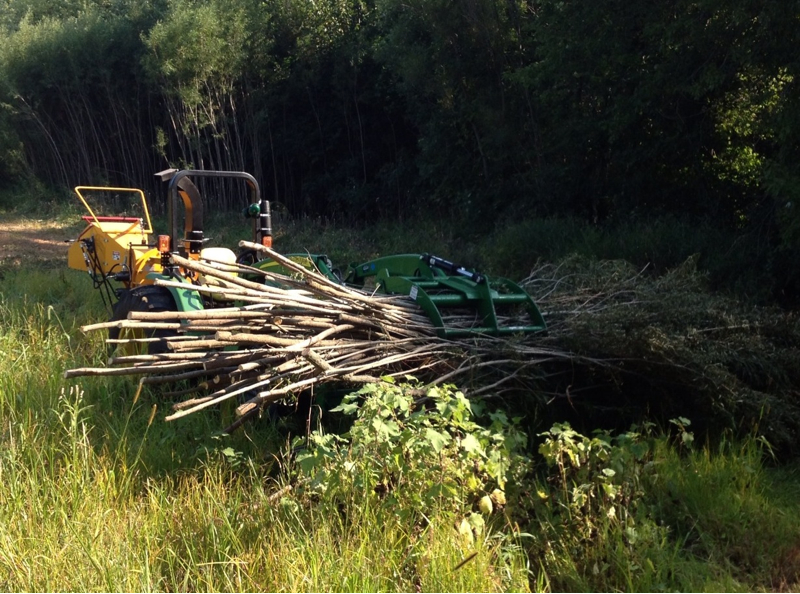

I also have the 8 inch Woodmaxx chipper with self contained hydraulic feed. Can not testify to a long life, because I have only had it for one year, but I'm very happy with it so far.
