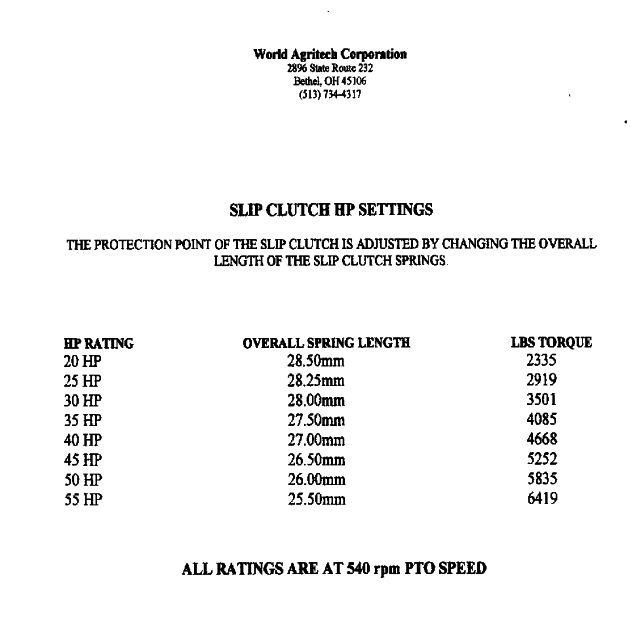

I'm buying a Kubota L4400 and was looking at tiller options. It was my understanding that you would have to have enough hp to run certain equipment, but now I'm hearing conflicting advice going the other way, to equipment that has lower hp requirements. With the 37.5 pto, would there be a problem operating the Woods tiller that recommends "up to 30hp"? I had one cautionary comment about the torque, but others think it will be okay. I don't want to buy new equipment and destroy it. Does anyone here have any advice/experience?

No. The instructions more likely state to set the clutch spring length according to the tractor'sPTO hp rating. In this case, the implement only has a 30hp rated transmission. Setting the slip clutch per instructions will still result in his 37.5 PTO hp being delivered to a 30hp rated tranny.
Correct solution is to replace the implement with one that is sized to the tractor.
Slip clutch solution - in this case only - is to set the slip clutch springs to match the implement hp rating.

   / PTO Compatibility #6
</font><font color="blue" class="small">( I set my slip clutch by loostening all of the nuts on the springs, setting the tiller to full depth, slipping the clutch. After the clutch slips, I turn the nut in to touch the spring and 3/4 turn more evenly on all 6 springs. I have never had the clutch slip past this point )</font>
I wonder if you haven't actually defeated your clutch's ability to slip at all Chris? I see your clutch is 6 springs, so I don't know if my 8 spring adjustment numbers will work for you. You're welcome to take a look at the attachment anyway.
Looking at the chart you'll see the shorter (tighter) the spring, the more torque is required to slip the clutch plates. More torque equates to more HP. Therefore - assuming correct implement sizing - you adjust the spring length (tension) based upon the PTO hp of the tractor to which the shaft is connected.
With regard to your "3/4 turn method", please note that the entire 20-55 hp torqe range is contained within only 3mm of spring length adjustment. That's over 4000 ft/lbs of torque being controlled withing a spring tension difference of slightly under 1/8 inch.
//greg//

After some thought I can see that the 3/4 turn setting could indeed defeat the clutch on mine. Don't think there is any way to tell until the tiller snags on something hidden. I have a Howard HR-8 in,57" or so wide. Manual does give a OAL for the springs to be set but not a torque setting. Springs are tired and the spec is almost longer than the spring is loose. Guess I need new springs. But my tractor is 30 HP at the PTO, and the box on the tiller is 45. Think even if the slip clutch was defeated with the 3/4 turn setting there would be no danger to the tiller, would stall the tractor first. Full depth on mine is 6.6" and I always till at full depth. At full depth there almost isn't any load on the tractor, can hardly tell it is working in ground that hasn't been broken in 5+ years. This slip clutch setting thing could become a big issue with a 100 HP tractor and a tiller with a 45 HP gear box.
