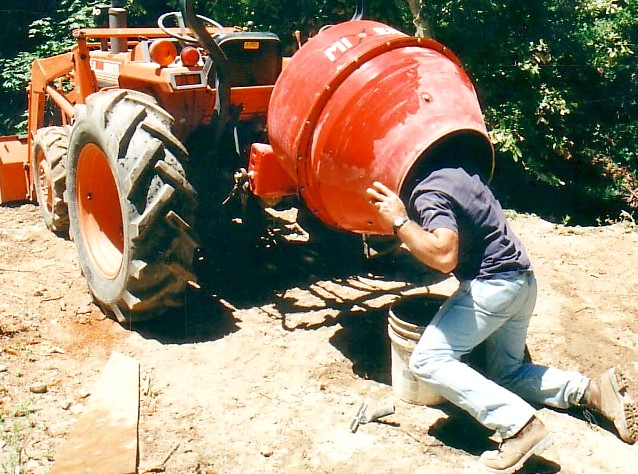

If you searched for PTO mixer threads, you have prob already seen my
comments. I will try not to repeat myself (too much).
I have seen the Eagle and it looks similar to my Italian-made Mixer80. I
have not measured the volume of mine, but you have a very good point.
The actual total drum volume is way more than what you can actually
mix. Also, the most efficient mixing will happen with the drum nearly
horizontal.
It still amazes me that these units are sold with SA cylinders. DA is
clearly needed and I have tried it both ways.
AgriSupply sells the Mixer80 for $600 plus shipping. I have not seen a
bigger one for the 3pt. I think hydraulic is a good way to go, but you
are looking at 4x the cost. Hyd allows you to reverse the drum and
mount it on the your loader. No PTO hassles, either.

That is a nice helmet....... but what does that have to do with PTO mixers????
That's my better side. If I can fit MY head in one of these mixers,
it gotta be big......
.....and SCHMISM, a cy is 27cf, last time I checked......
