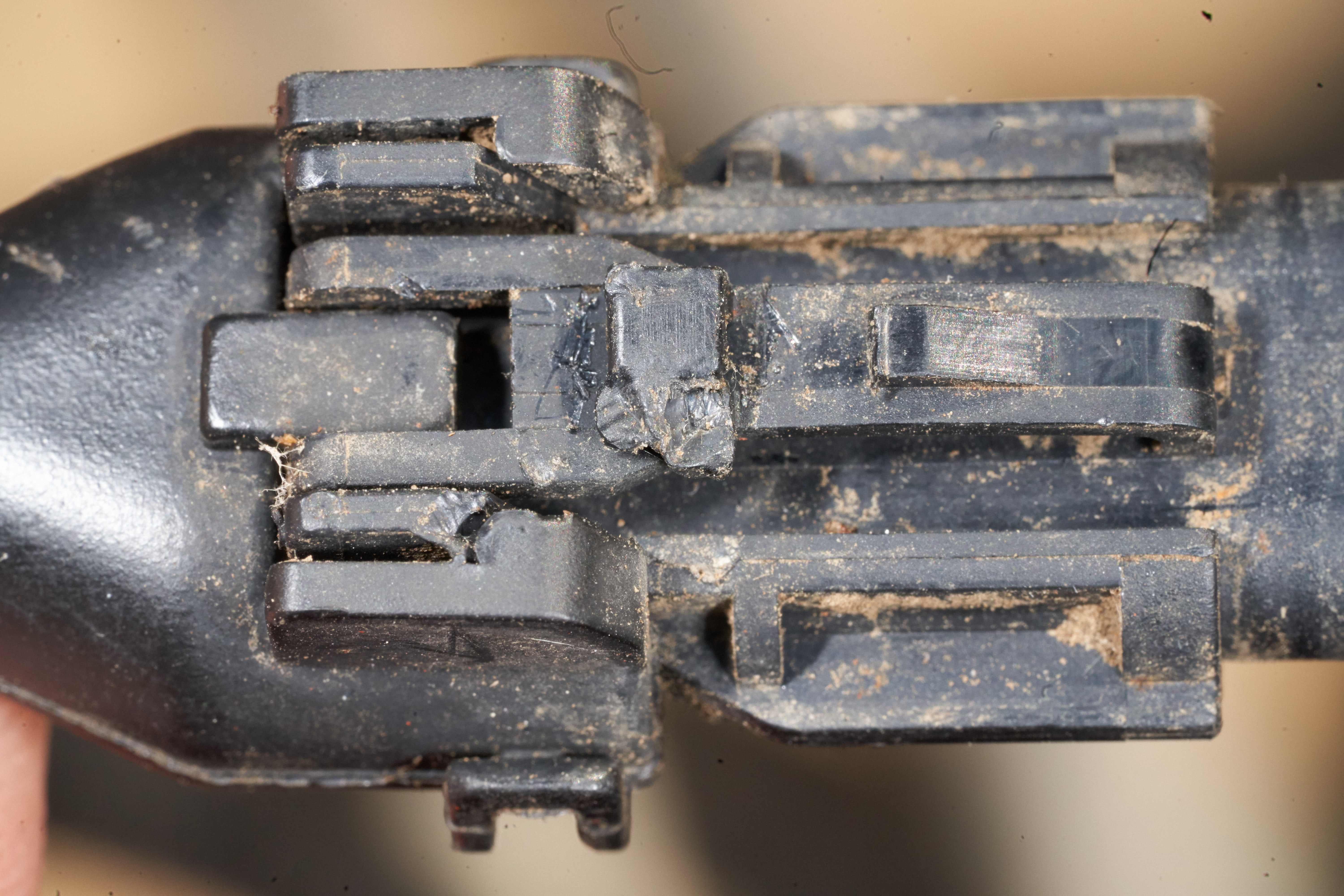

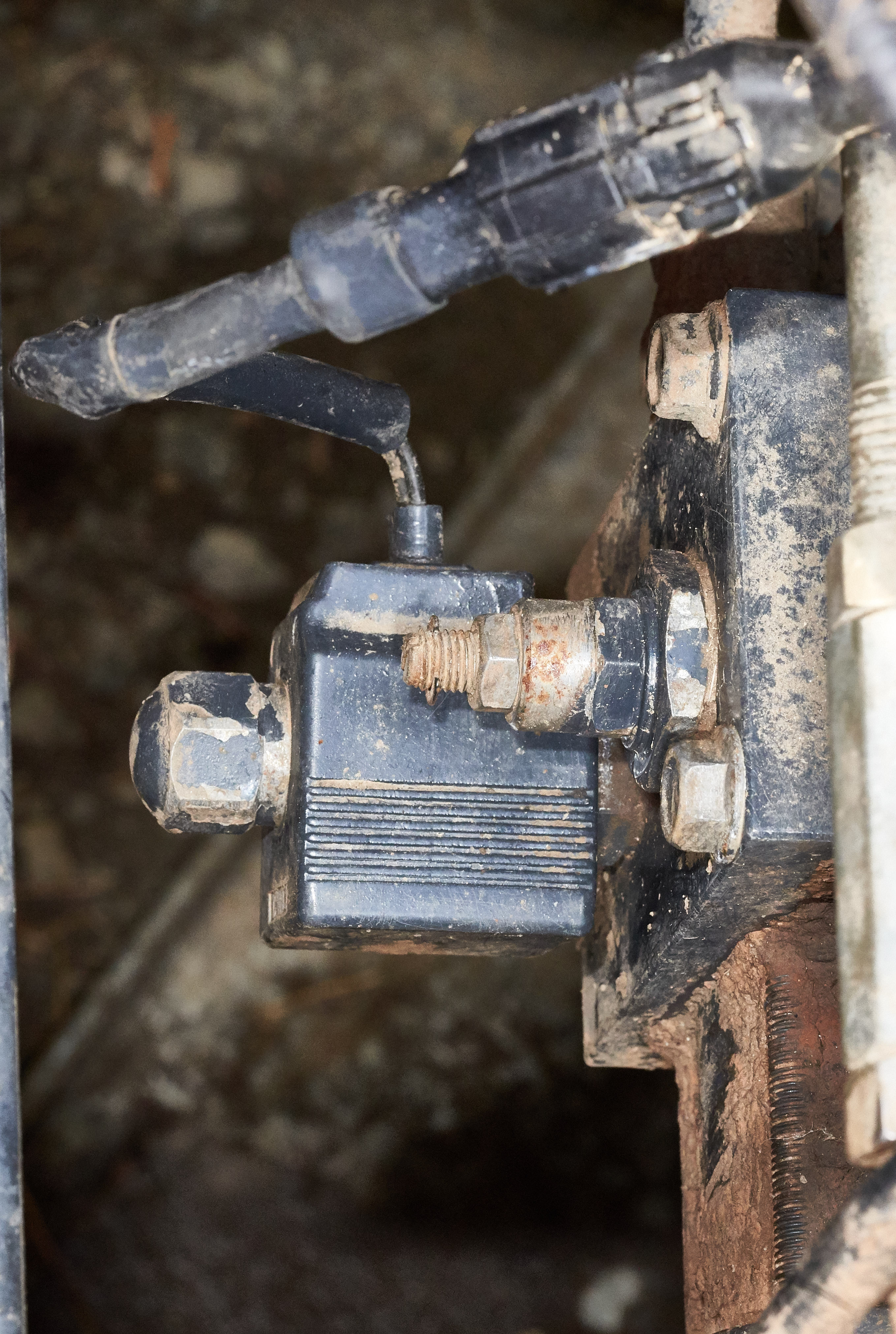

I'm still trying to get my PTO to run. The speed selector lever is stuck in neutral, and the trouble is not the linkage, as I've lubed it and can see it straining as it tries to rotate the shift shaft. Since I thought maybe it's stuck because the PTO clutch is not engaging, I did a little more diagnostics on the PTO valve. I verified that the PTO solenoid is getting +12v properly, and the resistance of the solenoid is 7 ohms which seems right (~25 watts). But I don't hear or feel any click from it when switched on or off. (I do hear the relay clicking on and off properly.) I can see that someone has done this previously judging from the mashed release button on the connector. See the photos below.
Is the PTO solenoid supposed to click when switched on and off?
Thanks as always!

Most solenoids or relays do click when power is applied then again when power is removed. When power is applied a coil of wire is energized and becomes a magnet. It pulls a metal piece against spring tension making a click when it hits the end of its travel. Turn the power off the magnet turns off and the spring snaps the piece to the other end of its travel. You can have burned contacts or disconnected wires but as long as you can apply and remove power to energize the thing something mechanical will move inside.

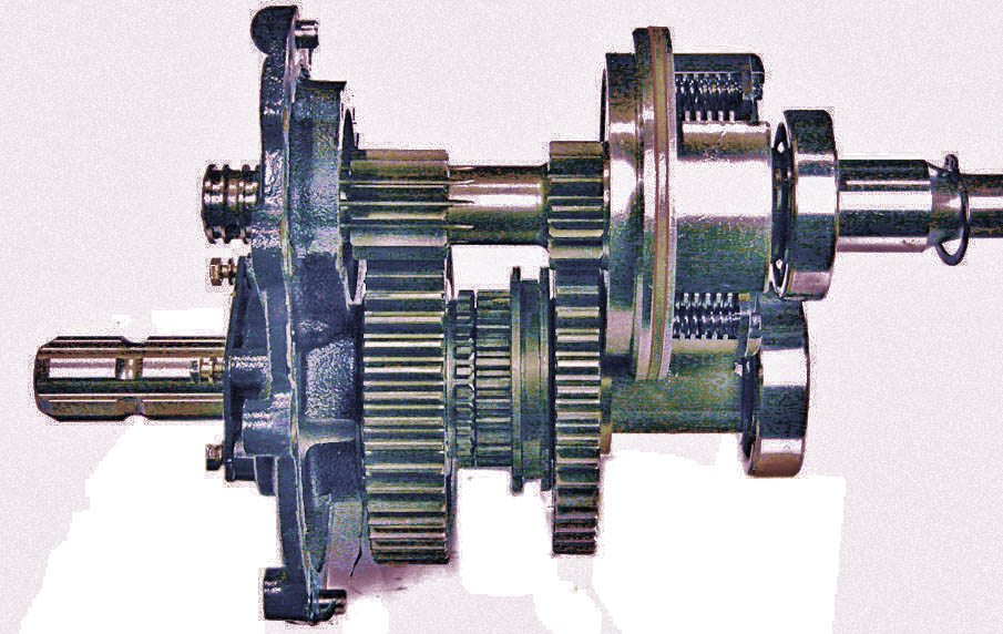

The stub rotates freely. Assuming that the gear train is intact, it only means that the output shaft and selector collar are free to rotate. The shifter remains frozen. The splines on the shifting parts are beveled so that they can slip easily into gear, and the stiffness of the shifter implies that the collar is stuck on the output shaft since there is some free play between engagements. See the photo below, taken from the 2014- service manual which is much better than the pre-2014 manual which is a damaged pdf file, and is not very comprehensive. In the photo, input power enters the input shaft at top right, passes through the hydraulically actuated clutch, and drives the pinion gears which are in constant mesh with the speed gears. The collar on the output shaft slides left and right under control of a fork (not shown), and links up power to one of the two speed gears.
The PTO solenoid valve is a whole different problem. Does anyone know what type and size the hydraulic flare fittings are on the PTO valve, in case I wanted to put a gauge on it?

Yes, the splines are beveled but most of the times, it's still somewhat hard to get it into gear. Quite often there is the need to bump the PTO switch, to move things around and it then falls into gear.
Can you see the shaft that enters the transmission from the shift lever to the fork inside, moving?
Usually, if the PTO is ON but in Neutral, you can hear a slight rattle coming from the gears, collars, etc. That should give you an indicator if the PTO clutch is engaging or not.

ptsg, I get perfect radio silence from the transmission and PTO valve when switching on and off the PTO. (And I know the electrical is switching correctly.)
Yes, I can see the shift shaft, and yes I can see it moving slightly as it strains to try and move the fork.

Thanks for the questions. The light does light up when the PTO is switched on. The positions are LINK, OFF, and IND. LINK turns off the PTO with the lift raised or the clutch depressed. IND turns on the PTO whenever the key switch is on. And I've verified that +12v is going to the solenoid valve when switched to LINK, and not when it's off. Also, I can hear the PTO relay clicking on and off correctly. (Also, the starter is disabled by another relay when the PTO is energized.) The solenoid shows 7 ohms resistance.

   / PTO diagnosis
Problem solved. The fork shaft was seized due to disuse and too-tight clearance. The linkage was not strong enough to break it loose. But luckily, there's a back door to the fork shaft that is accessible at the rear of the tractor under a little plastic cup seal. Just take a long brass punch and 5-10 lb sledge and you can start to move it. You'll feel it bottom out, and the lever will be in the low position. Then go the lower bell crank on the linkage, remove (or break off) the zerk fitting to make room for a huge pry bar. Move the lever up with a big effing pry bar. The roll pin is pretty strong, and I was surprised that I didn't shear it, although I think it would have broken if I had not broken loose the shaft first. Run it back and forth while spraying Tri-Flow lubricant, and it should free right up for you. I'd recommend exercising the lever monthly when not using the PTO to keep your options open. Hats off to Jared of Dave's Tractors for this fix.
