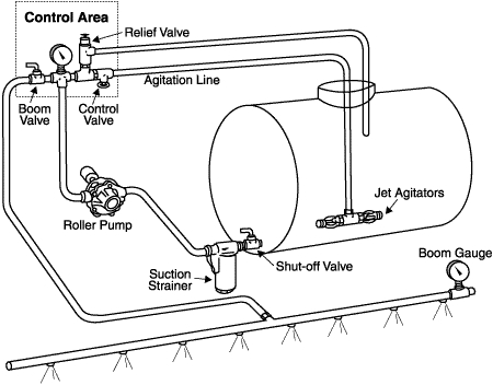

The roller pump is a positive displacement device. That is ... if you dead head or block the flow, something has to give. Either a relief valve or pressure regulator. If you don't allow for over pressure, it will be expensive or dangerous or both.
usually a pressure regulator is used with the excess flow going back to the tank. The diagram you posted does not have any relief valve shown. The system as shown is dangerous. Close the agitator valve and the boom valves = dead headed system.

Thank you. I found a better diagram that reflects what you wrote : I'm hoping the pressure relief valves aren't as expensive as what I have found so far..

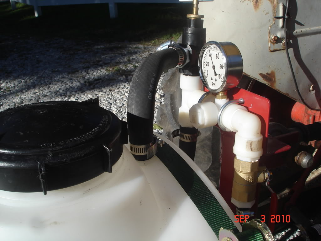

Here's my home built sprayer. Pump is a Silver Series 6 roller Hypro, PTO driven. Suction and discharge from the pump is 3/4" hose, plastic manifold piping, solenoid valves, and relief valve and discharge hose are 3/4" ID. The relief discharge continues to the bottom of the tank and functions as an agitator, keeping the solution mixed. The boom and wand are fed with 3/8" hose. The flood tips I use spec a recommended pressure of 40#, @ 20" above the plant. To achieve this pressure, I start the pump running with the valves closed and adjust the relief to about 44#. When the valve to the boom is opened, the pressure levels out at 40#. When using the wand I adjust the pressure to get the distance of spray I want. Here's a link to the relief valve, it was a little cheaper a couple of years ago. Hamilton Pressure Regulating Bypass Valve, Nylon, 3/4 in. MNPT Inlet x 3/4 in. FNPT - Tractor Supply Co. . The second picture shows the distance sprayer will reach when the wand is dialed down to a stream. About 40'. Mark

Here's my home built sprayer. Pump is a Silver Series 6 roller Hypro, PTO driven. Suction and discharge from the pump is 3/4" hose, plastic manifold piping, solenoid valves, and relief valve and discharge hose are 3/4" ID. The relief discharge continues to the bottom of the tank and functions as an agitator, keeping the solution mixed. The boom and wand are fed with 3/8" hose. The flood tips I use spec a recommended pressure of 40#, @ 20" above the plant. To achieve this pressure, I start the pump running with the valves closed and adjust the relief to about 44#. When the valve to the boom is opened, the pressure levels out at 40#. When using the wand I adjust the pressure to get the distance of spray I want. Here's a link to the relief valve, it was a little cheaper a couple of years ago. Hamilton Pressure Regulating Bypass Valve, Nylon, 3/4 in. MNPT Inlet x 3/4 in. FNPT - Tractor Supply Co. . The second picture shows the distance sprayer will reach when the wand is dialed down to a stream. About 40'. Mark http://s971.photobucket.com/user/briarhhillbrittanys/media/Sprayer003.jpg.html http://s971.photobucket.com/user/briarhhillbrittanys/media/Sprayer008.jpg.html

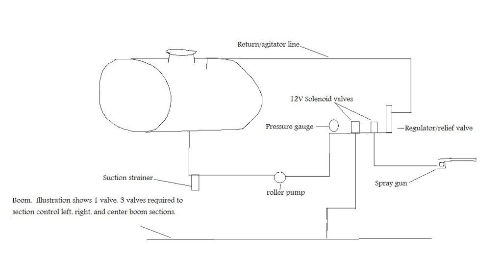

I found those other pictures - the plumbing diagram.. here
now the question i have is - are the pressure gauge and the pressure relief valve plumbed oppositely.. that after the roller pump comes the relief? so the series is:
tank - strainer - PUMP - pressure relief - solenoid (to sprayer) -solenoid (to boom) - guage
lost a bit if thats not the case and.. the solenoids.. they're plumbed by a 'T' fitting.. and the outlet of each solenoid is where the hose drops from 3/4 to 3/8 line

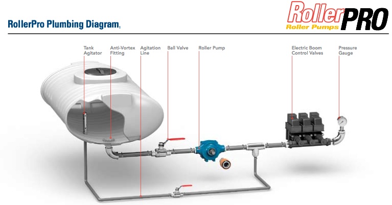

I found this picture after that one..so i'm editing this to throw it in.. must have been version before the above one.. so that as long as the relief and gauge go before the ball valve (or solenoid in your case) we can see the pressure that will be going to the sprayers.. and all plumbs well. got it.
