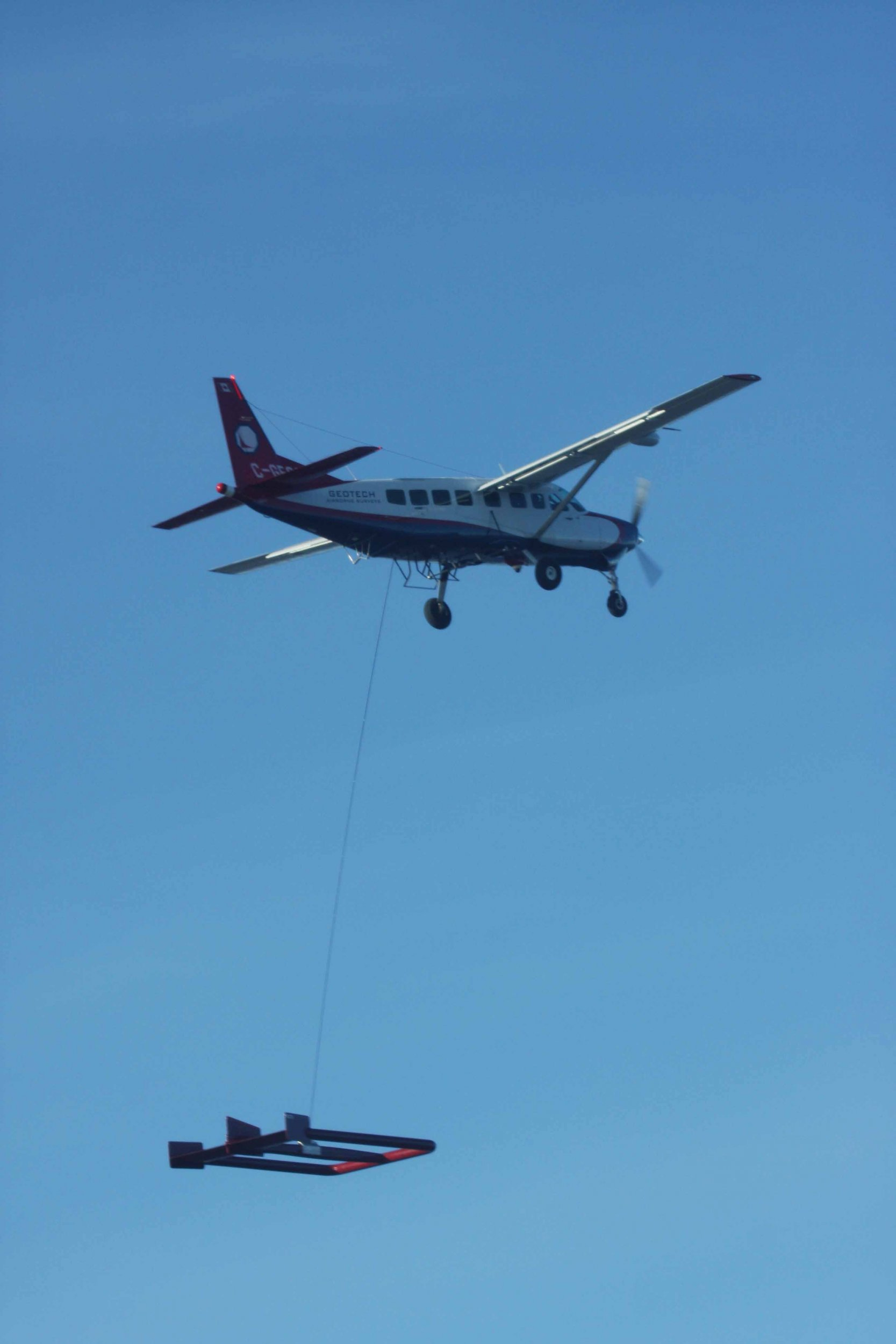

A number of years ago I was responsible for the design and approval of a 10HP winch in both a research DC-3, and Cessna Caravan, airplanes. These winches would lower and raise a 300 - 400 pound towed research/survey "bird", about 300 feet. Another DC-3, which had been similarly modified years earlier, was reported to be unreliable (and winching this thing up by hand when the motor quit was a real chore!). I had a look at it, and it had a huge electric motor, which the airplane electrical systems could not power adequately. The airplanes both had lots of hydraulic power available, which, in fight, was not used for anything else. So I directed the design of engine hydraulic driven winches, which have been very trouble free all these years. If it works on a mission critical multi million dollar plane, it's gotta be able to work for a brush cutter on my tractor!
