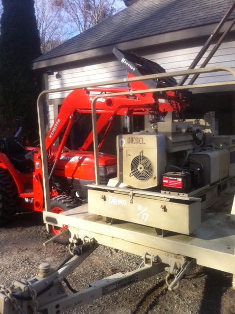

I went a different route. Last year here in Connecticut we got hit with 2 big electrical outage events - a summer storm and then an unbelieveably early heavy snow storm in October. Both time we were without power for 4-5 days. I was looking for a pto driven generator but after those two experiences I decided on a standalone solution.
In both storms I really needed the tractor for cleanup - especially moving & chipping downed tree & limbs. My son who live in Maryland & I both bid on & got government surplus diesel generators from Fort Meade. They are MEP-003A's - 10KW, 4 cylinder, Onan, air cooled REALLY heavy duty units. Mine had 2 hours on the clock since overhaul, Adam's had a couple more. They can supply 10-12KW tho I have to say I have a hard time loading to anywhere near that.
As I have a 400 amp service in my house I searched & searched on Ebay until I finally found a 400 amp manual transfer switch for $250 - brand new :) The genset has been wired in now for almost a year and we haven't lost power for a second. I just get to start it once a month to thoroughly warm it up. Adam got to run his for almost a week this year when that freak storm went through his area.

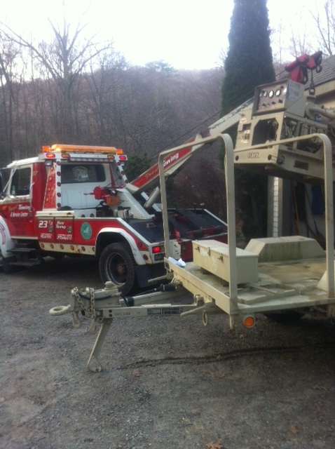

btw they both came on new 3/4 ton trailers. I am debating selling the trailer or keeping it. Lucky they did becaue Adam was able to simply tow mine up to me from MD to CT.
The government is always auctioning these things off
Here I try to get the genset off the trailer - L3400 just too little
Had to get someone with a bigger toy

Those are really nice. How much did they set you back? I would guess Uncle Sam rebuilt them after they had about 16 hours on them.
What voltages do they put out?
At work, in 1995, we bought several Army surplus gas-powered generators which dated to the Vietnam era. All had less that 20 hours on the clock. The voltages were really wierd: three phase 240, three phase 120 and a couple of other configurations I can't recall.
And like you, we got the trailers, which are coveted by the OHV set

Fortunately my son lives close enough to Fort Meade so he could inspect the whole lot they were auctioning (over 20 of these). He picked out about 6 that looked really pristine. Those are the ones we bid on. We got them for abt $2k ea. I am pretty sure I can get $600 for my trailer - it has surge brakes & leaf springs. We really don't know their histories but I can tell you mine had a completely new control box - every wire & screw looks like it was put together yesterday and the generator end looks new also :)
They are dual phase - switchable from single phase 240 v to 3 phase. I just left the switch on single phase and some day will probably go in there & hard wire it for single phase & remove all the other wires & switch.
btw the company I work for sells home standby generators (LP) - a 10kw unit weighs about 330 lbs, these units weigh 1300.
