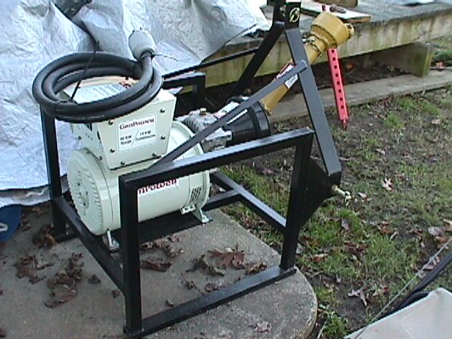

Just sent you a private message... I researched Generators for months before deciding on the PTO genset thanks to the wealth of knowledge from people like SoundGuy and others on this forum.
What I needed was an awesome, "Clean" power solution that would run everything I had and more without any doubts. I did pay twice as much than the Box Store gas unit I was originally going to purchase but it is money well spent.
Have a great day,
John
   / PTO Generator #10
Sorry... I should have mentioned that I went with the GenPower 15/35kw unit. They run about $2500 last time I checked.
