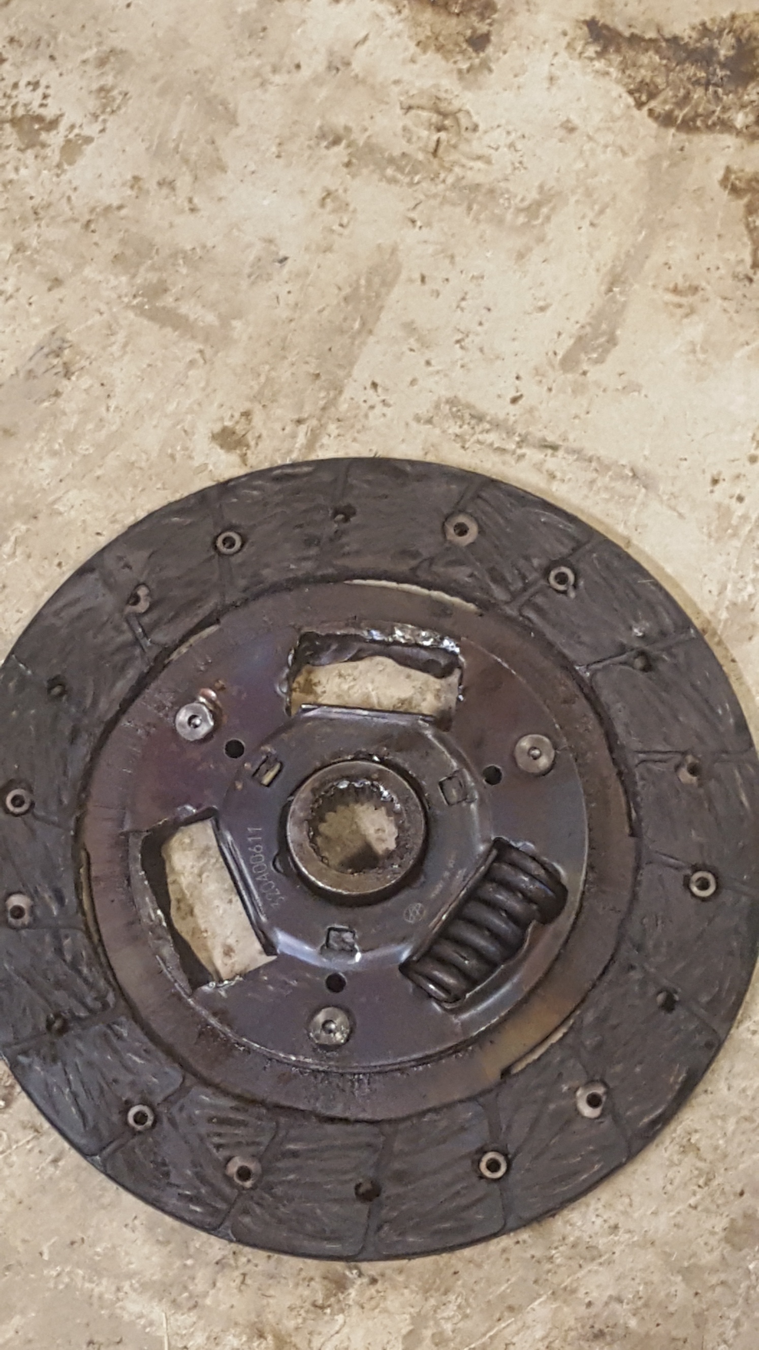

I know different tractor and configuration, but mine starting doing this a couple years ago. I didn't use the rear PTO and bypassed the mid-PTO safety switch during starting. I finally split it a couple weeks back. This is what I found. Works like a champ now.
