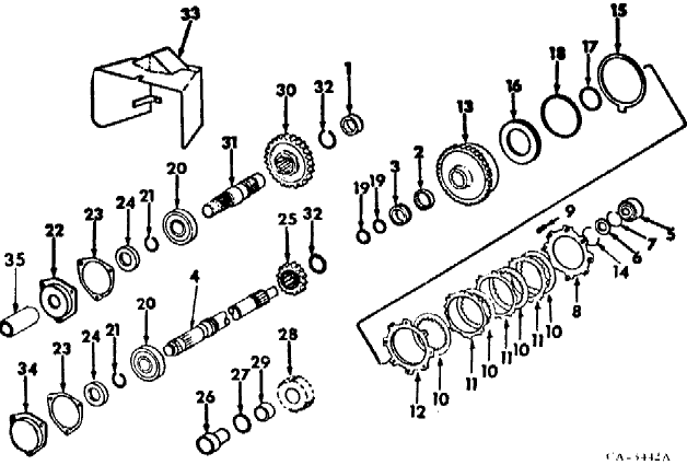

Hey Everyone,
I hope I am posting to the correct place. I am trying to find info for pto shaft removal on an international 464 tractor. I took the cover off the back just as I have with several other models, but when I try to pull it out it just moves about a 1/2 inch then stops. I can't seem to find any exploded views of this pto shaft and bearings. I have ordered a book but I was hoping to get started sooner than later.
thanks in advance for any help or links to the correct information
Gary

is it the lil 9.6" stub shaft you are trying to pull?
check cnh online.. has diagrams..
   / PTO Information #5
1 NSS NOT SERVICED SEPARATELY ATTACHMENT, single speed independent power take-off 70922C91
1 NSS NOT SERVICED SEPARATELY ATTACHMENT, dual speed independent power take-off
1 1 112821R91 BEARING BEARING, upper shaft needle
2 1 565232R91 BEARING, NEEDLE BEARING, lower shaft needle
3 1 401705R2 BUSHING BUSHING, lower shaft
4 1 66189C1 SHAFT ASSY. SHAFT ASSY, IPTO driving
5 1 66183C2 HUB ASSY. HUB ASSY, clutch
6 1 401713R1 WASHER, THRUST WASHER, thrust
7 1 401756R1 SNAP RING RING, snap
8 1 66186C91 PLATE ASSY. PLATE ASSY, clutch backing
6 20020R1 DOWEL PIN, 5/16 x 1 dowel
9 6 66182C1 SPRING SPRING, piston return
10 5 NSS NOT SERVICED SEPARATELY PLATE ASSY, clutch driver, not serviced separately, furnish clutch plate service package 66193C91
11 8 NSS NOT SERVICED SEPARATELY PLATE, driven, not serviced separately, furnish clutch plate service package 66193C91
12 1 66185C1 PLATE PLATE, front clutch piston return
13 1 66068C1 GEAR GEAR, clutch cup, 44T
1 617938R1 PIN PIN, 5/16" x 1 3/8", Coiled
14 1 401720R1 CIRCLIP RING, backing plate snap
15 1 404490R1 RING RING, IPTO brake
16 1 401722R1 PISTON PISTON, clutch
17 1 401723R1 O-RING RING, piston seal, inner
18 1 401724R1 PISTON RING RING, piston seal, outer
19 2 166972R1 RING RING, shaft sealing
20 1 ST236 BEARING, BALL BEARING, shaft ball, for single speed IPTO ATT.
20 2 ST250 BALL BEARING BEARING, upper IPTO output shaft ball, for dual speed IPTO ATT.
21 2 607186R1 SNAP RING SNAP RING, #156, Ext, Brg
22 1 401725R2 FLANGE FLANGE, IPTO shaft brg
3 179838 BOLT BOLT, 3/8-16 x 7/8 hex-hd cap
23 2 399843R3 GASKET GASKET, shaft brg retainer
24 1 385766R91 OIL SEAL SEAL, shaft oil, 1 used w/single speed, 2 used w/dual speed
25 1 404232R1 GEAR GEAR, lower shaft drive, 21T
26 1 401726R1 SHAFT SHAFT, IPTO idler
27 1 379961R1 O-RING O-RING, 2-1/16 x 2-1/4 x 3/32
28 1 401727R1 PINION GEAR, idler, 24T
29 1 570450R91 BEARING BEARING, idler shaft needle
30 1 66192C1 GEAR GEAR, 555 RPM driven, 38T
31 1 3113017R1 SHAFT SHAFT, upper output
32 2 336000R1 SNAP RING RING, driven gear retainer
33 1 114691C1 KIT SHIELD, w/product graphic 64553C1, IPTO safety, replaces 401734R1, P/N 114691C1 IS NOT THE PART ILLUSTRATED. P/N 401734R1 IS THE PART ILLUSTRATED. THERE IS NO SUB OF THESE TWO PARTS AT THE TIME OF THIS NOTE.
4 179837 BOLT BOLT, Hex, 3/8"-16 x 3/4", G5, Full Thd
34 1 66191C1 FLANGE FLANGE, IPTO shaft brg, single speed
34 1 401725R2 FLANGE FLANGE, IPTO shaft brg, dual speed
3 179838 BOLT BOLT, 3/8 x 7/8 pln type 5
35 1 393116R1 TUBE TUBE, IPTO shaft protection
1 66193C91 PACKAGE PACKAGE, clutch plate service, consists of (5) disc (NSS), (8) plate (NSS), (1) o-ring 401723R1, (1) o-ring 401724R1, (6) spring 66182C1

The pto clutch is removed by taking off the right side inspection panel (round) then removing the 1000rpm pto shaft bolts on the rear of the tractor. Then, inside the inspection hole you will see a split pin located through the pto clutch. Drive the split pin on through and remove the 10000 rpm shaft from behind the tractor. Removal of the pto clutch take about 20 minutes if all goes well. I removed mine last fall, replaced all the clutch disks and just started to mow my fields when I found that the clutch started slipping after about an hours use. Anyone have any ideas where I can increase the clutch pressure on this tractor? Getting tired of this tractor. New motor, water pump, rad, PTO CLUTCH and rear tires last year.
