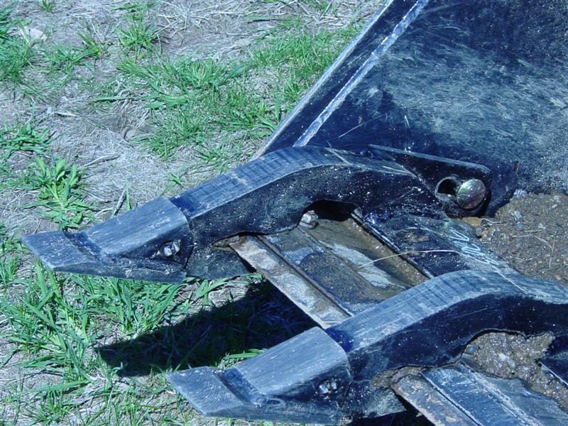

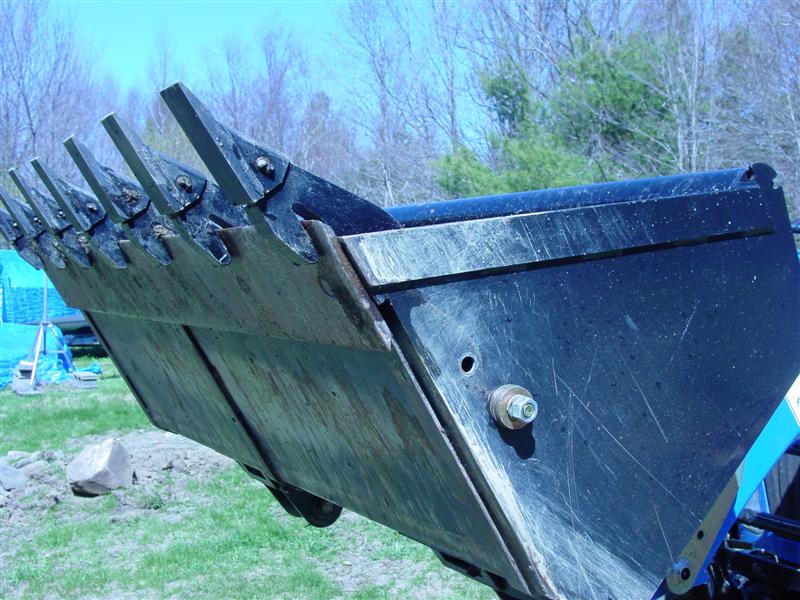

dws:
Yes I do. I purchased it through my NH/CNH dealer. I am less than impressed with the "fit" and it was pretty expensive :(. I am embarrassed to admit it cost around $500 :eek:. It is approximately 58" wide for my 60" bucket. It appears that it was really designed for the standard duty bucket based on the was it set up on my HD bucket (IMHO). I did have to redrill the two side holes (no big deal). Although I am less than impressed with the fit; I am pleased with the improved utility of my FEL for moving dense material, large rocks, pulling up trees and brush. I will attach some pictures to give you an idea. I do use it pretty hard. Jay

Jay,
did you try take off your bolt on edge and then add the toothbar? It looks like that would help the fit.
   / PTO Operating Speed #8
Ford850:
No I did not due to my laziness :rolleyes:. It would probably match up if I took off the bolt on cutting edge, but the toothbar was advertised as being able to fit over the bolt on cutting edge (and there are a lot of nuts I would have to remove :mad:). The carriage bolts that came with the toothbar were too short to clear the bucket's sides due to the width of the toothbar's 58" and my 60" bucket so the dealer gave me (free) longer carriage bolts. Based on the way I set this up I purchased appropriately sized carriage bolts for back ups. I almost had a coronary over the price :eek: of those bolts. So far everything is working :). It does fit over the bolt on cutting edge as advertised but the fit is poor. I initially was concerned about the lack of continuous contact between the edges for structural/strength reasons, but so far nothing :eek:, :mad:, or :( has happpened. Jay
