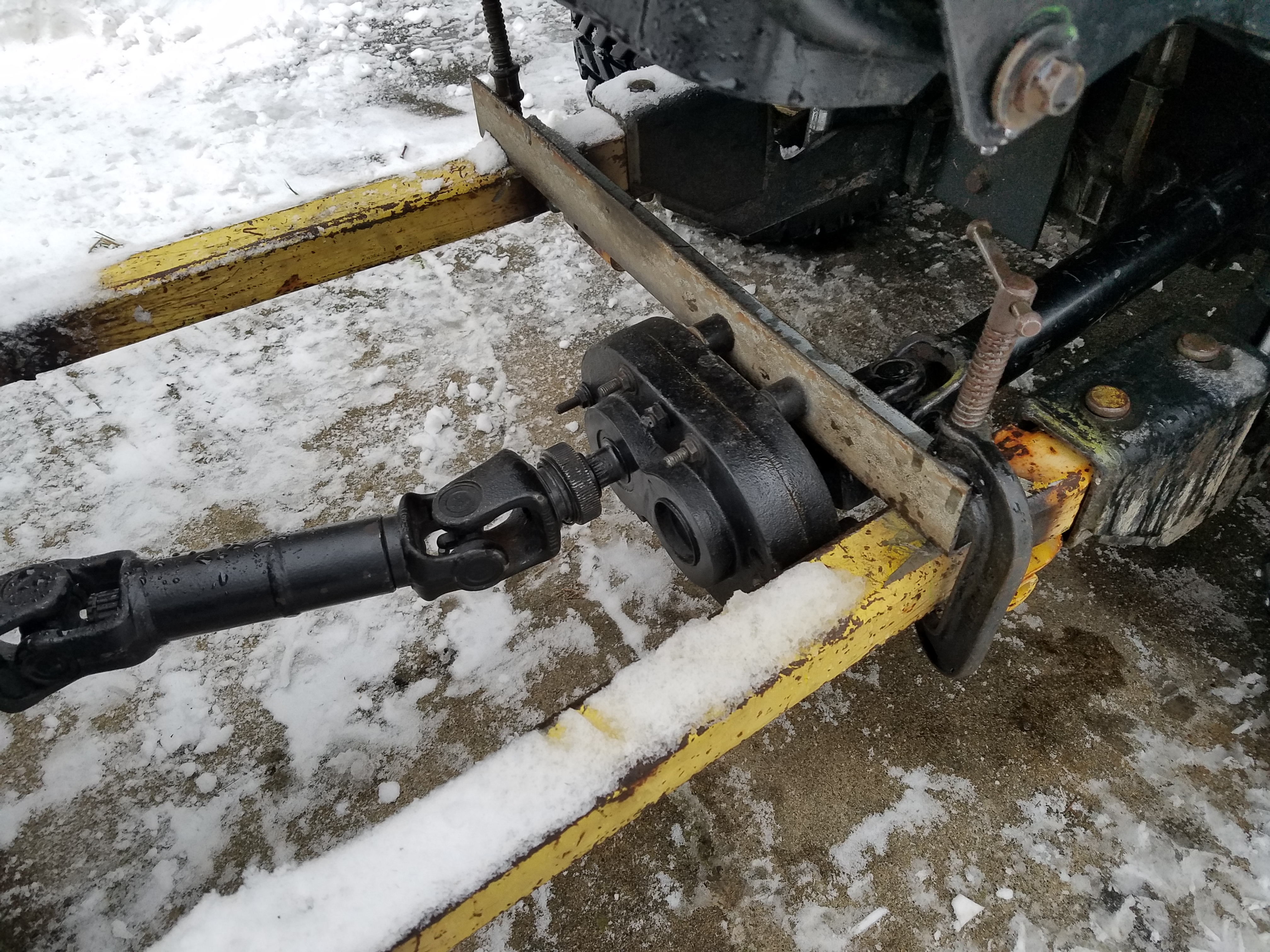

I use a pto reverser on my lawn mower to run a 47 snowblower. It was $150 on ebay. The other option was a more expensive parallel gearbox that drove the blower fan directly from the mower's pto. That would require a different (longer) driveshaft, too. I already had the extra short 20171217_162226.jpgshaft from a garage sale. These appear there once in a while. Ratio is 1:1. It's a John Deere part made for older 47s used on the F-900 mowers. The angle iron mount is now bolted to the lift arms. C-clamps worked just fine, though !
