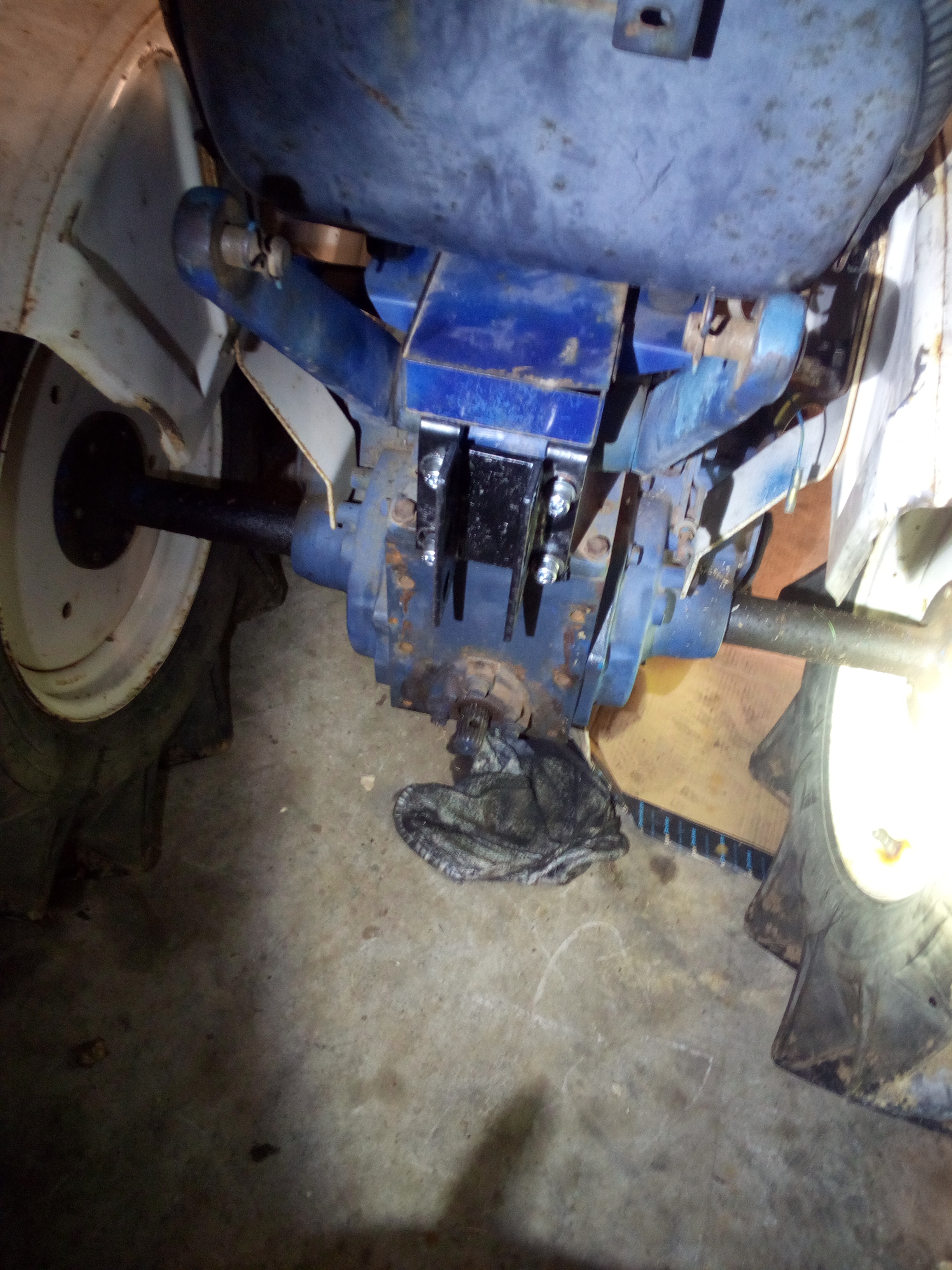

A lot of the B6000 grey market tractors came with tillers that bolt right onto the rear of the housing. No pto shafts to speak of in the normal sense of the term. The diesel engines also turn the opposite direction, so the output for the pto is basically turning backwards. I think Woods offers a mower for these reverse turning pto shafts, but some people buy a reverser that attaches to the pto and changes the direction of turn so "regular" implements can be used, without having to be concerned about which way the thing rotates. Don't feel bad about not knowing that there are tractors that turn the reverse way. I worked on one and didn't realize it until days later.

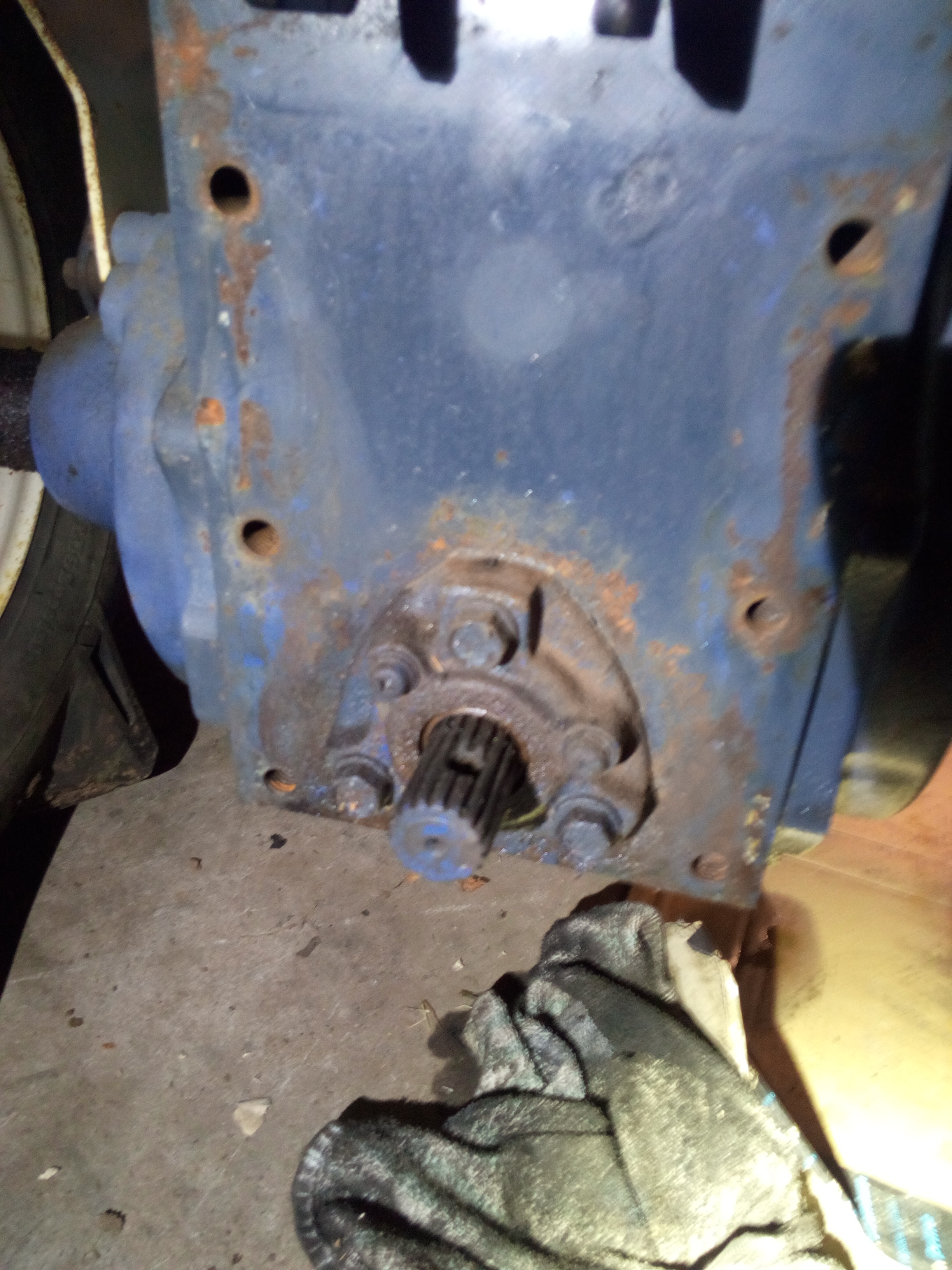

the one from yenbiz is a 18spine input, and most of the b6000 that were imported into the US have a 10 spline shaft. The pto reverser needs to have a 1" 10 spline input and a 1 3/8" 6 spline output, with a 1:1 GEAR RATIO. there are pto reversers out there, but they are hard to come by. the farmall has the right size shaft, but the gearing isn't right, as the pto runs too fast.
   / pto reverser for kubota b6000 #9
I think the B6000 has a 25 mm diameter shaft, but since I don't own one, I can't go measure it.

I am located in Ireland- I have a Satoh St1510D 4WD with a FEL also unfortunately it has the reverse PTO and I am in mind to sell the lot if I Cant get a reverser- I thinki its the same as the B6000 at the rear end though a picture may help if you have one I would be interested. Shipping maybe a pain from Canada to Ireland though I am willing to take the hit as the Satoh is a deadly wee runner with the FEL and all!
