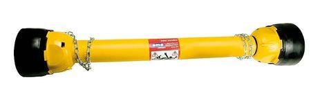

For series #4-48"-74"
Inner diameter of bearing on inner tube: 46 mm / 1 13/16 in.
Inner diameter of bearing on outer tube: 53 mm / 2 1/16 in.
These are available for less than $40.0
   / PTO shaft cover/shield question #9
