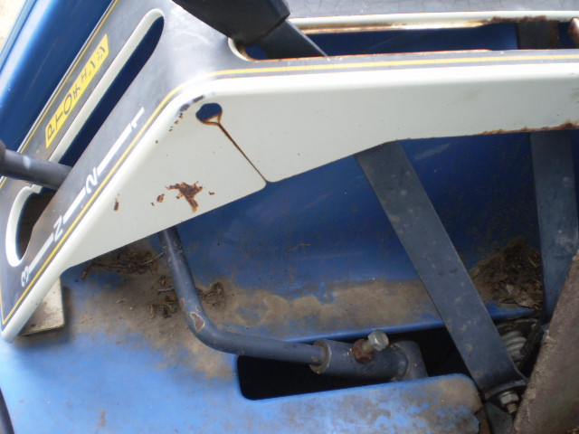

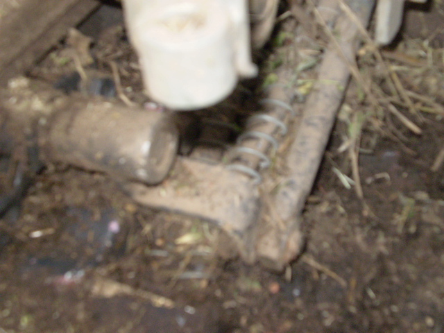

Ok I went out & looked . I,m sorry I had sold the 247 . & now just have the 240 & 255 , Which are diffent from each other. But I would guess My 240 would be closer to yours then the other.
That being said is Your PTO controls on the right side or the left side . My 240 is on the right side. I took a few pics. & If You can locate where it hooks in after the linkages to at least eliminate a linkage problem will help. Unless You,ve allready done that.
The first pic is the PTO lever itself . Its hooked to a swing arm that goes to another lever that goes to the PTO control on the gear box itself which is in pic 3.
I would check all of those linkages & make sure everything is hooked up & not slipping on the shafts . Then if the lever going into the gear box is moving & Doesn,t have a clickish feel to it Then its inside the gearbox where the Problem is . Which is another story .
So if You can do some checking & let Me know , I,ll do some more checking & see what else I can find out. Sorry about the dirty tractor but I just got in from mowing. Hope this helps a little bit. Bob

OK, On mine there is no pto lever just the H pattern shifter & when in the nuetral position the PTO is off . There apears to be some type of linkage but its where I cant see it or take pics, without removing the rear tire . So once again I,m no help . :eek: .
So unless someone can add that has a similiar setup only thing I can do is wish You luck . Unless it would be helpfull for me to remove the rear tire on Mine & look at it a little closer. Just not sure it would help your situation though. Let Me know if you think it would. Bob

Nothing like helping yourself. I removed the rear tire and access plate so I could better see the linkage for the PTO. After a minute of flashlight work I saw a small rock wedged in there. I cant imagine how it got in there judging by how hard it was to remove. It turned out to be a piece of Marble. We dont have Marble here. Maybe its Granite. Anyway. The linkage is free and I will try to control the frustrated and dumb questions. Thanks for the help.
