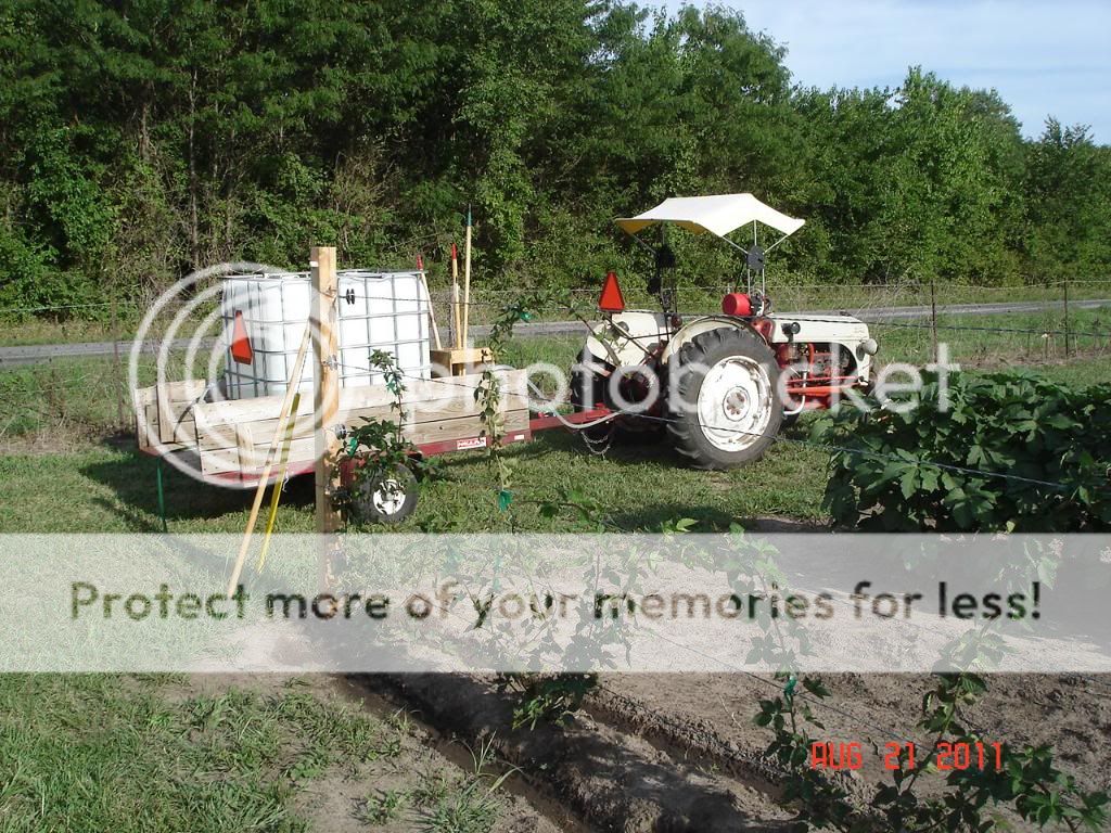

Specs on the roller pump say it will flow 12 GPM @ 100 PSI. The transfer pump will flow 158 GPM, no pressure stated. IMHO, the roller pump will do what you want. Might be an issue with how far it will lift water on the suction side. It will build considerable pressure, might need a relief on the discharge side, or just idle when pumping.
I use a transfer pump to fill up tote tanks at the river. The roller pump then waters from the tank. Originally I filled up the tanks with the roller pump. I could get right down to the water at a gravel bar at times, so lift wasn't an issue. It will pick up better if the hose is primed. HTH Mark.
