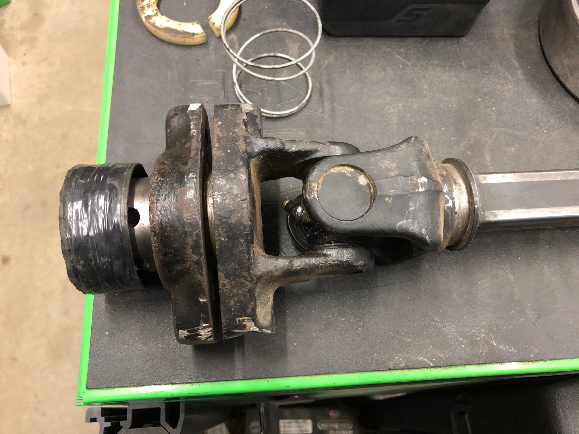

Hey guys, i need to replace the tractor side coupler on my PTO shaft as it came apart, any ideas where to go/ buy? typical 6 spline, 1 3/8" U joint cap diameter is 1.062 IMG_4041.jpg

I had my PTO shaft work done at "Six States". I don't know if you live near a branch or not. They know what they're doing and where to source the parts to do it. They aren't cheap but they are not unreasonably expensive either.

shear pins?? From the pics the u joint look as it is still intact

You can get PTO parts at pretty much every tractor dealer. TSC is hit and miss these days.

It's hard to say from that picture just what you have.
There are several styles of pto shafting and sizes.
That looks almost like a shear pin yoke, they usually are on the implement end of the shaft.
Once you have determined the style then you can find a new yoke.
The link attached may help you to narrow down what you need.
Identify Agricultural PTO
   / PTO yoke advice for snow blower #8
It almost looks like you have a pto shaft with a shear bolt built into it, but I’ve never seen one with two bolts.
