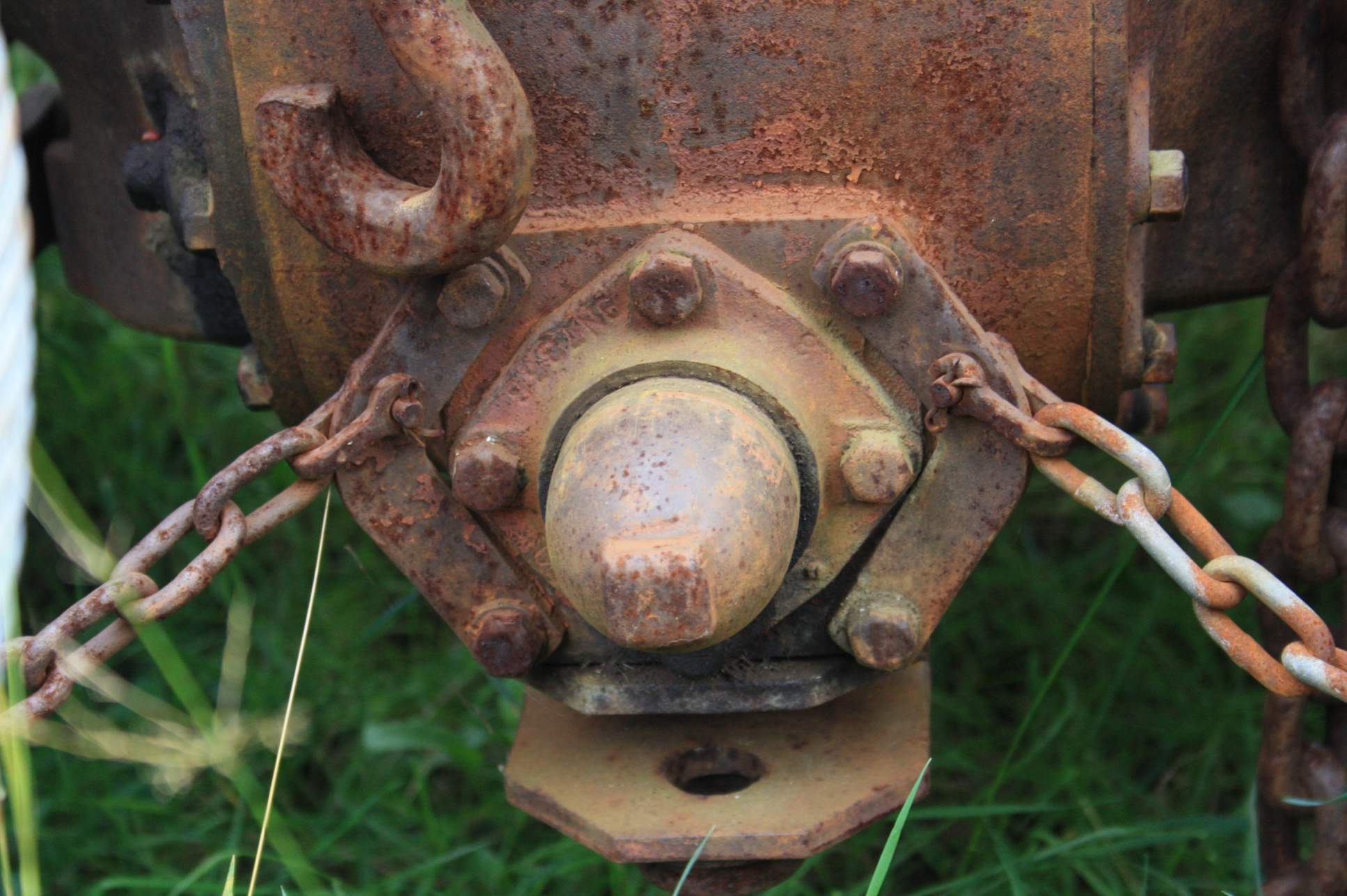

hi i just inhereited a 1953 ford jubilee and would like to put a snow blower on it but were the pto is its covered with some sort of metal cap do i remove this and by the shaft for this or am i out of luck for a pto..
   / pto #2
That's probably just a stub shaft cover (see the attached picture) used to protect the splines. It should just slip on (and off) but might be frozen on (by rust) if it's been on the stub shaft for an extended period.
Before trying to pry it off, how about posting a picture (on this thread?

okay ill take some pictures tonight and post them tommorow ill up load them when i get to work there is only low speed where i live it take for ever..:thumbsup:

Some of the covers (maybe all) were threaded. So, it may screw off.

im pretty sure this one is bolted on but ill get pictures tonight to make sure and thanks alot i apprecite this ..
   / pto #7
I've seen them with 2 or 3 little tabs and held on with screws too...that's why I'd like to see the pictures.
BTW, jeff pinkos...clean up the area around that PTO so we can see it clearly, please!

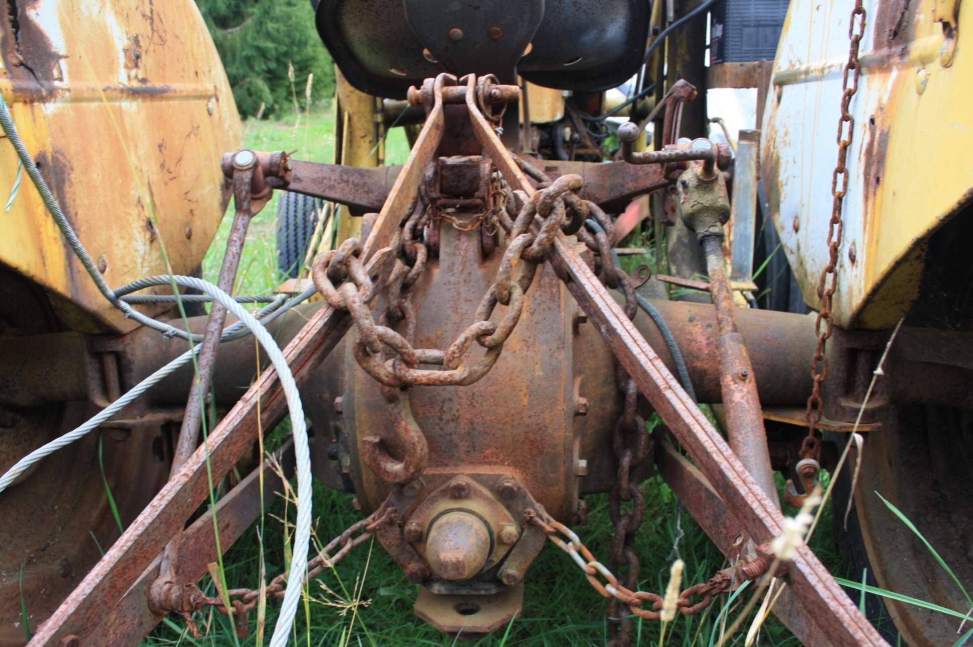

heres the photos
   / pto #10
Soak it good with WD-40 or kerosene. It will screw off.
