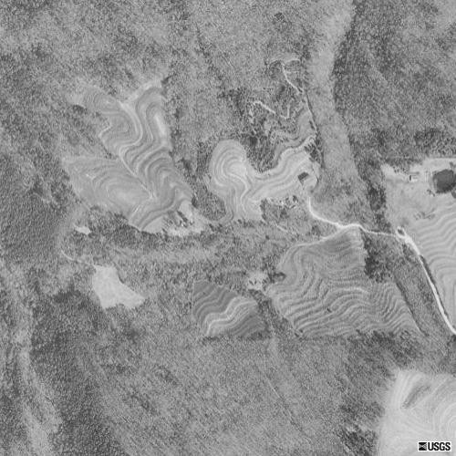

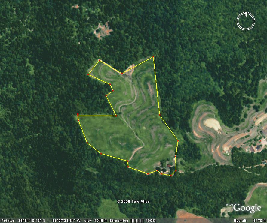

I'm not sure that I couldn't use a small 4WD combine, but many areas are really steep. I'll attach images from google earth. All of the land is parallel terraces.
Photo 1: Basically everything you see is part of his land. The open areas haven't been tilled in several years, but most of it is fairly steep.
Photo 2: In this photo you can basically see the lay of the land. The squiggly lines are the tops of the terraces. Some of this is almost too steep to plow with the Farmall 140. You have to really use the tractor brakes.
Photo 3: Is a better photo of the "backplace" He owns 80 acres here. What I have outlined is his open field. Pretty steep in some places. You can almost make out the parallel terraces.
Photo 4: Is of our property. You can really tell the parallel terraces in it. Look to the right of our pond and you'll see what I'm talking about.
Photo 5: Shows the outline of a terrace. Not something those corn farmers out west have to deal with.

   / Pull behind corn harvester #9
It was a long time ago, but we use to pick corn with a pull behind. Of all the brands New Idea was the best. Just remember you are going to knock down 2 rows around the field with a pull type. It also takes a lot of room to turn a tractor, picker and trailer around. If the ground gets the least bit soft you do not have enough tractor to pull a loaded wagon through the field either.
   / Pull behind corn harvester #10
Jdeerekid,
Chris
Way out west they harvest crops on the sides of mountains every year. You can do just about anything you want to now so all you have to do is decide just what you want to do and what your budget is.
I personally would rather run a side hill harvester on steep land then pull a picker and wagon. On steep land if you get any amount of moisture you could be in for one heck of a fight.
