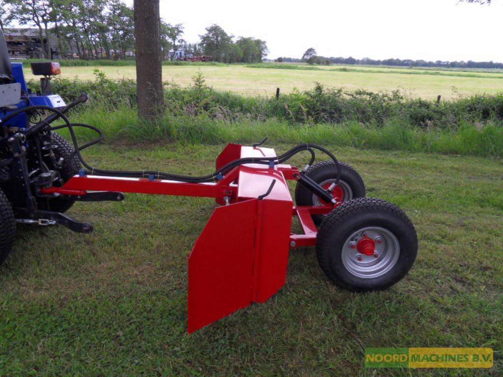

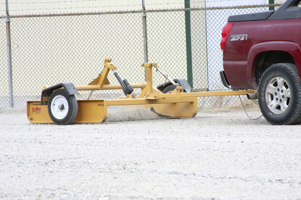

I have ruled out getting a 3 Point for the X as the Lifting capacity and Lifting height are severely limited for effective box blade work. What do you guys think of a pull type scraper? As I only have 2wd and 24hp, will this be an effective tool or is that idea nuts? I thought of 48 inches width for example. Something like this:
I could get a rear hydraulic remote for far less cost than a 3 Point for the X495. And for the saved Money I can buy some front suitcase weights and/or rear wheel weights (By the way....I have rear bar tires)

If you are using it for driveway work and not land leveling, etc, a tongue pulled LPGS may be better.

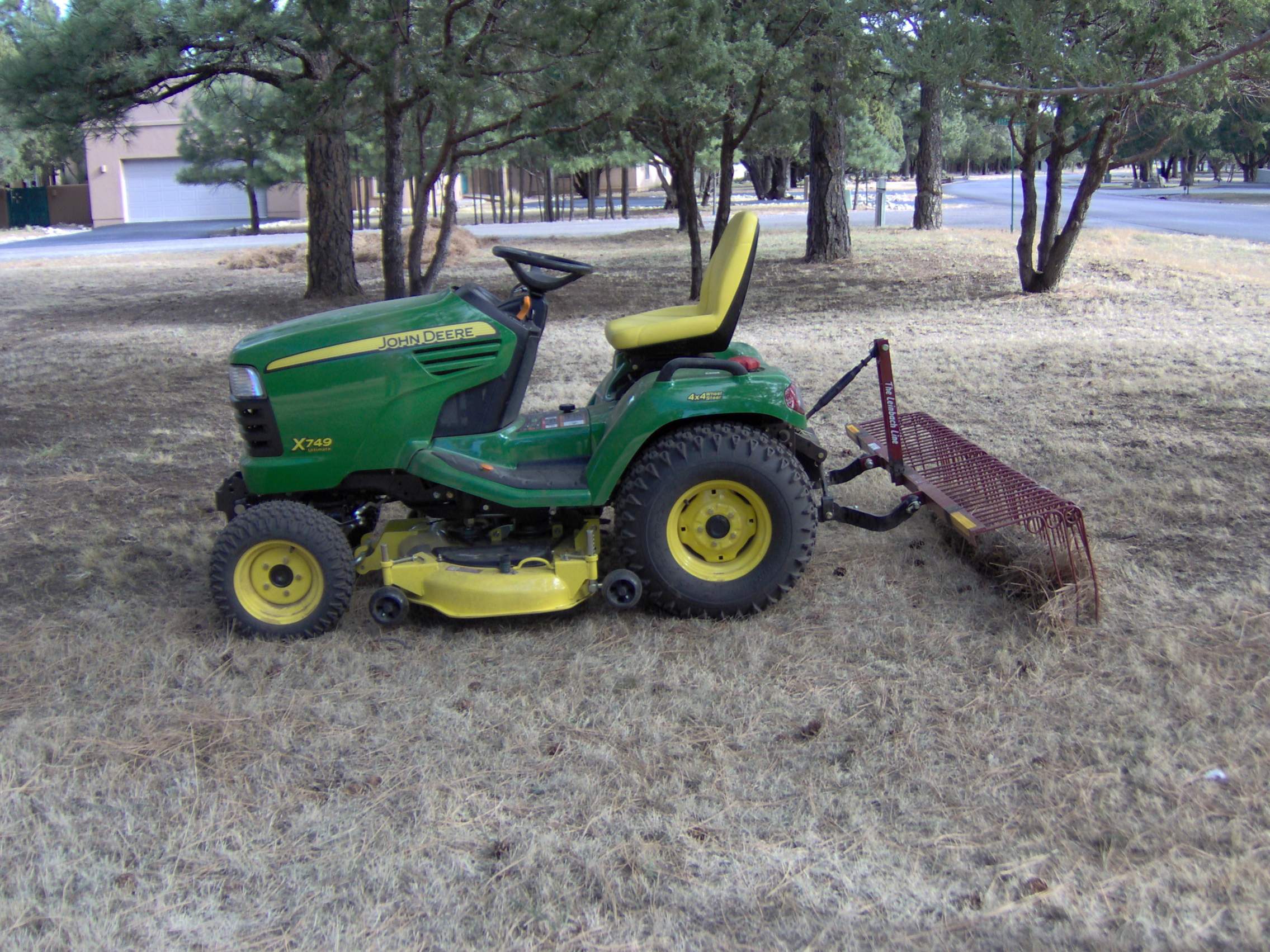

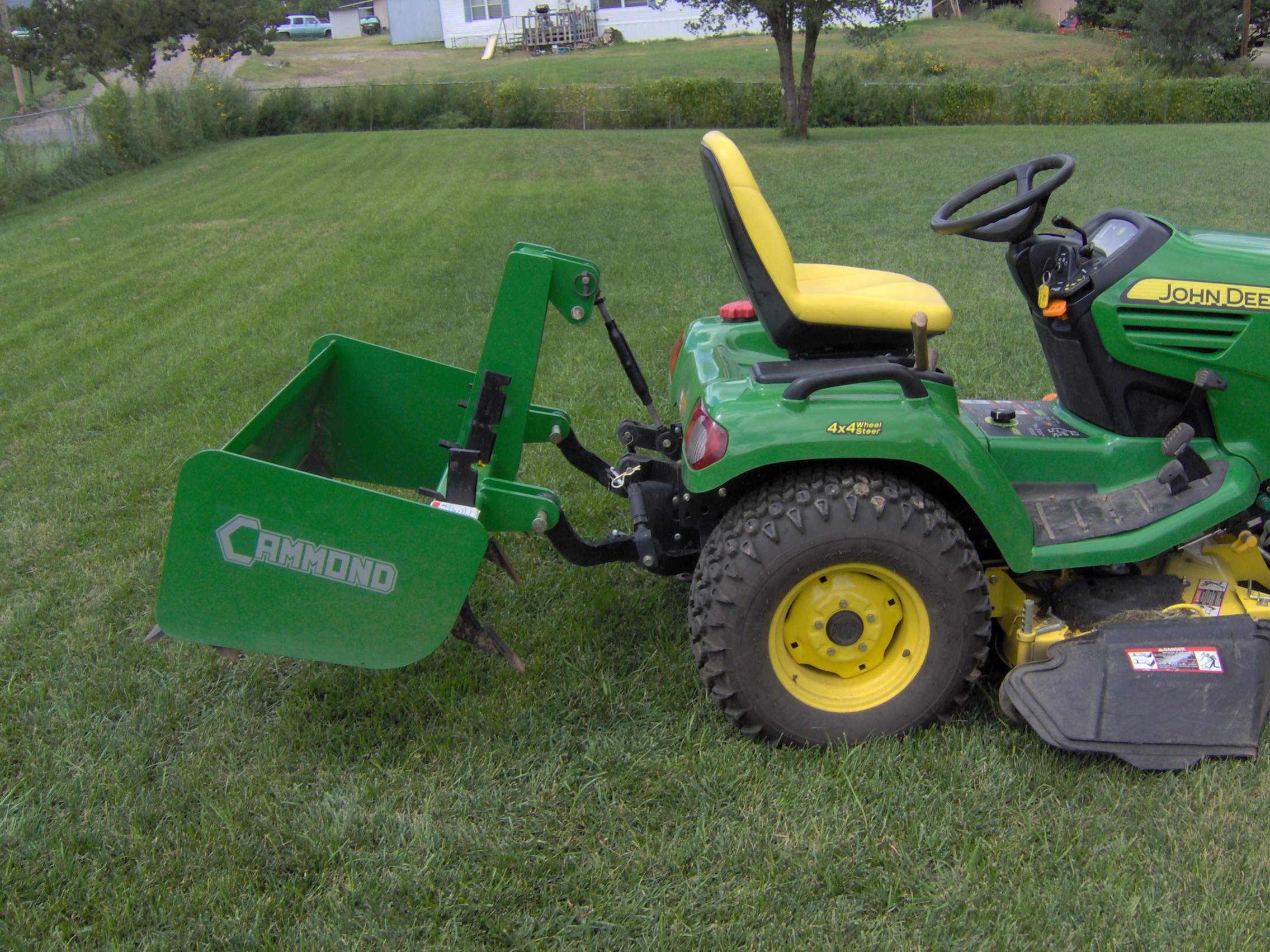

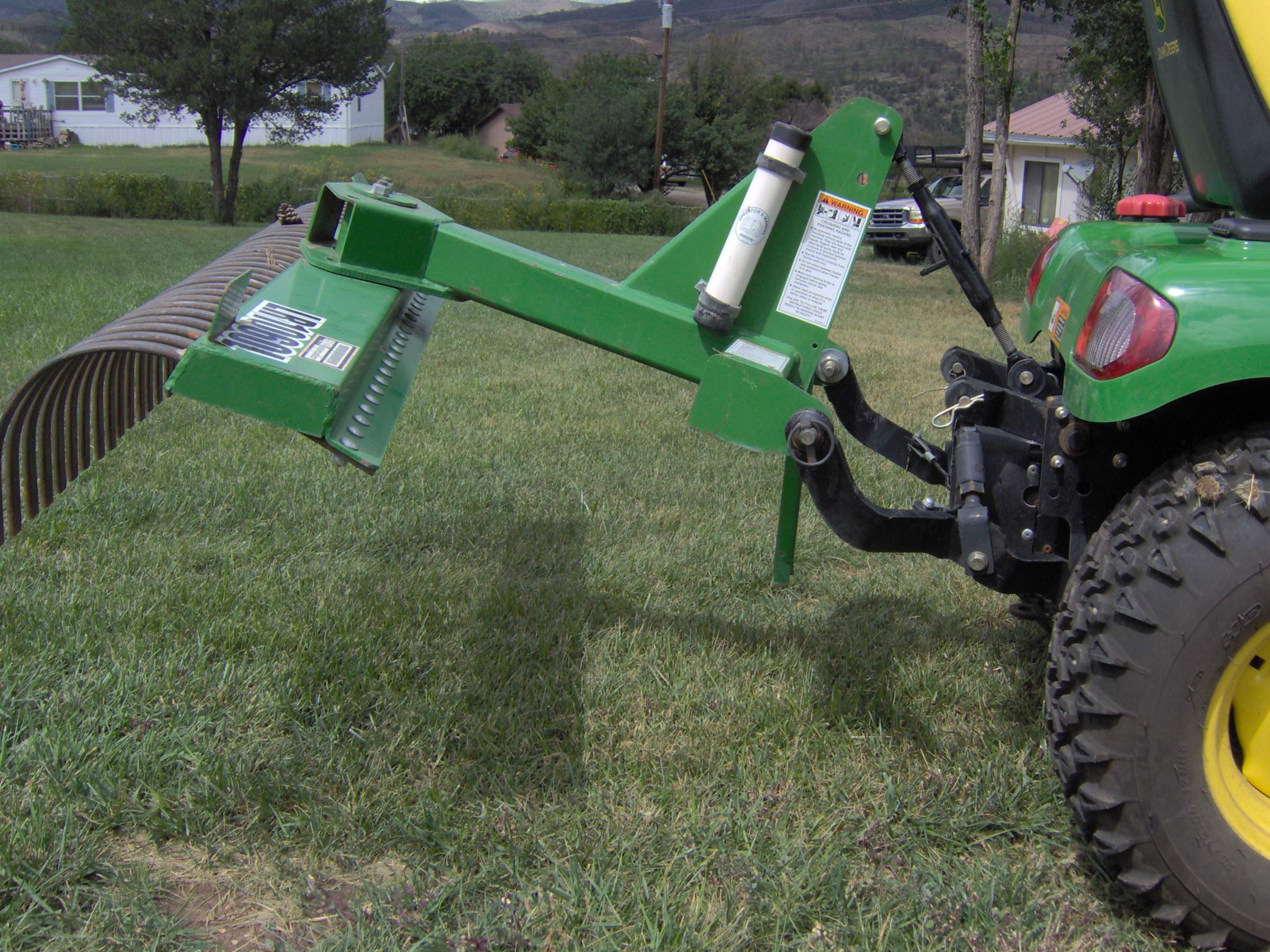

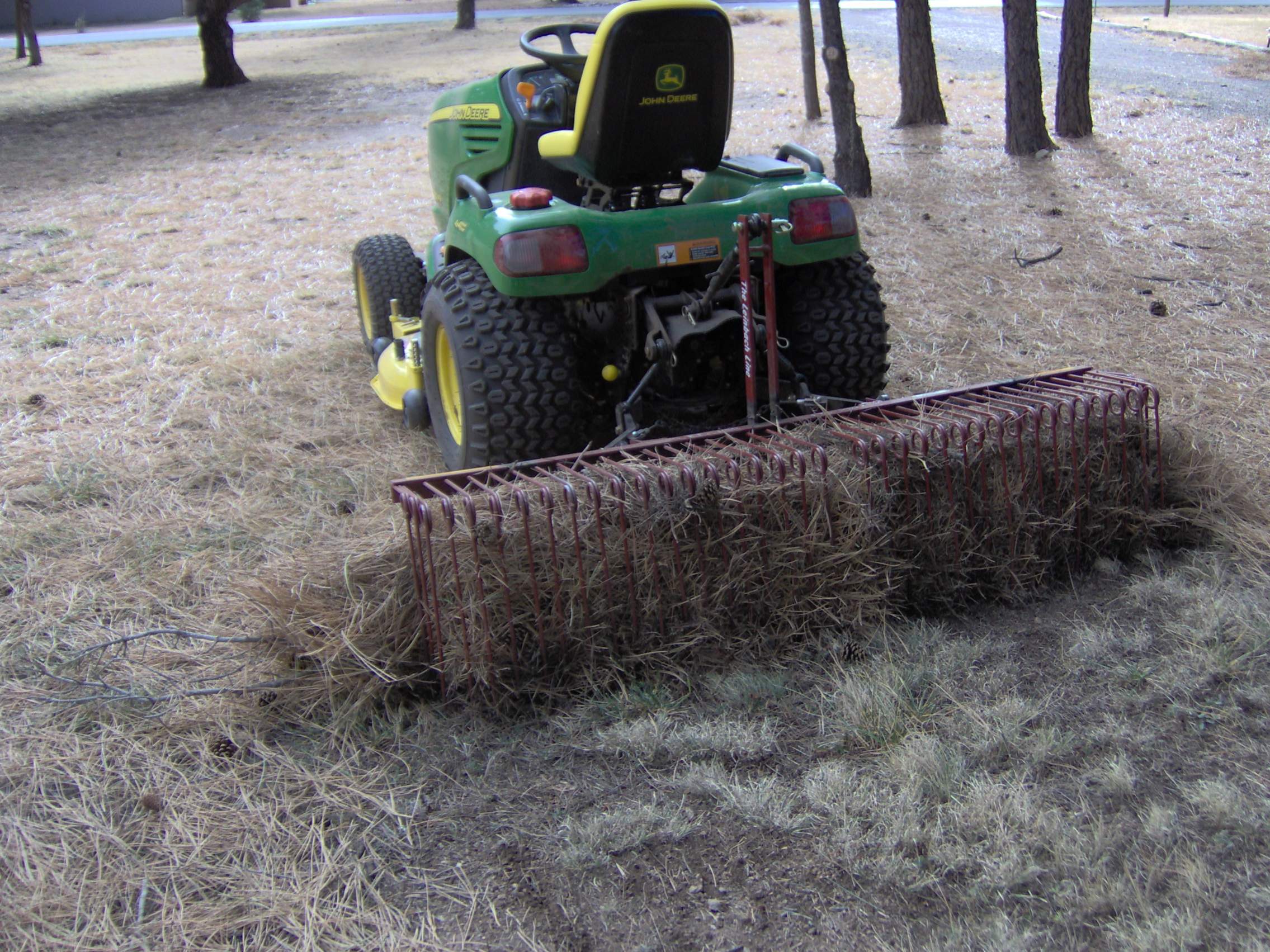

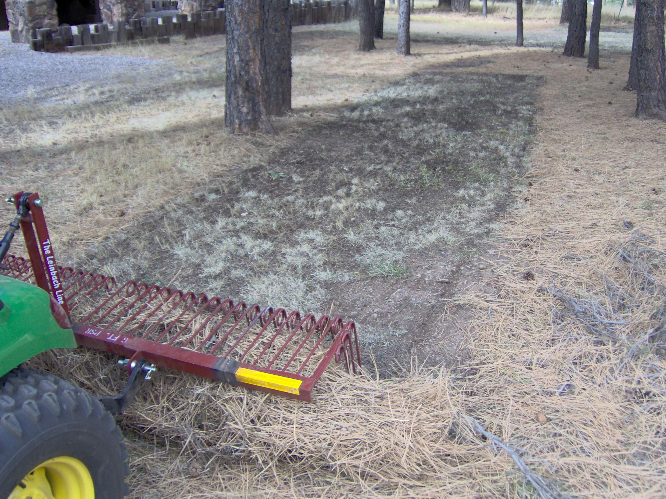

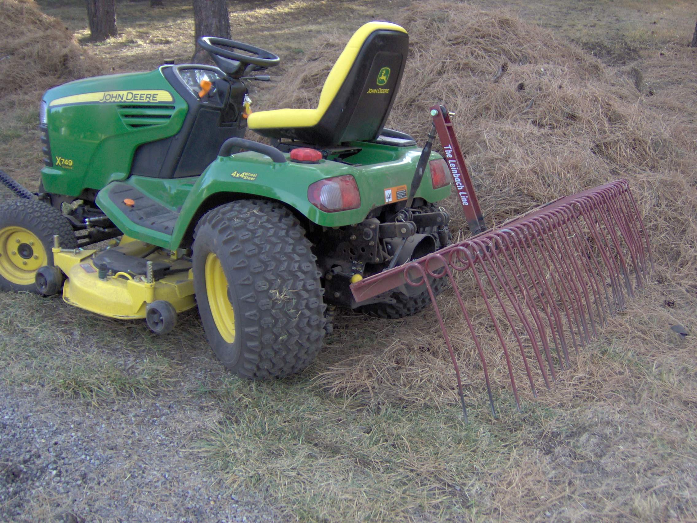

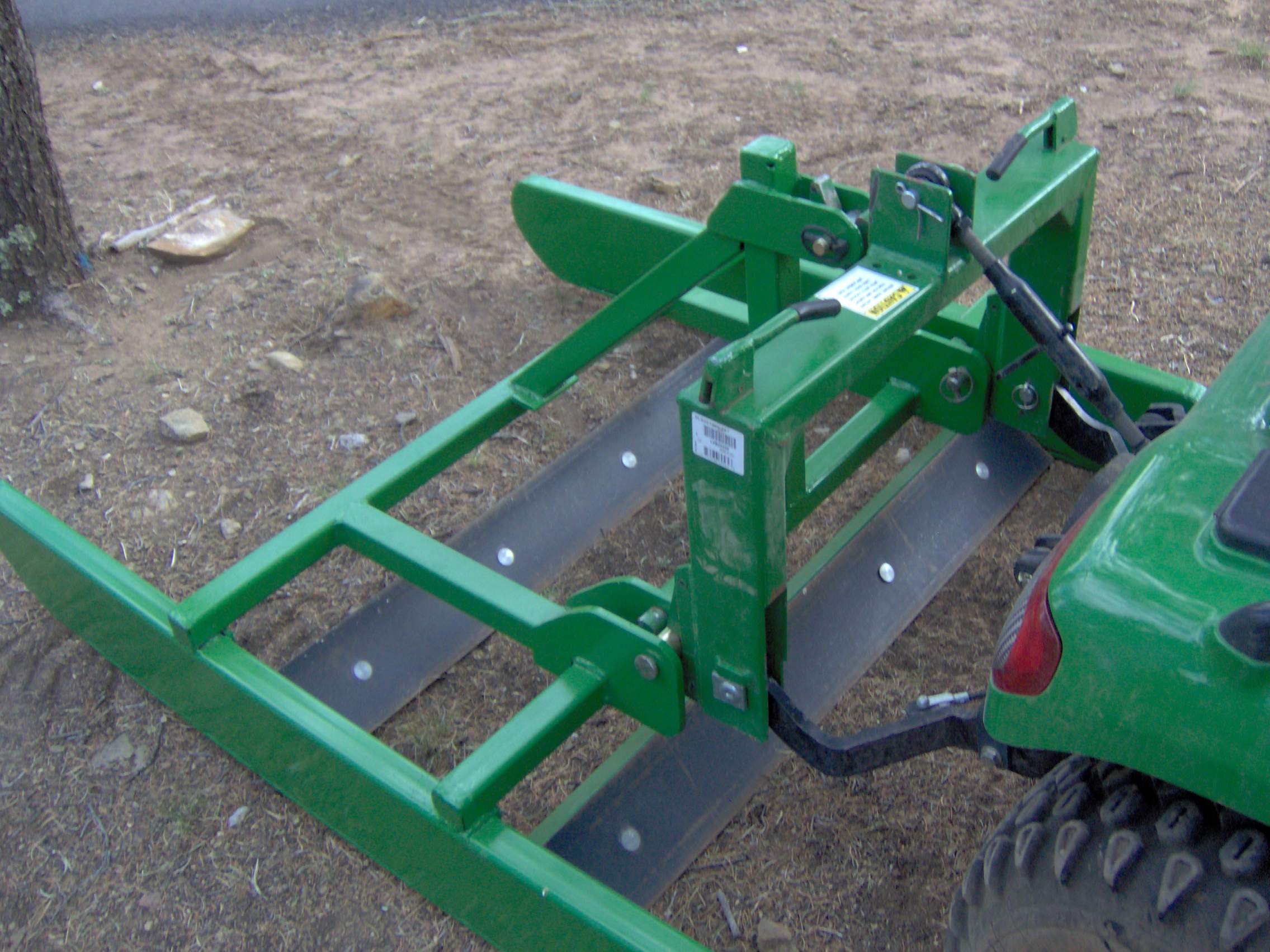

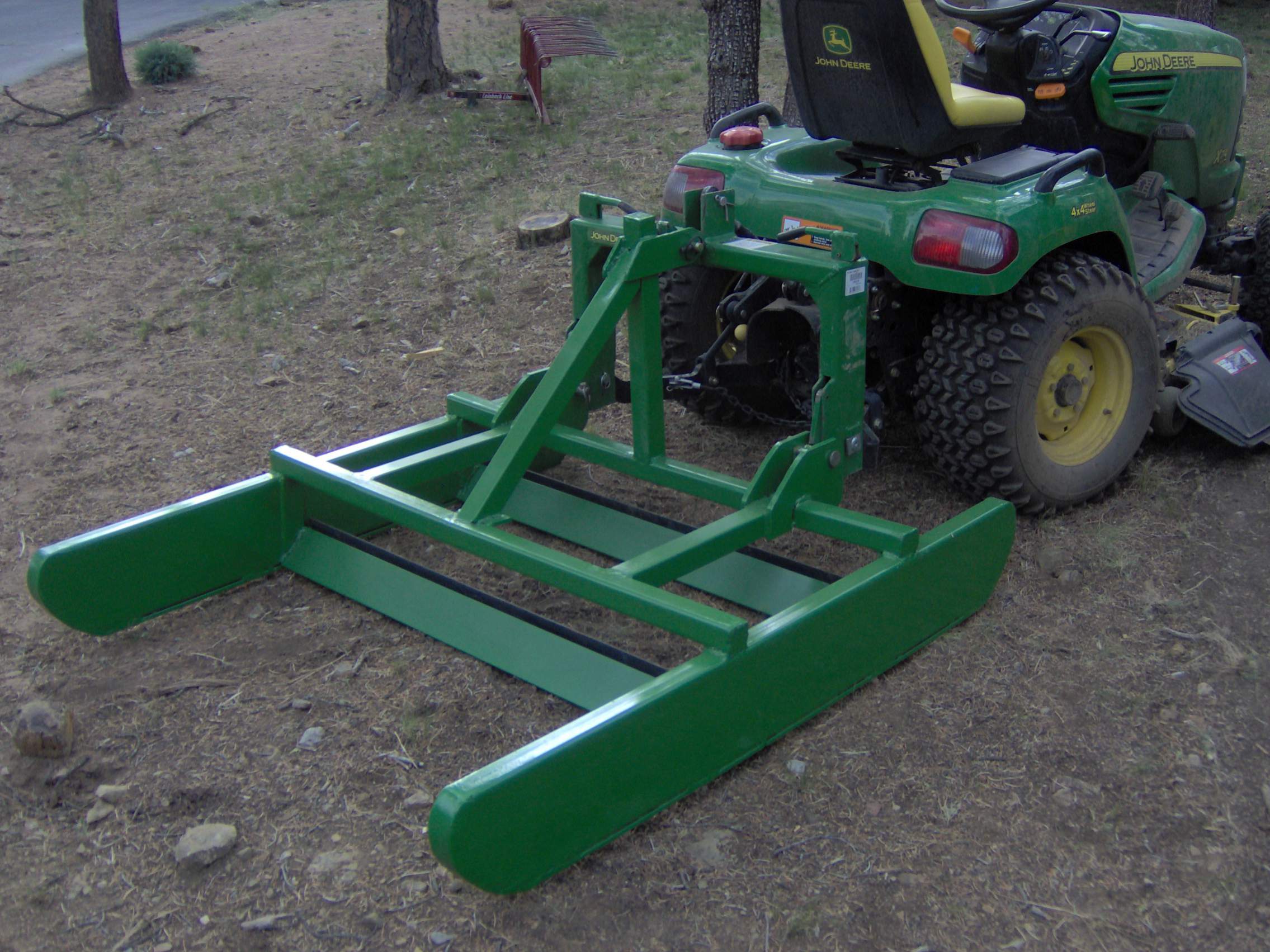

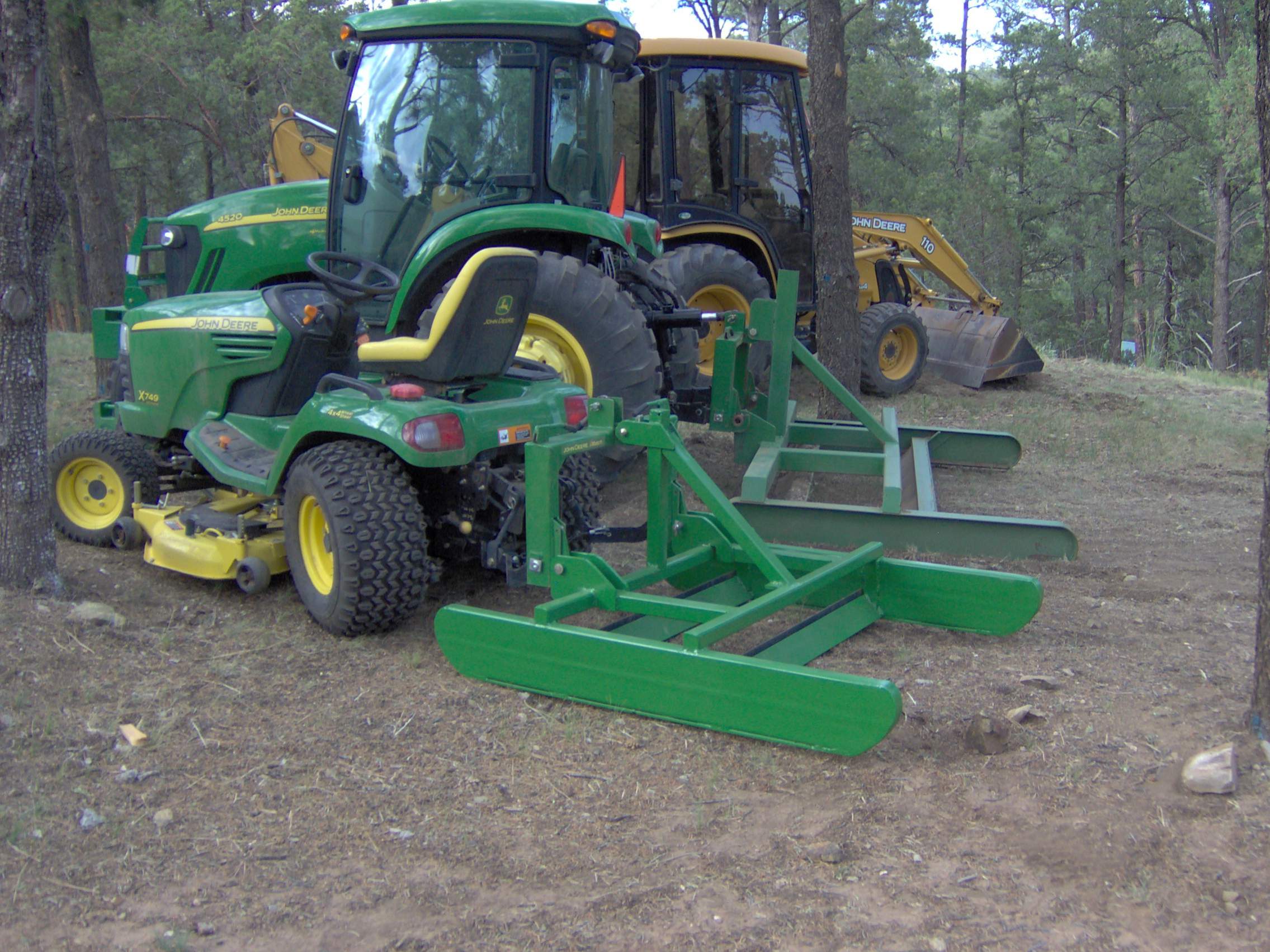

I have played with this size stuff some and use my x749 to work under trees and in tight corners where the larger tractors can't fit. The L&G tractors will work with the 3ph type equipment but they are light for the most part. I will tell you it has saved me a lot of labor money where employees used to do the close quarters work by hand. Having the small machine has reduced the manual labor by 75% at least. I don't recommend it to replace a larger tractor but they work well as a team.
Here are some pics of the x749 with the box blade and custom land plane I built. My favorite tool is the pine needle rake on this tractor, very handy for raking as well as smoothing and seed covering.

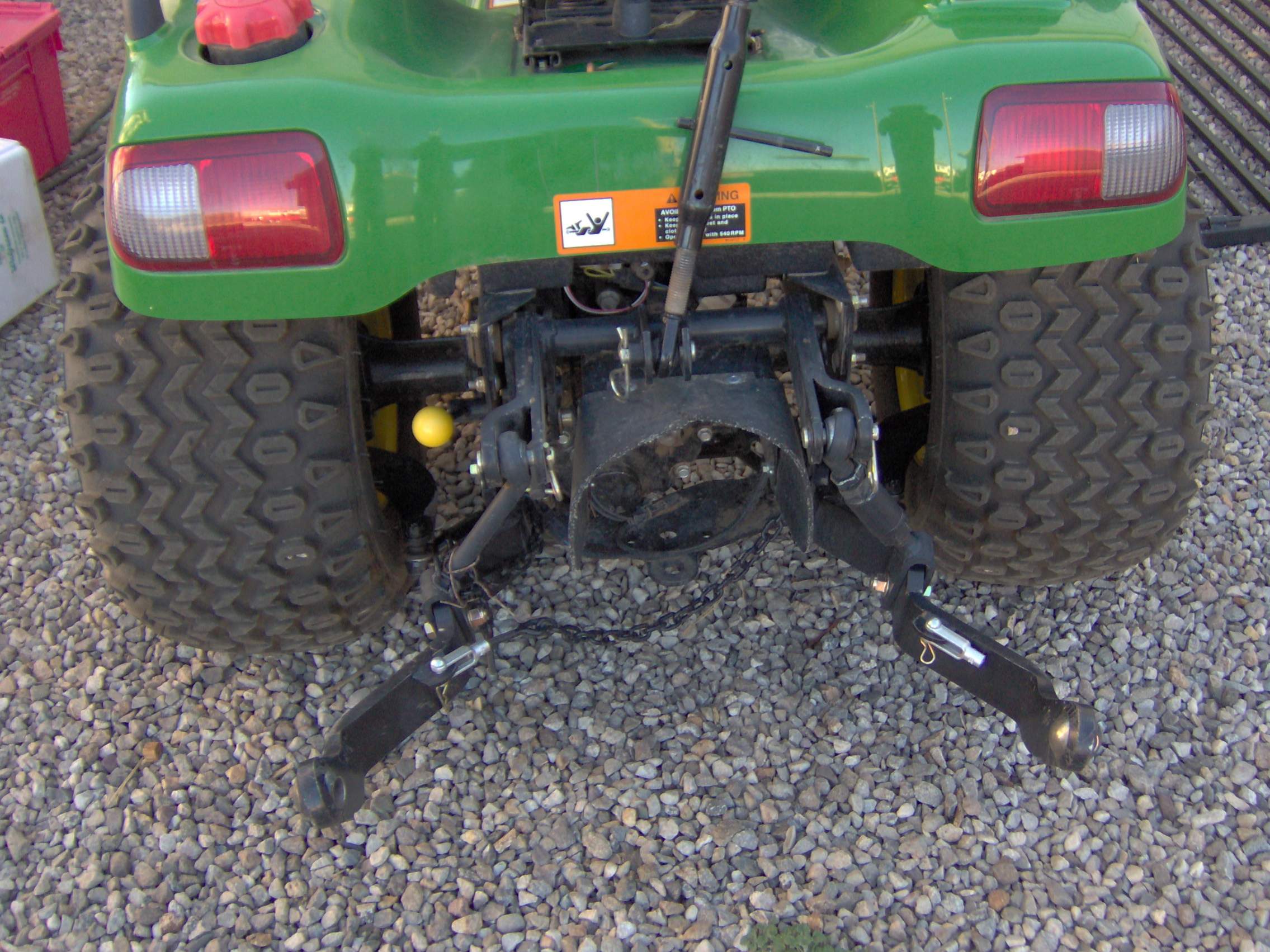

I be one that had 2 sets of wheel weights from a 455 which I used then I filled the tires and put chains on a 2 wheel drive X595 with the 3 point hitch. Then I transfered all that to a new X740 2WD.
I already had that equipment on my tractor which I used for pulling a 2000# heavy trailer, pushing little trees over with the front blade and also snowblowing, mowing etc. That was all I had but weights and a 3pt made the tractor very useful for my needs. It seemed pretty durable for those things.
I then bought a 6' rear blade for my 500' gravel drive maintenance from Fleet Farm. The tractor handled the blade so-so. It handled a 32" dirt scoop also from Fleet Farm fairly for such a small tractor. The limiting factor was the 3pt lifting height. If I angled the blade, one side was very close to the ground and the other side was quite a bit higher because the connecting points were much lower than a CUT. Same with the dirt scoop. I could fill and lift almost a full, bucket but only a few inches off the ground.
All that being said, I could make it work except for the most difficult circumstance, but never as good as a CUT. I just got caught up in the moment and bought a $28,000 tractor. If I had just normal needs and lived on an acre or two, those small tractors can do a lot of heavy work and would be all someone would need, and a whole lot cheaper than a CUT.
