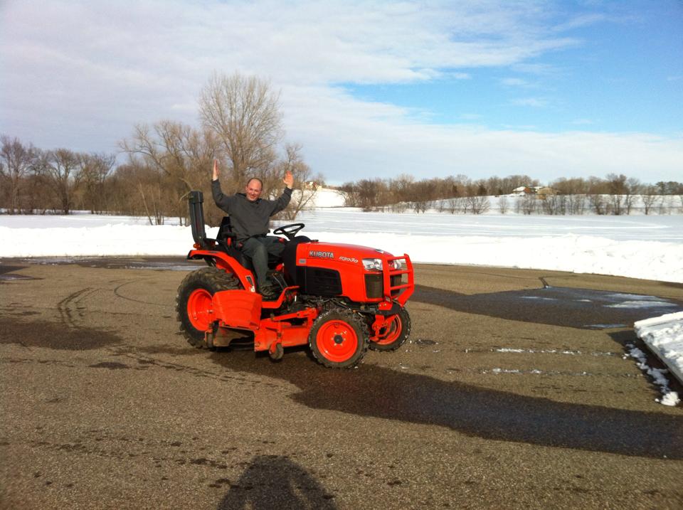

Had to go to AL to get her back to MN, but it was just too good of a deal to pass up. She's got 318 hrs, 72 MMM, R4s, but I'm also looking to add a FEL. I asked my local dealer to quote me a LA403 (loader, loader value, and 60" bucket) and he came back at $4100. That's slightly higher than I expected, but in the ballpark. I thought I'd ask here to see if other's got better pricing from their dealers. I'm not afraid of drive to save some bucks. :)
The fluid's were changed at 240 hrs and this tractor has lived in warm climate its entire life. I'm still many hours from needing a change, but I need to operate in -20F during the winter. Need cold weather advice. Do you guys run standard or super duty fluids? Something else?
I'm still debating on the best way to add some weight for the FEL. I plan on moving dirt and snow with it so I was considering either/both a ballast box or loaded tires. I plan to mow with it and part of my mowing is a septic leach mound so my concern is soil compression. I was using a JD L120 and it only weighed ~500lbs. The B3030 is 2260lbs (1800+460) today, but how much extra weight would loaded tires add? I have to admit that I like the idea of dropping a box when I don't need weight and adding it if I do.

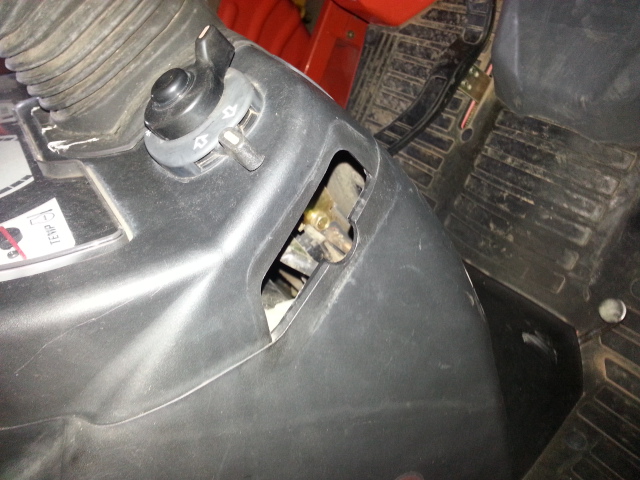

Small misc items. I'm missing a small plastic trim piece just below the light switch on the left side. Does anybody know that P\N for that? I also need to get a top link for the 3pt.

Your missing plastic part-often we forget the Kubota parts catalog is available online,either at Kubota's website,or Messicks or Tractorsmart websites will direct you there.

The part on the left is called SHUTTLE COVER PART NUMBER 6C200-53562
TOP LINK ASSEMBLY 6C200-65400 (THIS IS THE NEW ONE)
Here is where you can hunt for parts for yourself. below
Kubota Tractor Corporation - Parts

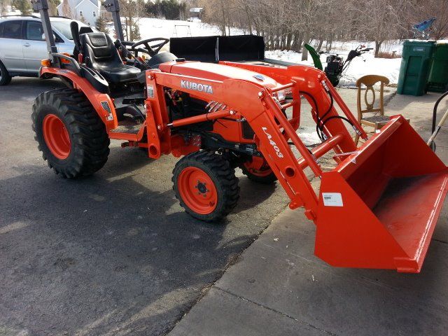

I finally got my LA403 ordered and delivered. I put it on myself over a weekend. The manual says 1.5hrs.....but it was more like 1.5 days for me. :) The only gotcha I ran into was the mower mounts. My B3030 had a 72in already installed, so it had mower deck linkage attachments bolted to the frame. Long story short, those have to be removed. The quick attach loader mounts have the slots to hold the deck attachment pins. No mention of that in the manual, but after some google images it quickly became clear how it was supposed to fit.
