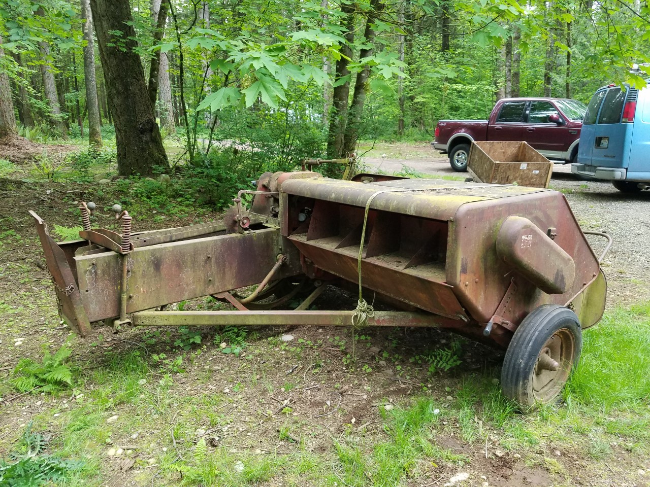

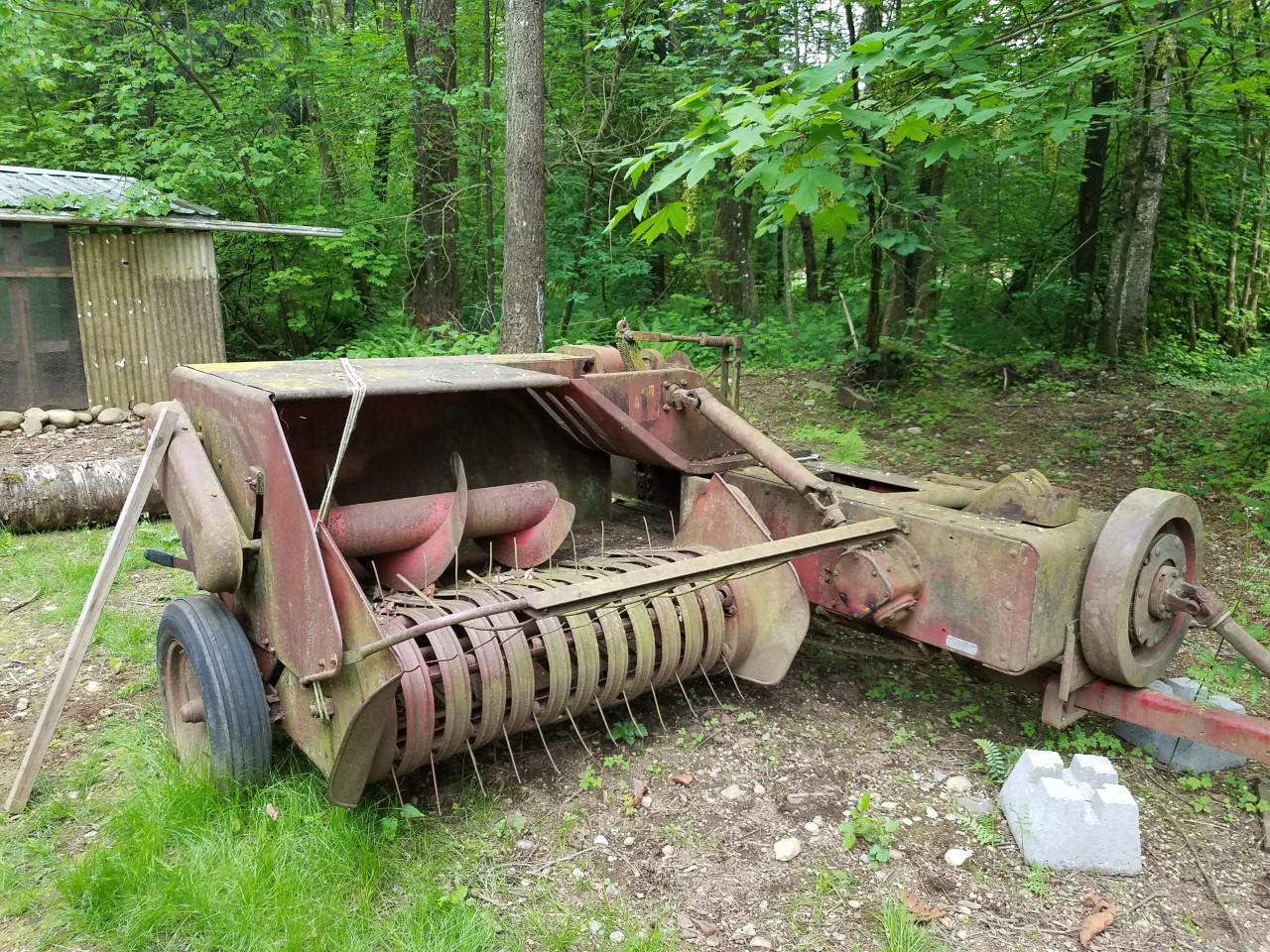

Well, I finally found what I thought was a decent deal on an old baler. Paid $150 a IH 46 from a local guy, was barn kept it's whole life, until two years ago, where it was under a tree. It hasn't been used in about ten years, but was used and well kept before it was parked. Everything is there, everything moves, but it needs some work.
I plan to replace the chains, belt, grease everything and check the timing prior to hooking it up to PTO. The pickup teeth should be replaced, and I need to spend some time cleaning things up/lubing. Otherwise, I think it'll be a decent baler. Dogs are in good shape, needles look great, knotter assemblies look in tact and fairly clean, and there is no bad rust anywhere on it. I have the operators manual on the way, so I look forward to that read.
It's not pretty, but pressure washers and paint do amazing things! I'll be bringing it home this weekend, and can't wait to dive in.

Where are the gathering/stuffing forks? Cant see them in the photo. Just wondering.
   / Pulled the trigger on an old baler #4
Are the gathering/stuffing forks still in good shape? Cant see them in the photo. Just wondering. Appears to be in fairly good shape - one bent piece of metal on pickup, not bad. be sure to drain the fluids and check the universals on the intermediate drive shaft. They make quite a mess when they let go and that big piece of steel flops around. I think you did well.
The gathering fork is tucked up in the bale chamber in those pics. It's in great shape. No cracks or welds! The universals seem to be in good shape, but I guess I'll know more when I put 540 to it. I'm sure I'll just end up replacing them to be safe.
Look carefully. The feed forks are currently within the bale chamber and on their way out.
