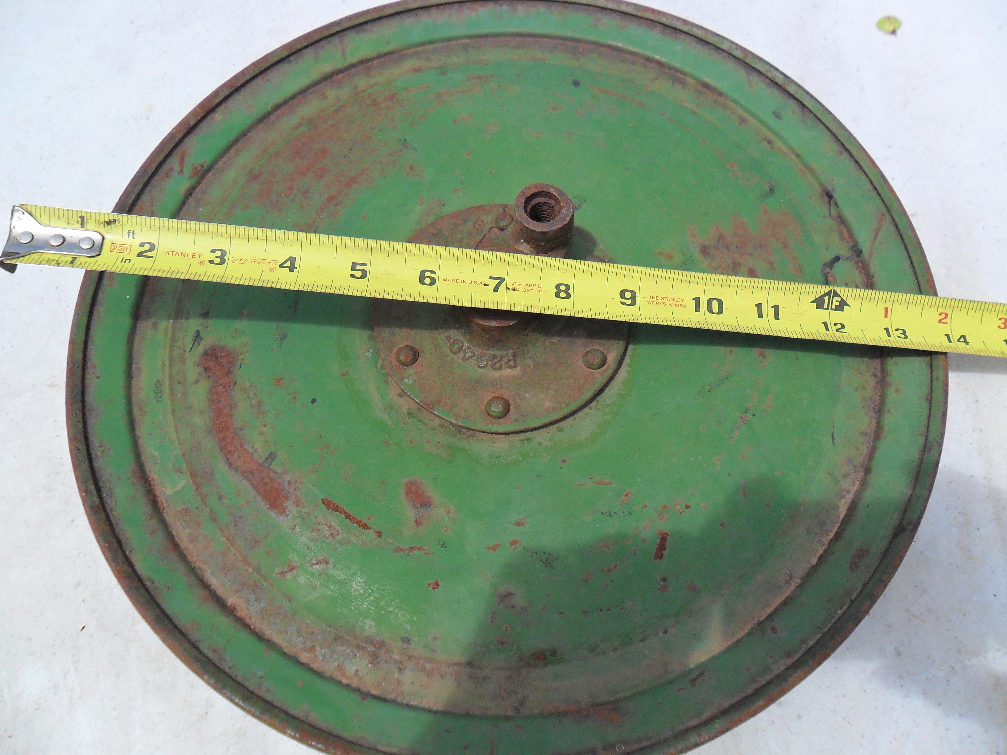

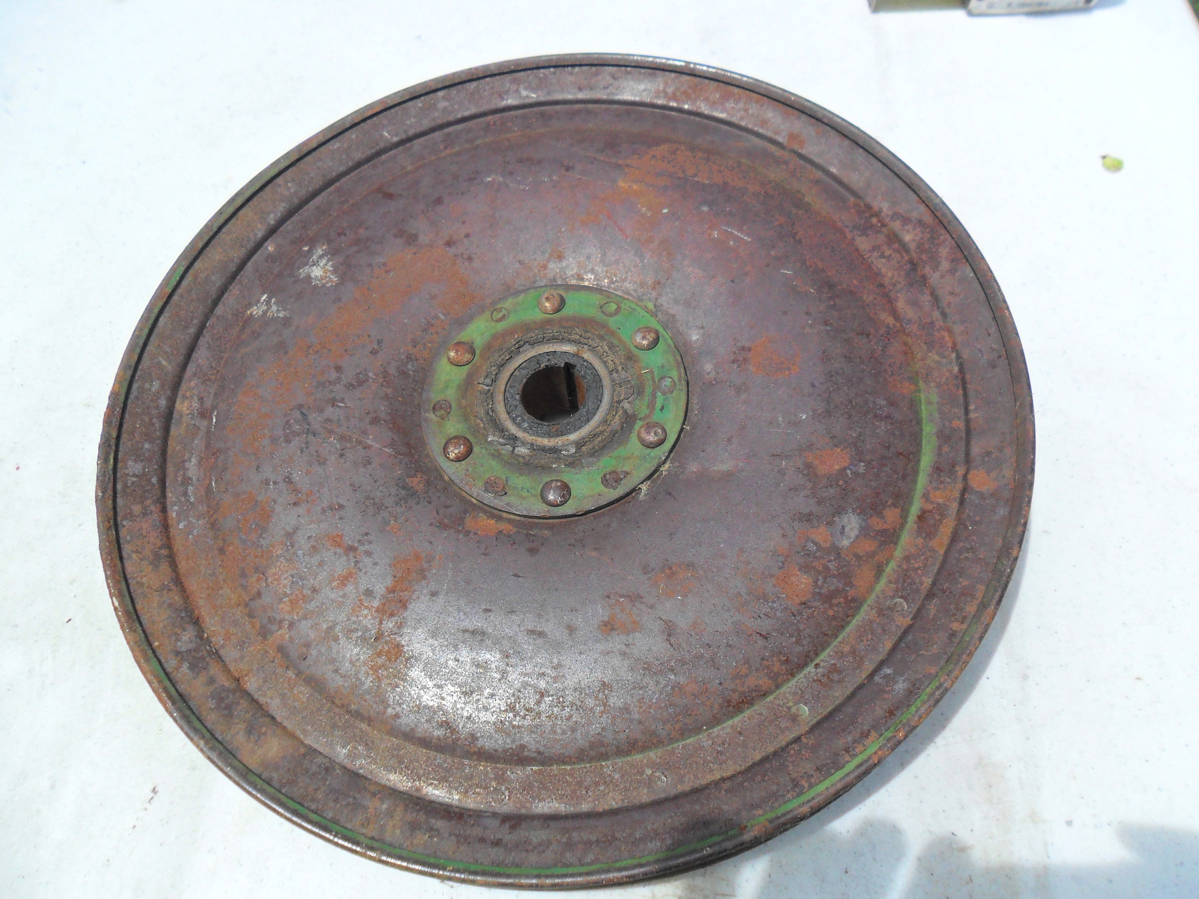

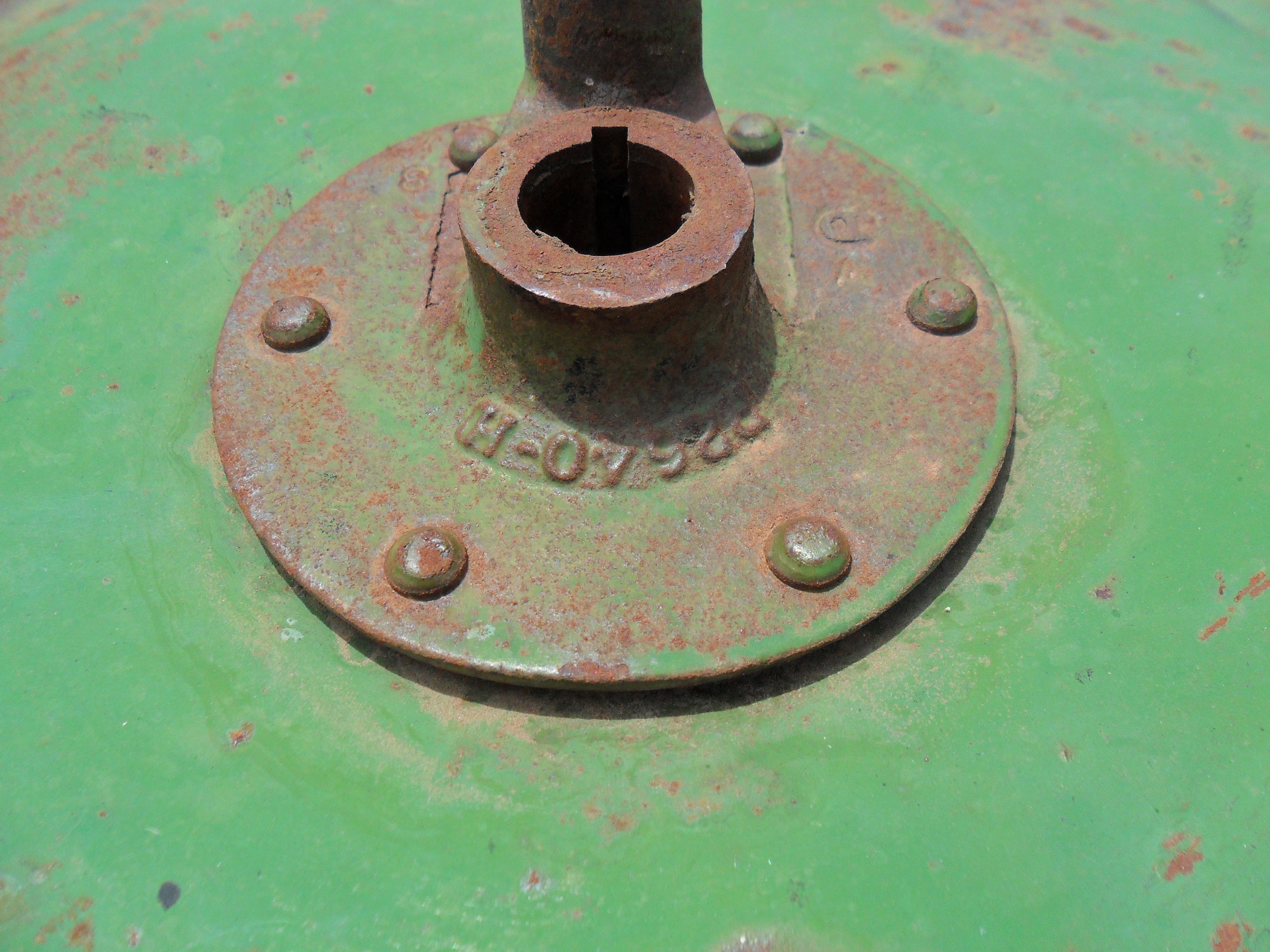

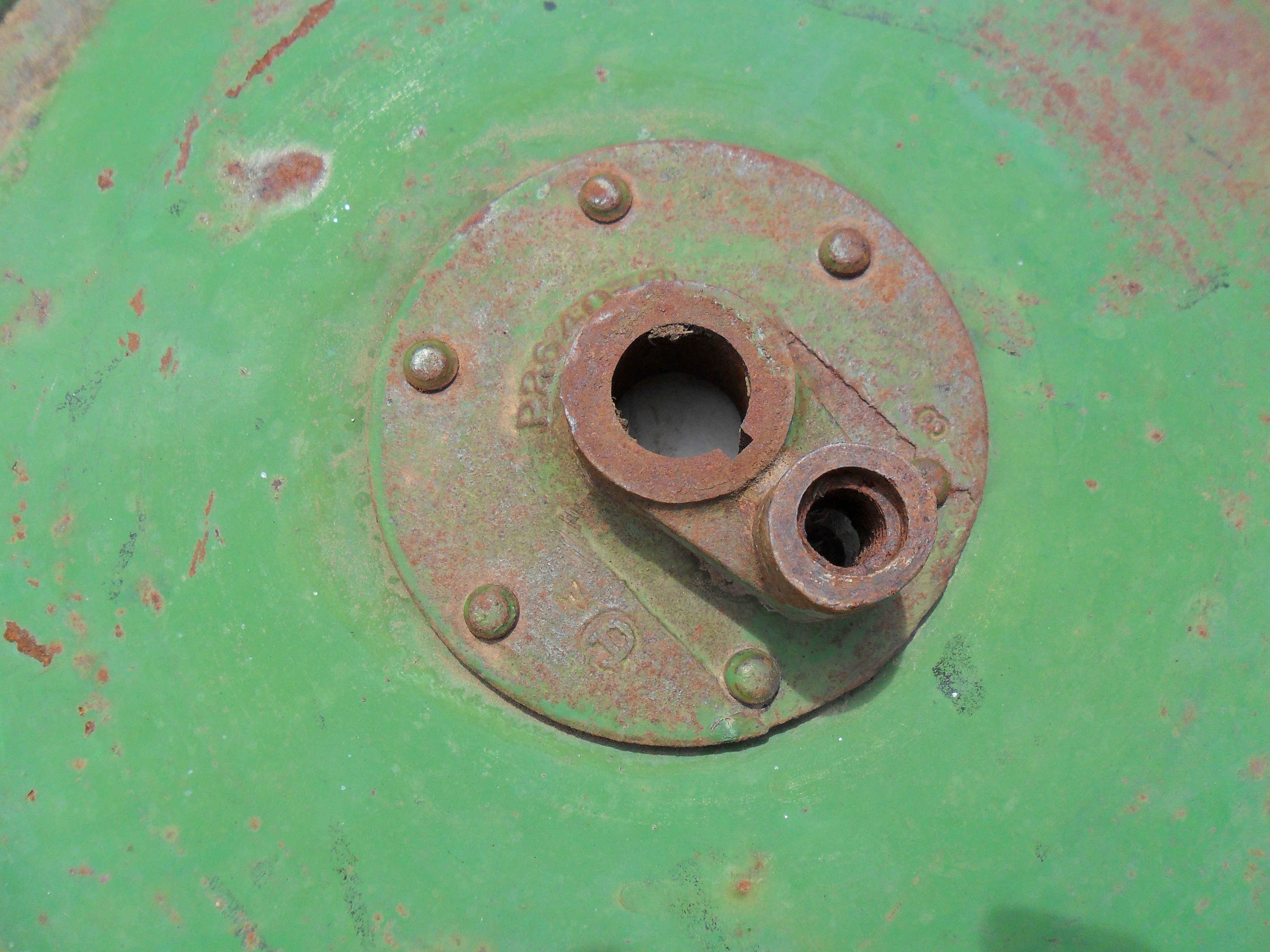

This steel pulley is about 13" in diameter and has a keyed center hole about 1/2", and an offset piece with a threaded hole. I was thinking that might be for either a handle or a rod, or perhaps a cam? It has a part number molded into it, P2640-H and a "D" stamped into it. I thought, because of the green color, that it might be a John Deere part but I have done all kinds of searches and can't find it online.

   / Pulley identification #2
I'm not familiar with JD but it might possibly be off a sickle bar mower...?

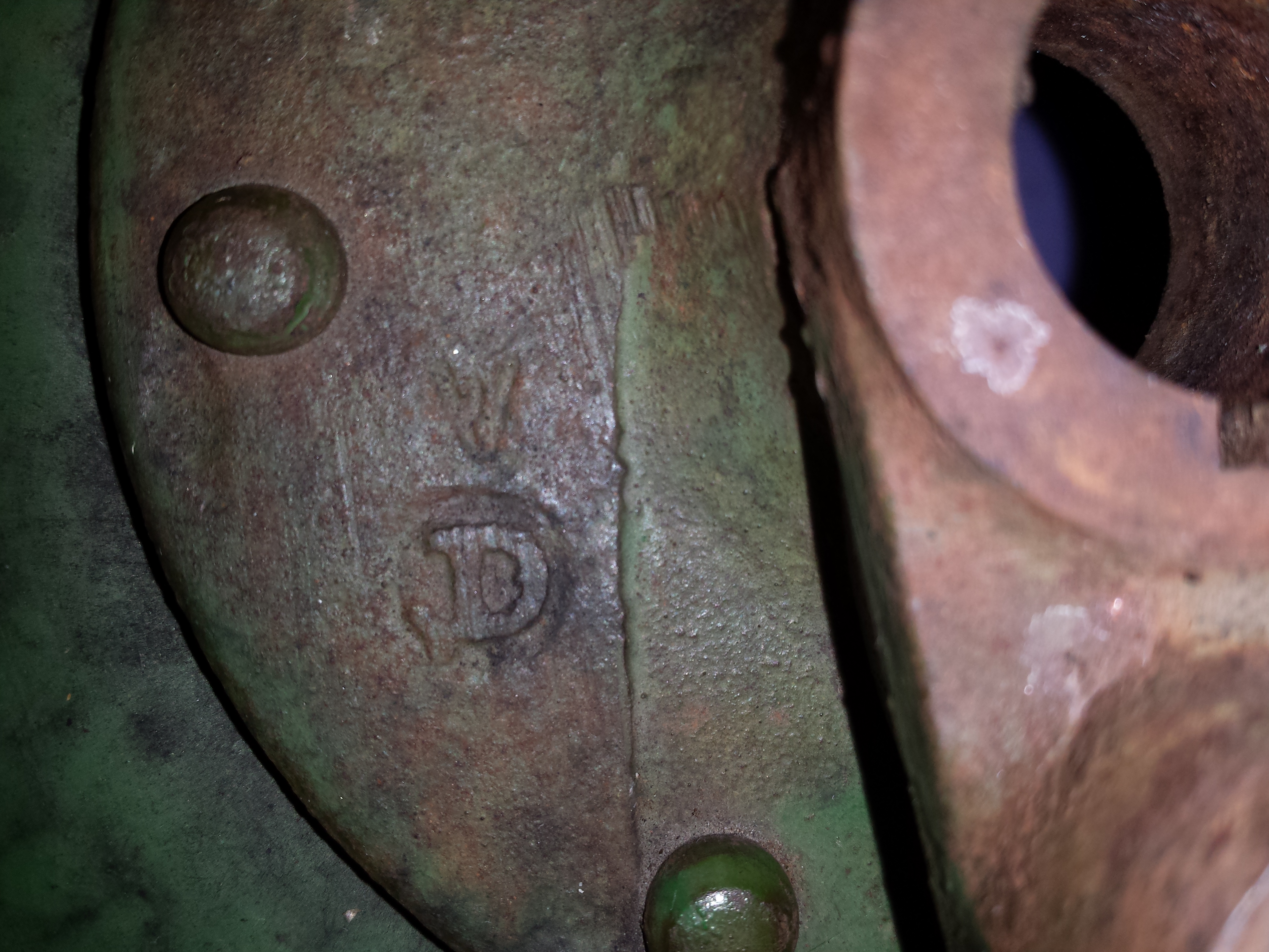

that D is a J and a D combined and is a John Deere trade mark,
it is or fits, a John deere 12A combine the P2640 is the hub, and is the straw rack pitman crank Hub, the pulley is a AP 11847H and was used on 1940 and up 12A combines, (possibly could have been used on some thing else, but it was used on the 12A.
http://jdpc.deere.com/jdpc/JDPC/attachments.jsp?associatedPc=PC0356.pdf
PDF page 90, parts book section 40-4
The JD trade mark is easier to see rightside up.
