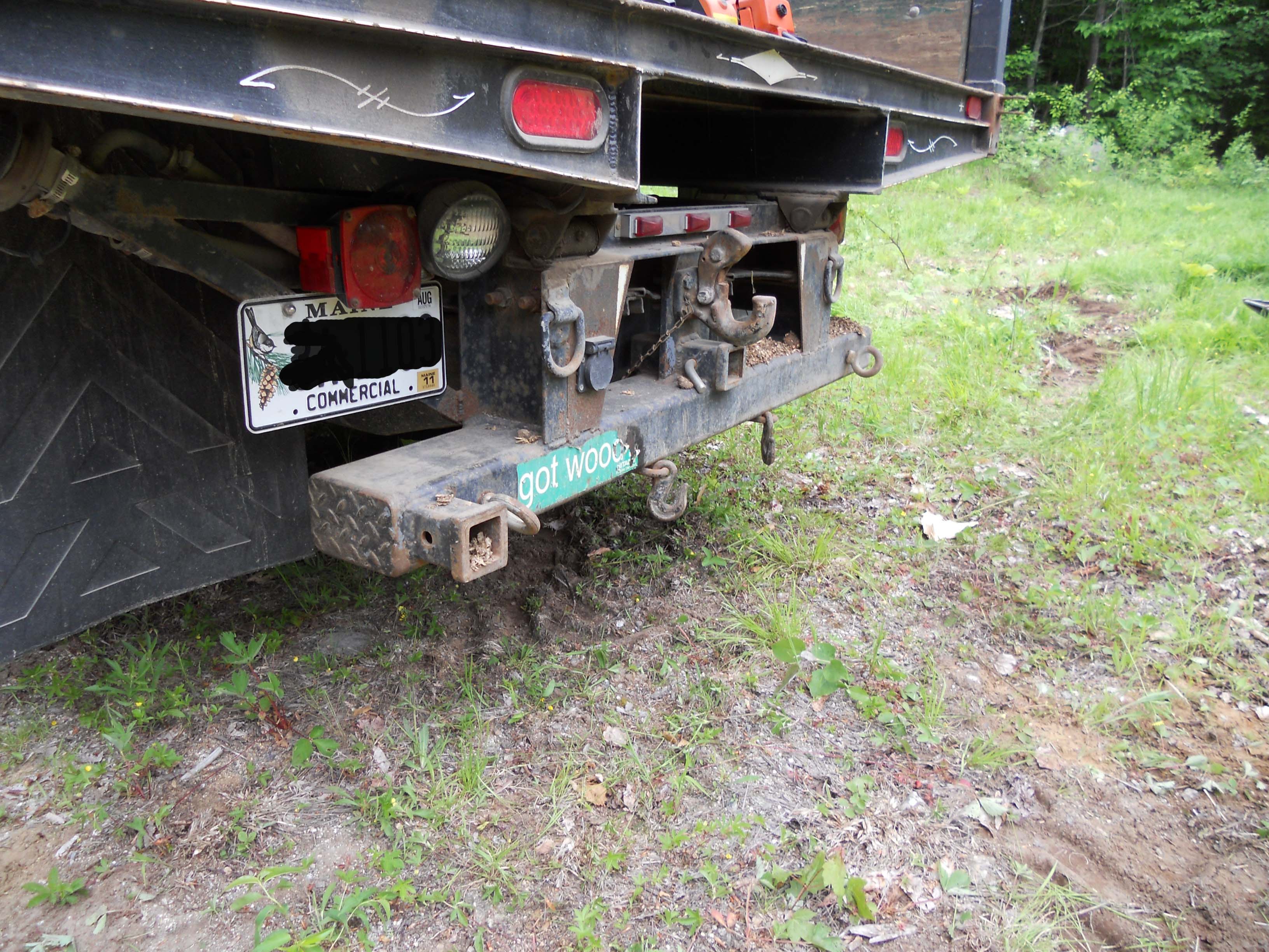

When I built this bumper I made an off center receiver hitch just for a haybine.
