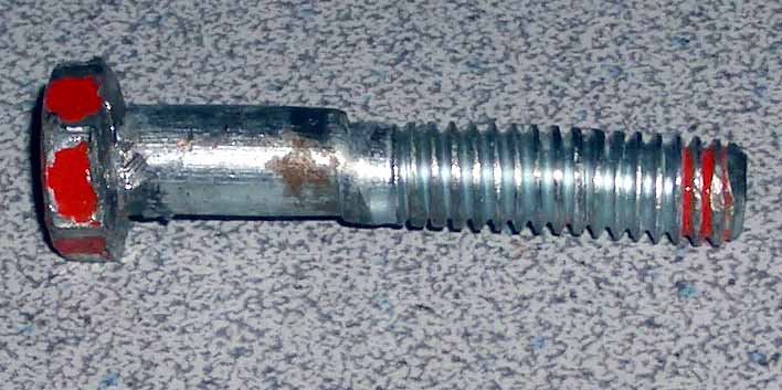

In the Kubota forum I let everybody know my Kubota front mount snowblower had a factory installed Grade 5 5/16 x 2" bolt as a shear pin. As a result, when I hit 2 rocks on 2 occasions the 60H drive chain broke instead of the shear pin.
Removing a sheared bolt is pretty easy: usually they just fall out. If a bolt is bent or soft or shifted, it is a much greater challenge because the bolt is effectively thicker than the hole its in.

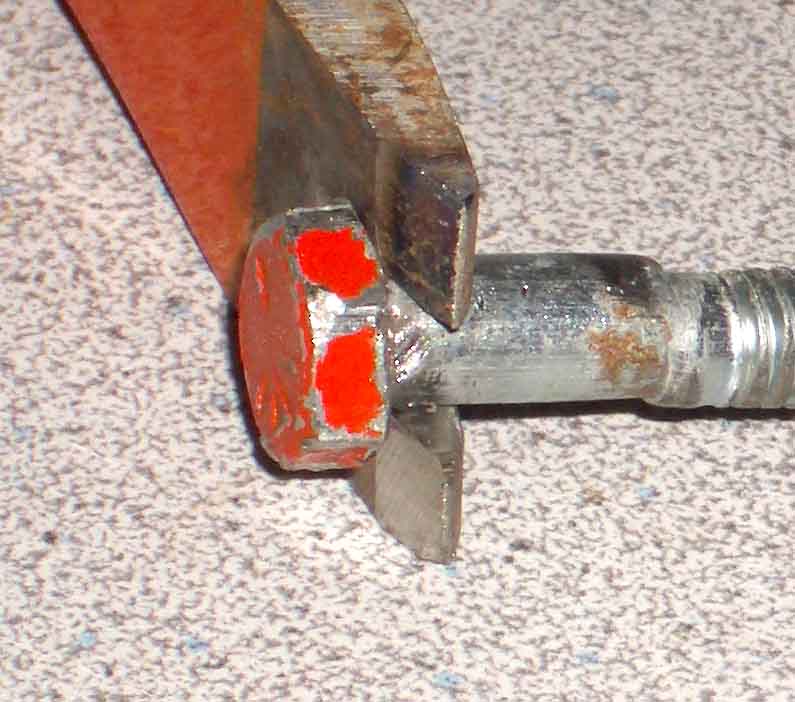

As luck would have it, a lot of shear bolts can't be driven out with a pin punch because you can't get at it. Such was the case with my blower. So after a lot of thinking (and much more swearing) I got an idea: I took a 1" cheapy cold chisel and ground a slot in it.

Placing this on the head of the bolt and whacking it a few times and out she came! Anyway it works amazingly well. Maybe its a dumb idea, but I thought I'd share it.

yea there are simular tools sold out there, usualy called pickle forks, larger ones are sold for doing ball joints in cars and smaller sizes are available from different places, i have a set that goes from about 1/4 slot to 1 inch or so at work
