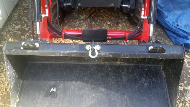

Not sure why you would be working under the FEL.... I don't trust the hydraulics no matter how good they are.... Wrap chain around base of bush, THEN bring tractor in close THEN attach chain to FEL (with FEL on ground) then lift..... Have hooks on FEL bucket for just that purpose....
IF pulling from rear, connect chain to "drawbar" below axle height.....
