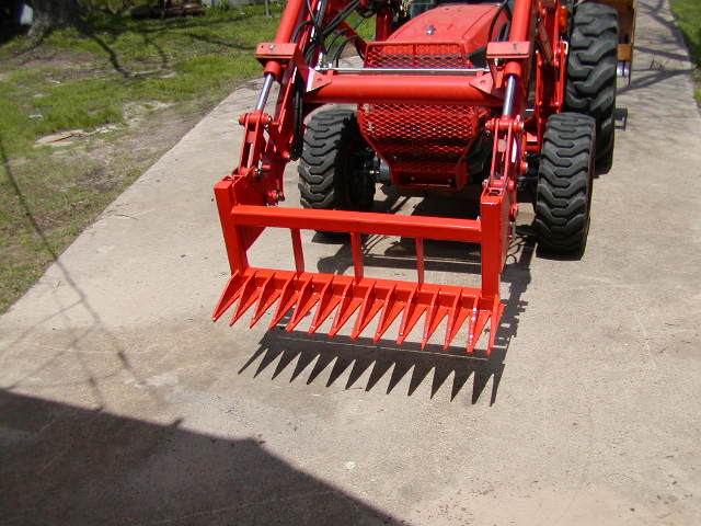

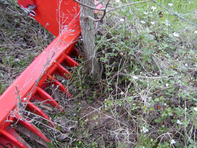

I like WHarv's ring on top of bucket for removing clean post to save.
If you have old fence & post to discard, or are grown up badly, I like how I cleaned up over a mile of fence row this year.
I cut the fence with bolt cutters about every 100/150', then used my treegetter to pull the post/brush out by the roots while pushing, wire/post/brush to small pile near the center of the wire cuts. Later would come back with forks & load on dump truck or trailer to haul off.
One man can do this without getting off the tractor except to cut the wire.

better view of the treegetter
