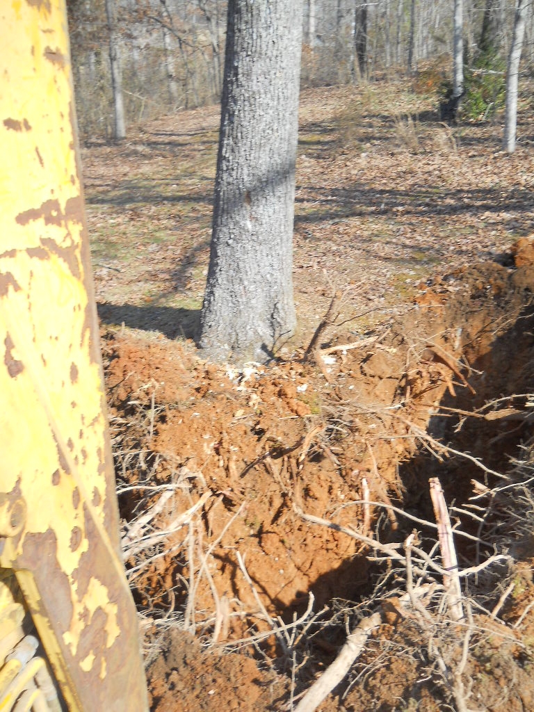

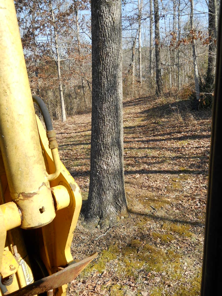

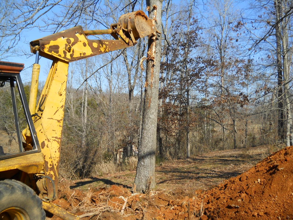

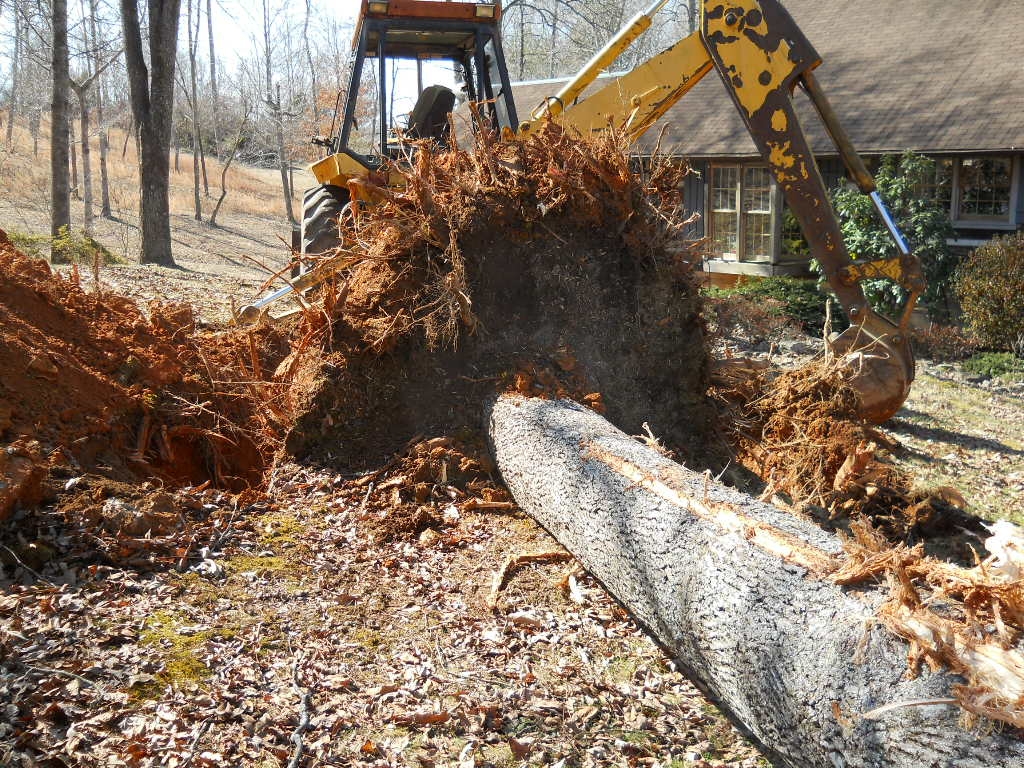

Not a very fair comment to follow.... do you have a backhoe on it?
Could you dig up around the roots with the loader?
If it looks reasonably safe, I've taken to digging up the rootball on the side I'm on as I'm wanting tree to fall away from me.
Cut a "V" and the top of the "V" is untouched dirt so a bit of a hinge that will hold tree as I push it over. Gravity takes over and pops root ball out.
*not saying this is safe.... but I've done it a number of times and 'so far', has worked exactly as planned. Also allows me to take the backhoe to help push in the direction I want it to go.
In this case, this was my wife's cousin next door and he feared the tree blowing over towards the house so simply wanted it down. I had the fun of dropping it and he got to clean it up!
Could you try similar things, with smaller trees?
