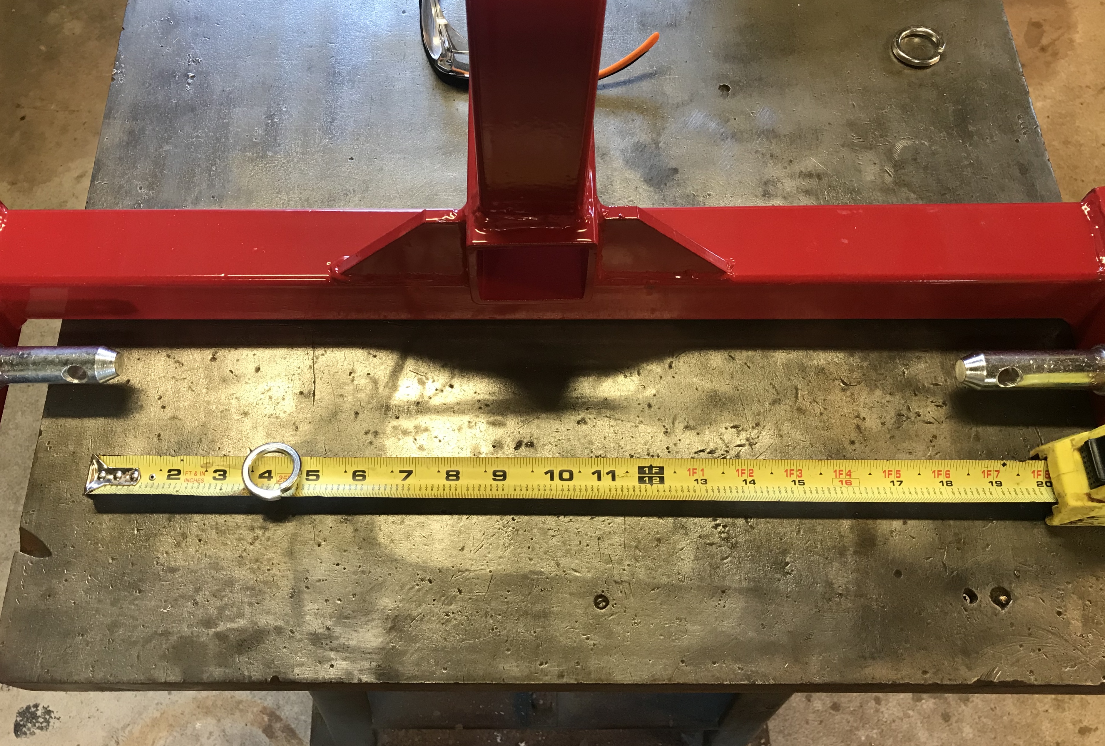

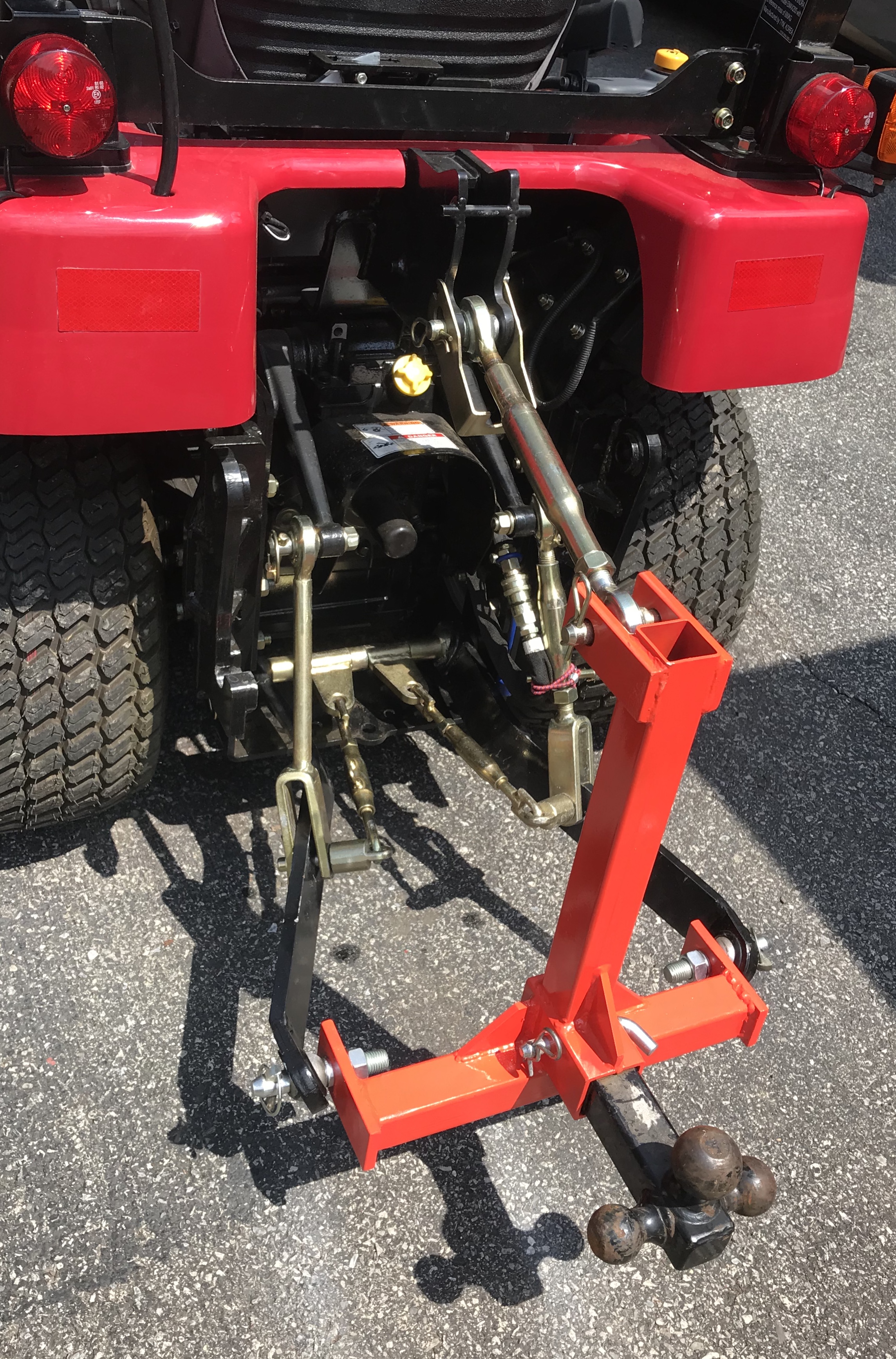

Have 4 trailers in my backyard and pulling them out/moving them around is a little tight with a tow vehicle so I've always used my Kubota for that. But, that's gone and though the Mahindra has the three point hitch, I couldn't find a three point receiver hitch at 19". And no, I can't go wider as the arms would run into the backhoe mounting bracket.

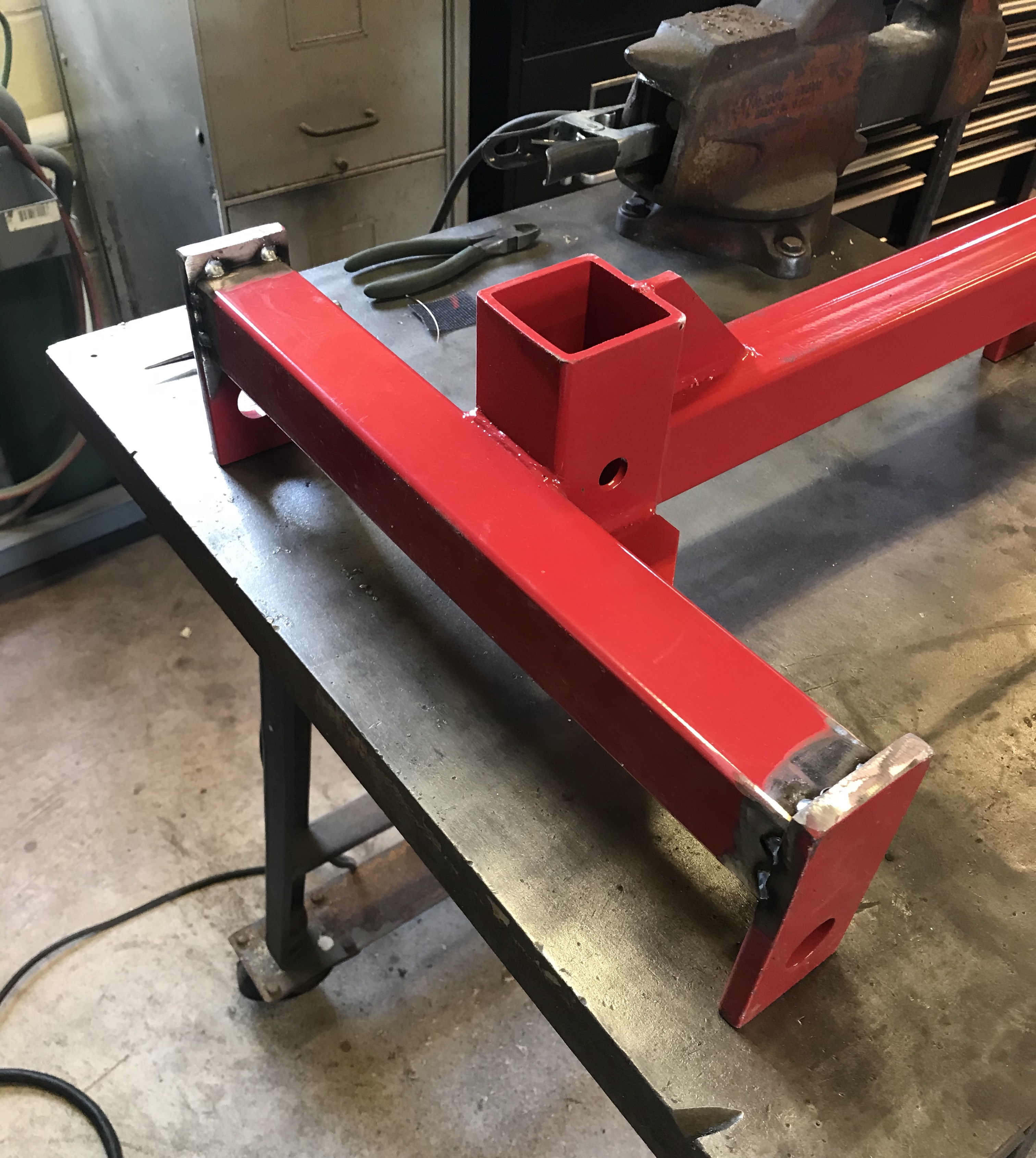

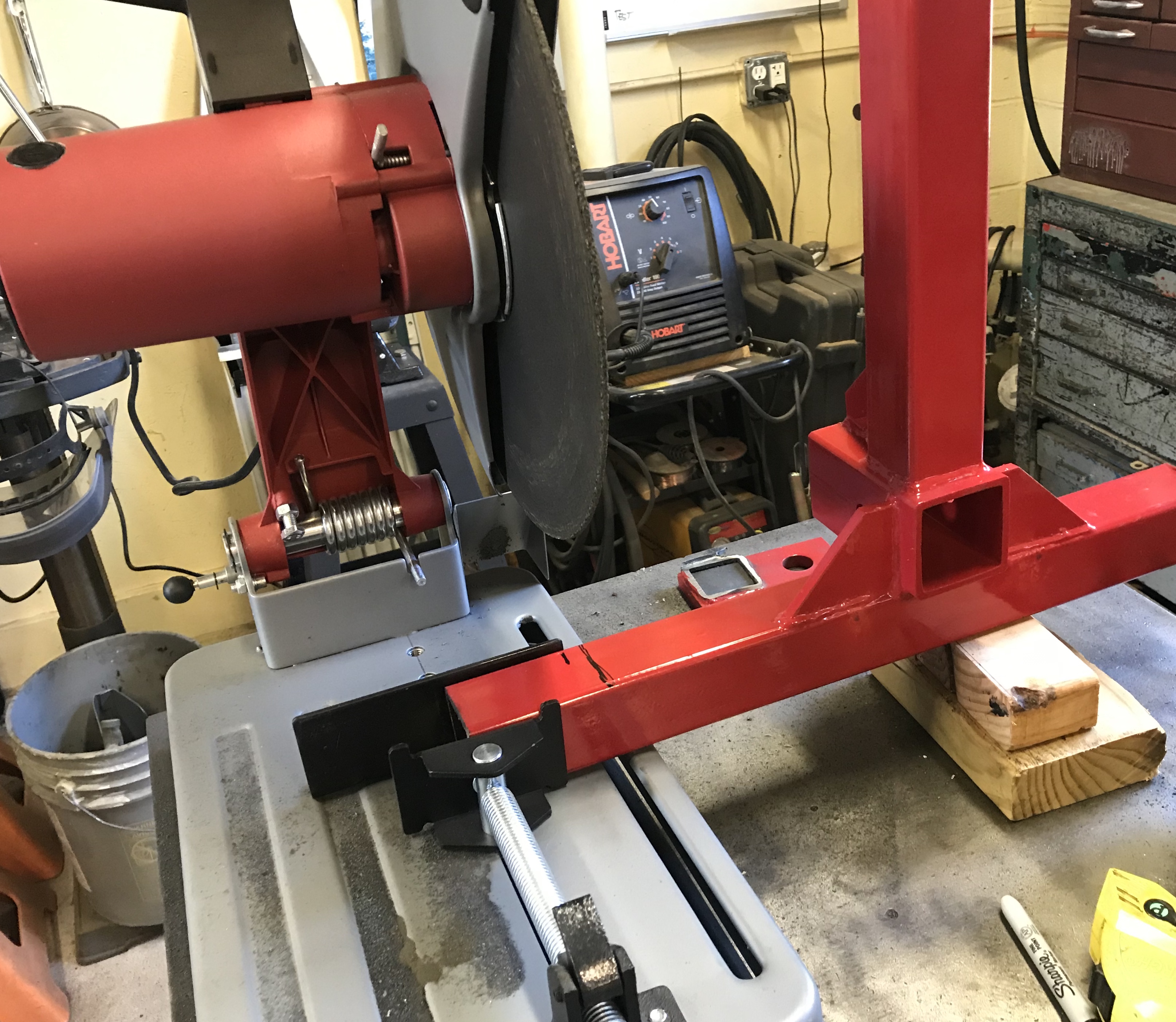

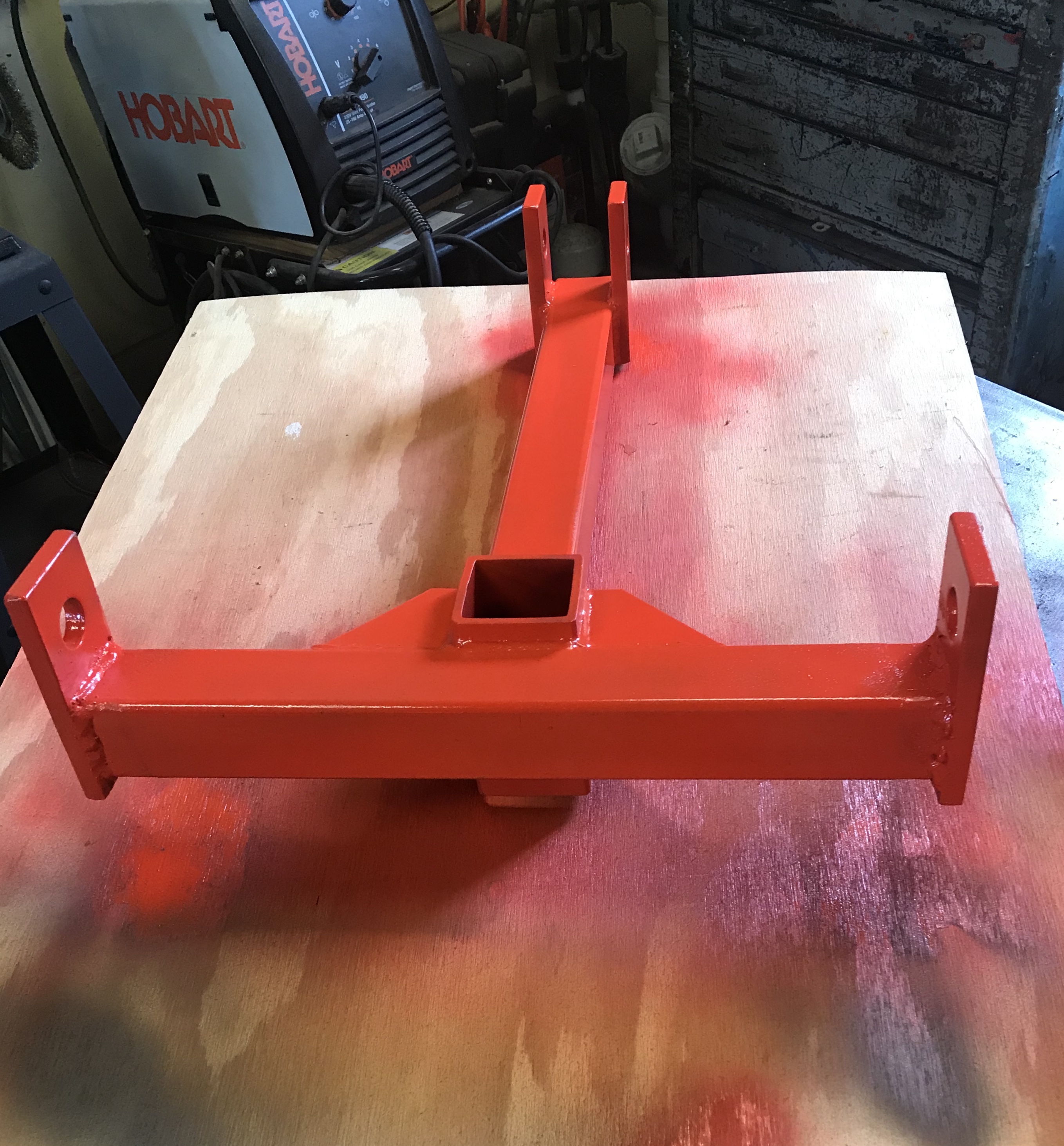

So I just got a regular cheapy class 1 receiver and made it fit. Pretty happy with the results.
(No I am not the world's greatest welder and I didn't take the time to grind them down.......)

Very nice. That should work well.

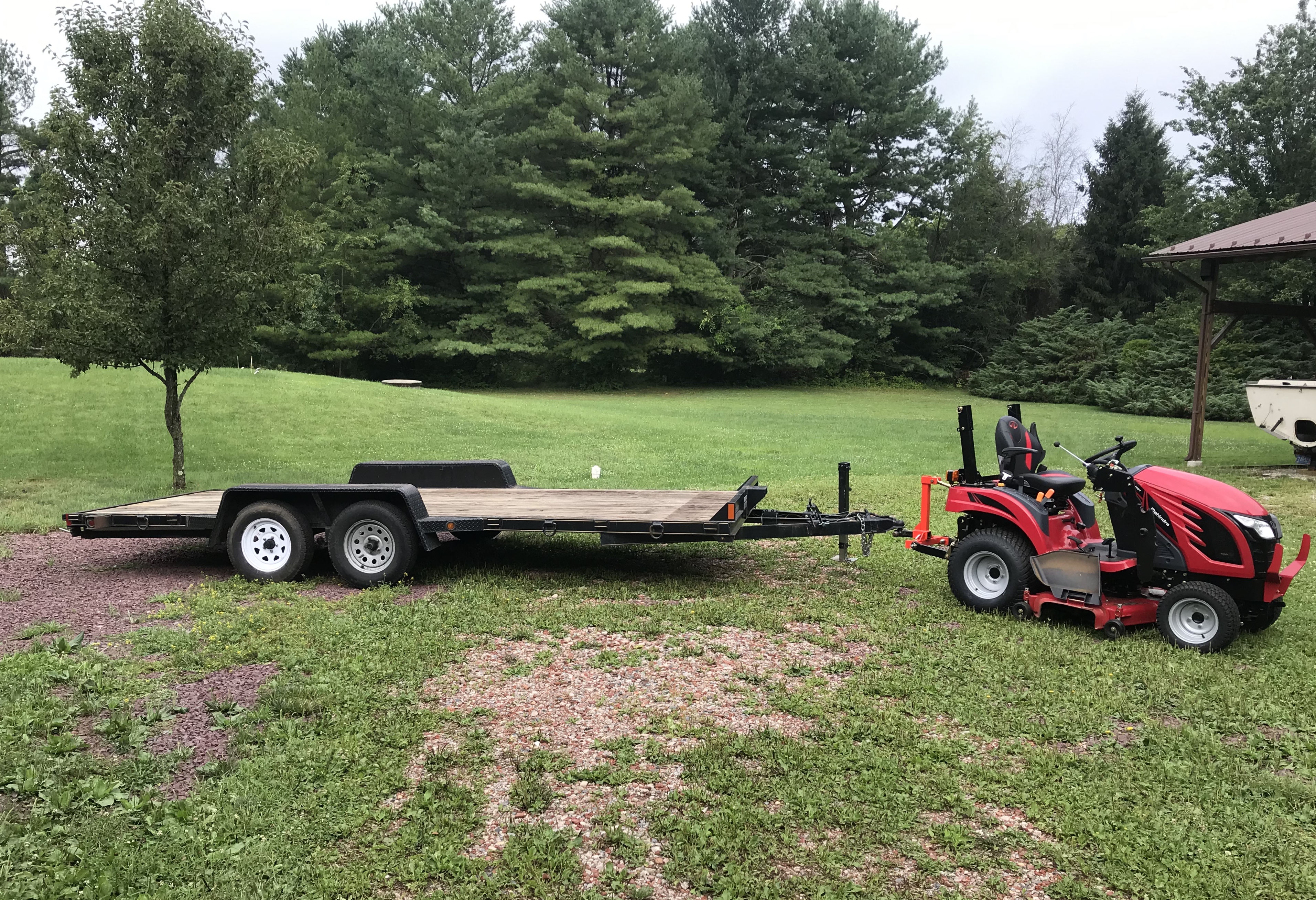

Ready to go around the yard and do some trimming!
