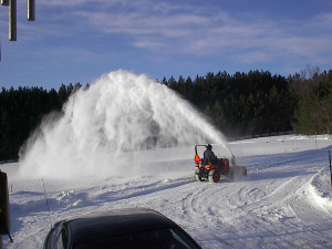

I just bought the kubota blower for my bx , I can't wait to see it in action. I also have the blade for mine, it'll push boat-load of snow, but when we get hammmered it's tough to find places to shove it. Plus my mom and dad are going to be moving and I'll do thier drive aqs well. Dose anyone have some good pics of the front blower in action, I'd love to see 'um. I hear that thing will throw snow about 100' /forums/images/graemlins/blush.gif.

I don't have any pics showing the snowblower in action but trust me, the blower will throw a "mile". Last winter I cleaned out our 300' plus gravel drive and didn't have to worry about any snow build up. The heavy stuff by the street was like no problem at all.

   / Puma 54" Snow Thrower and BX2200 #10
Re: Puma 54\" Snow Thrower and BX2200
here's a pic
