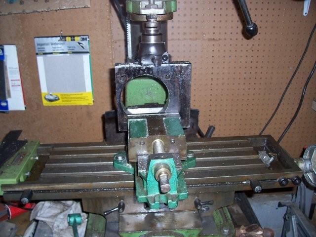

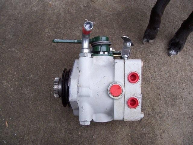

Can anyone tell me how to hook up the pump in the picture, it has 3 outlets and looks like a vent. I started making the mounting brackets for the motor with 1/2" plate, welded together, drilled and bored a 4 1/2 hole.

This is the hydrostatic drive from a Ryan DGA 30-06 riding aerator, it consist of left and right 540075 wheel motors and a 547906 variable displacement hydrostat pump.
Pump:
Sauer Sundstrand
.91 Cubic Inch Variable Displacement
CCW
A-93-15-42961
15-2196
Motors:
Parker (Nichols Motor Division)
16.4 Cubic Inch Displacement
(RH motor)114A-189-YS-0-05 F2 54
(LH motor)114A-189-YS-0-05 F2 55

top left hose barb is suction from reservoir(this pump has built in charge pump under front cover) make sure rotation is correct (it can be changed), two ports on far right (end cover)are pressure ports going to hyd motor and remaining port on case housing is case drain returning back to reservoir tank unrestricted.
