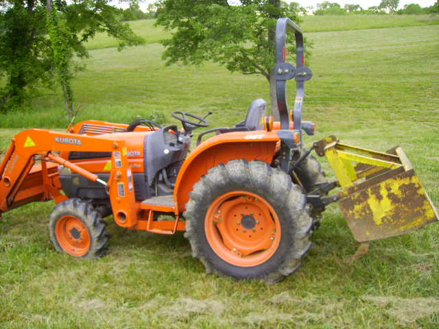

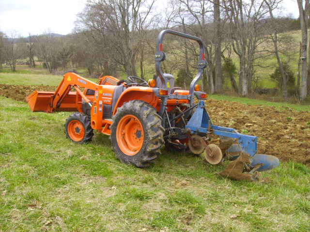

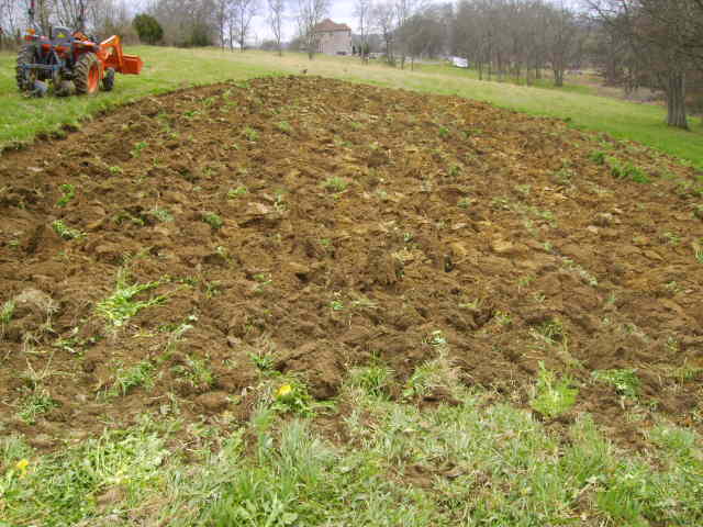

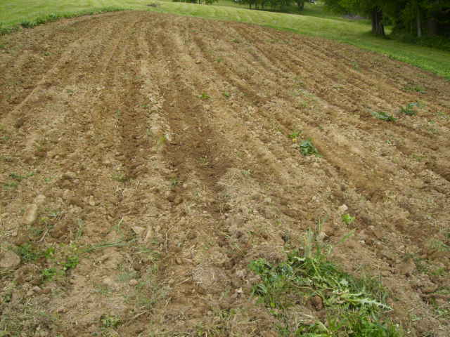

I am in the process of working on a small pumpkin patch, about .15 acre. I plowed and disked the area a month or so ago. I used a two bottom Ford 101 plow. Today I plowed it again with the scarifiers on my box blade. I want to keep the soil loose and weeds out until I plant in early to mid June.
I will spray Command for pre emergent weed control. Also I plan to spray something (any suggestions?) for insect control once the plants come up.
I saved seeds from a pumpkin last fall to plant. I probably would have bought seeds, but I know someone who did it this way last year, and it worked surprisingly well. If this is successful, I plan on inviting members of my Sunday School class to my place in the fall. My class members are all in an age range to have grandkids, so I want them to bring as many kids as possible to get the pumpkins to take home for holloween.
This will be a new experience for me. Any suggestions or helpful hints from you pumpkin experts will be appreciated. The first two pics are the day of using the turning plow. The last two are today when I used the box as a plow.
If there appears to be any interest in this thread, I will update it periodically as things progress.
