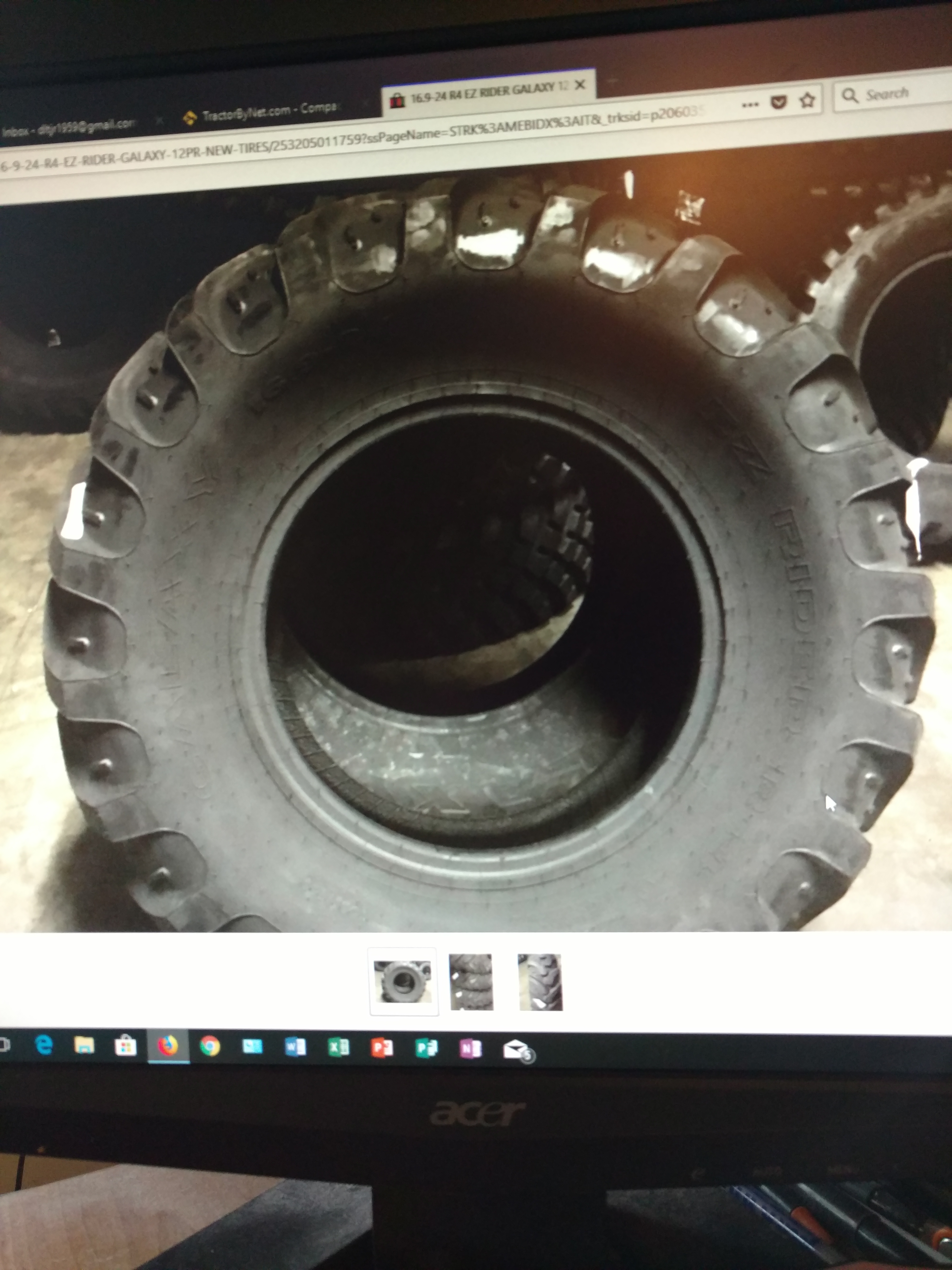

The rear tires on my 4610 have seen better days. I use the tractor for brush hogging and have multiple plugs in both rears. The tread is actually not that bad and they are not too dry rotted but I have developed a bad leak in one of the stems. They are tubeless and I need to stay tubeless so that I can plug and go when needed.
Couple years ago I upgraded the fronts to 18 ply aircraft tires from Gensco and have yet to puncture one. Bit the bullet and purchased tires and rims. Finding 16.9x24 rears were much more difficult. Most AG tread come with tubes and are typically 6 ply. Not good for hogging.
I ended up getting a set of R4 industrial 12 plys off E-bay and had them shipped to a terminal in Conover. Got to get them mounted but was exceptionally pleased with the price.
